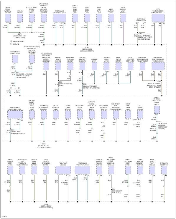

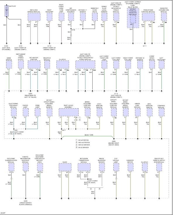

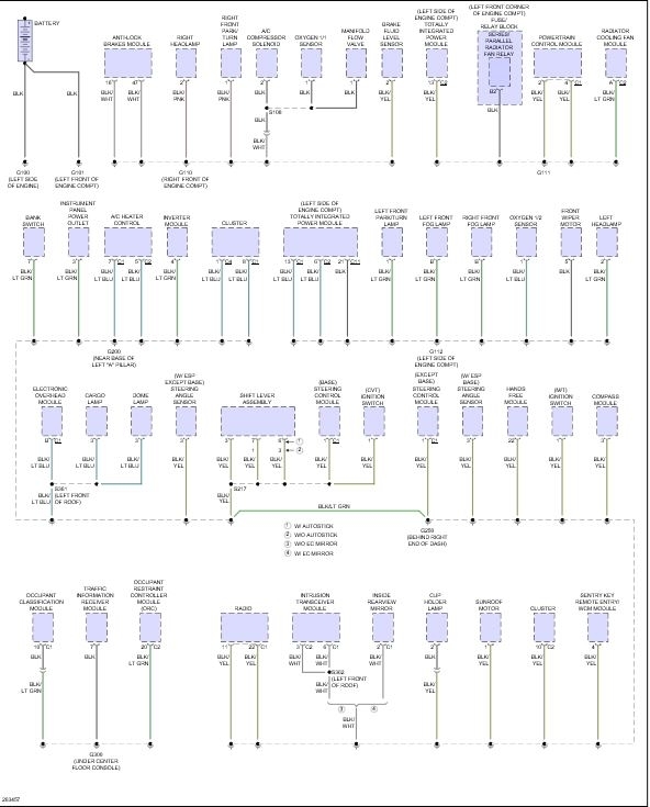

Ground wiring.

I assume you wanted the ground wiring diagram.

Thank you. c100 ground wire.
