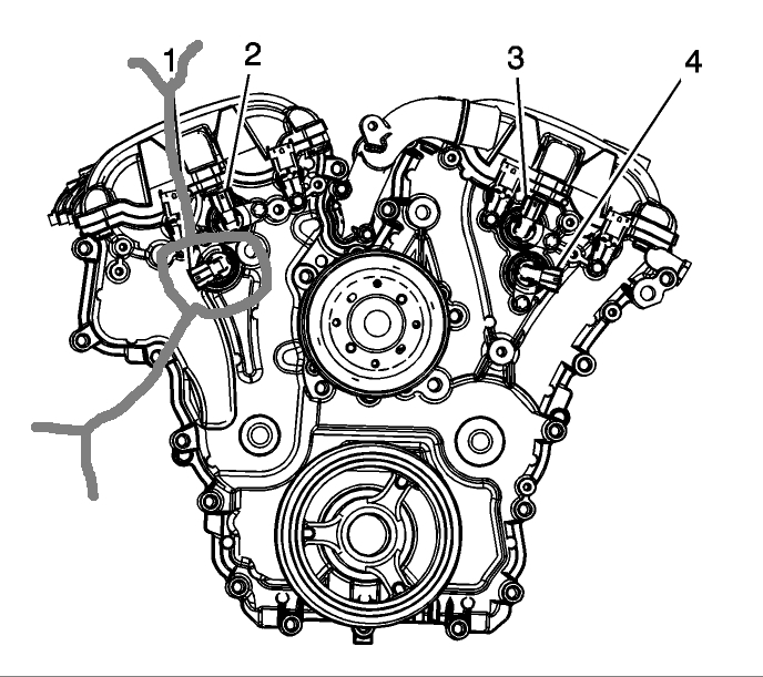

The 11 code is the intake cam sensor.
the fact that there are cam sensor codes, verify there is 5 volts to the sensor connectors. if there is, check the connectors. if they are good, it is possible the sensors are bad but the possibility of a timing issue is strong between the cams and the crank
