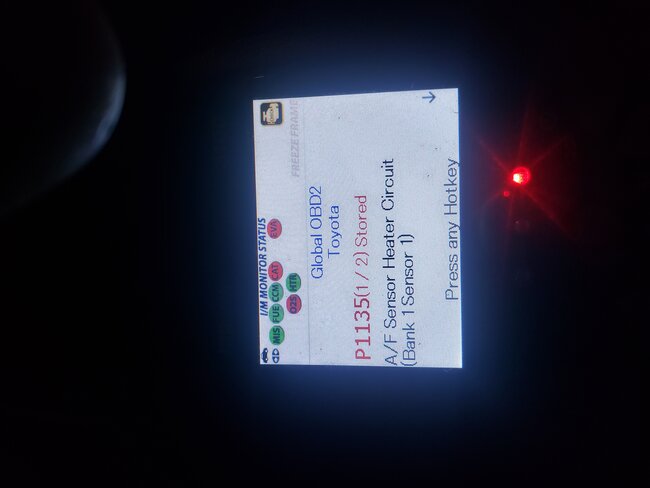

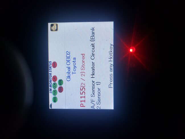

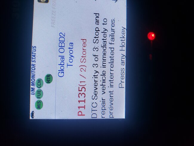

I know these are O2 sensors. Are they the same part in two different locations along the exhaust? I provided images of the obdII readouts.

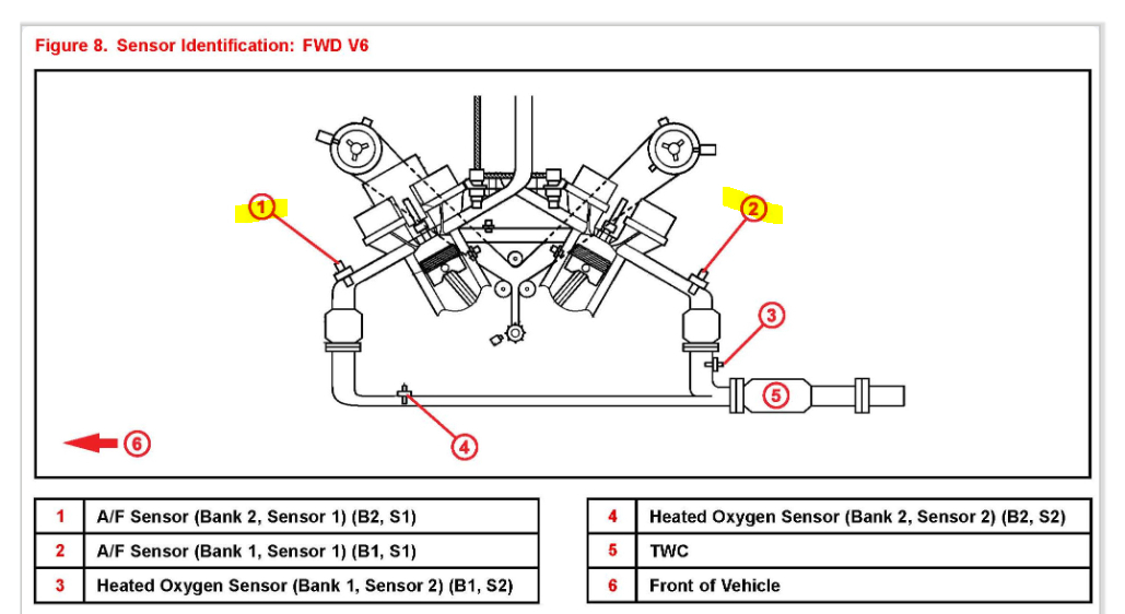

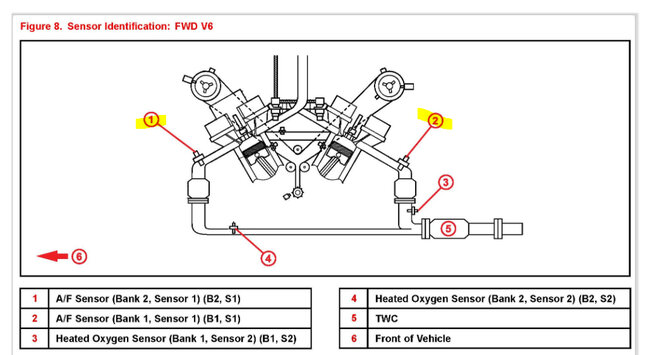

The codes you have for sensor 1 on both banks (1 and 2). See pic 1 below for locations.

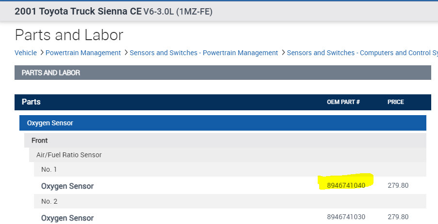

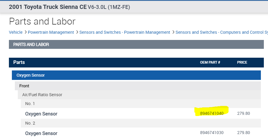

According to the part numbers, they are both air/fuel mixture sensors, and they have the same part number. See pic 2.
See pics below.

Yes, very helpful. Thank you, Joe. I hadn't really thought of the engine as it is depicted in that diagram either.

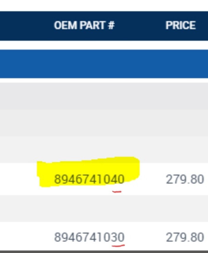

Just noticed that the part numbers are almost identical. I'm not sure if this is an important observation, or if I understand what I am seeing.
In the image, I've underlined the discrepancy in red.

I'm guessing that if there is a difference, it would be in the length of the connector lead and possibly to the connector head itself.
Mar 9, 2023 at 12:32 AM
