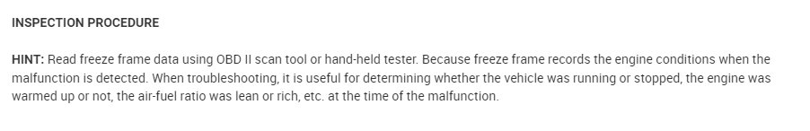

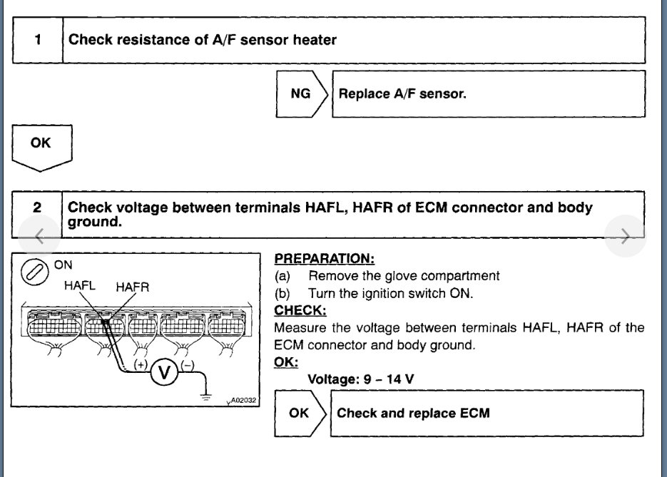

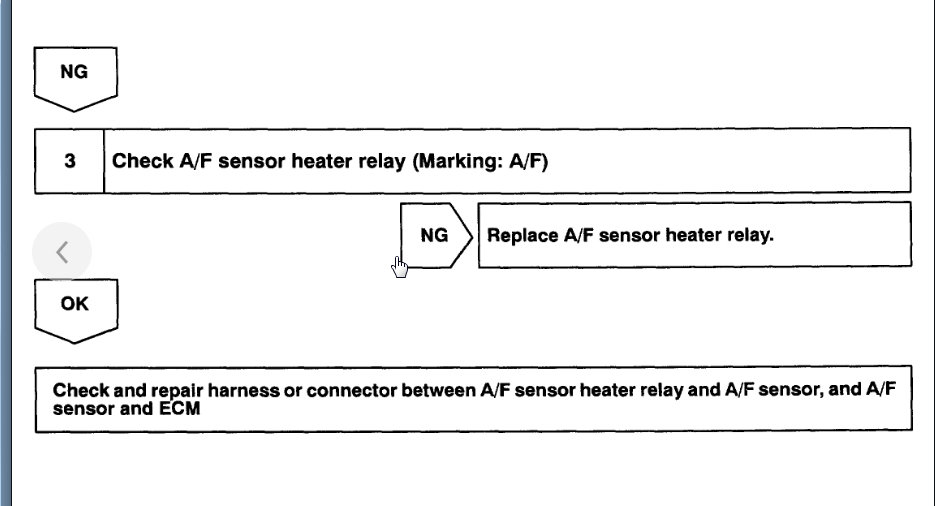

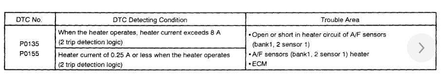

I attached the diagnostic info. I suspect you have a wiring issue. However, the fact that you have both codes, it may be an issue with the ECM itself. Running through this information will identify which one it is.
Let me know if you have questions and I will help answer them for you. Thanks
