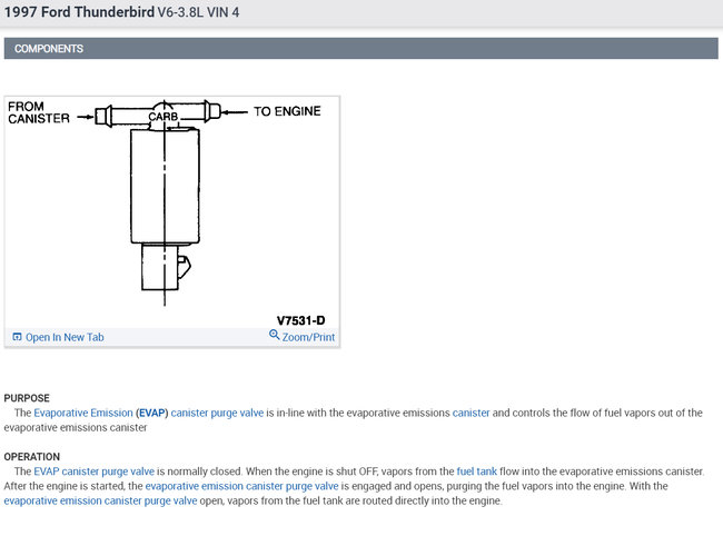

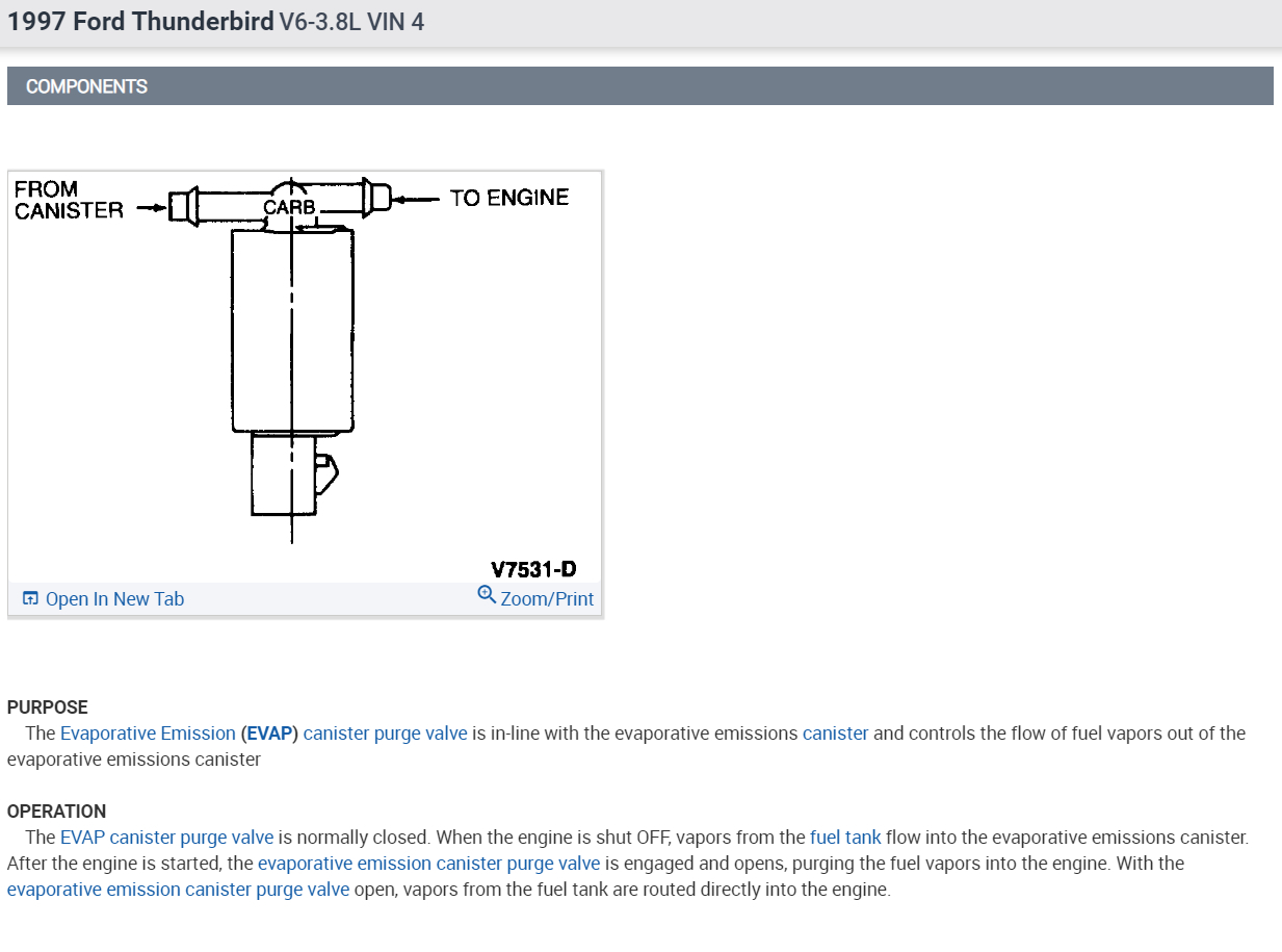

This means your EVAP purge valve solenoid valve is not working here is the location so you can check the valve and see if the vacuum and supply lines look okay without tears or holes, this can cause codes as well. It is under the hood and looks like this. Check out the diagrams (below). Please let us know what happens.
