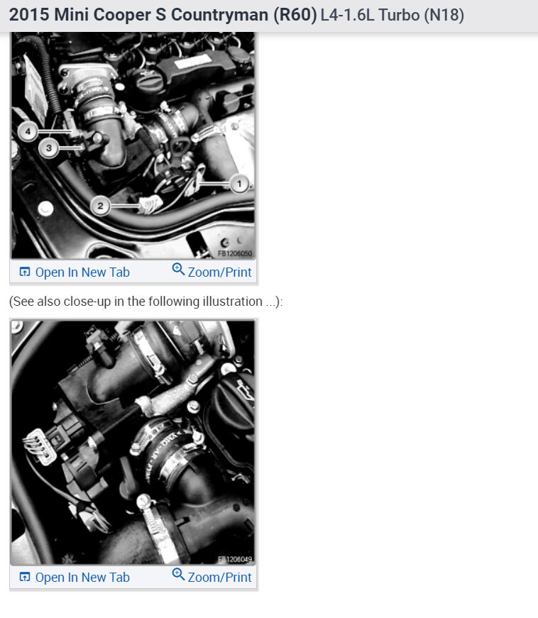

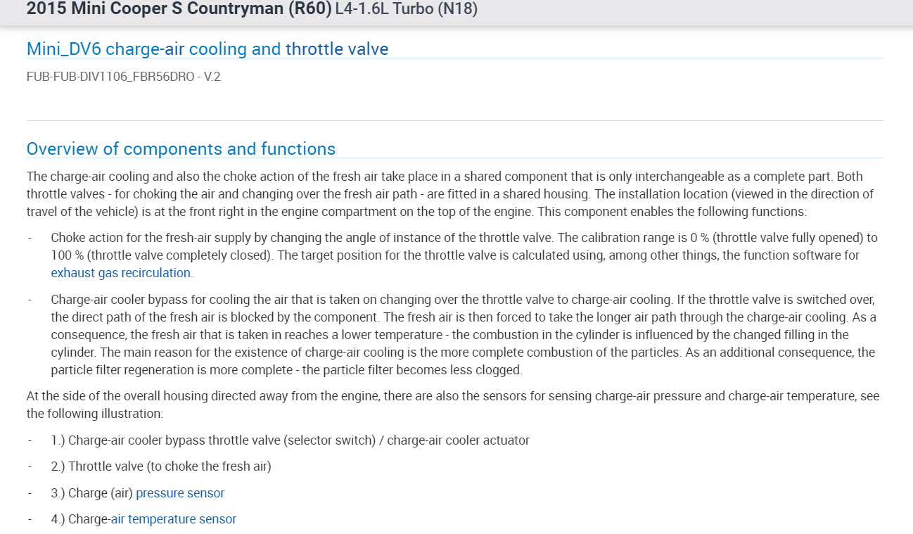

This is common when the throttle body need to be serviced. here is a guide that can help and instructions in the images below to show you how on your car:
P1588 - Throttle Control Malfunction:
P1589 - Throttle Control Adaptation Not Started:
Check out the images (below). Please let us know how it goes
