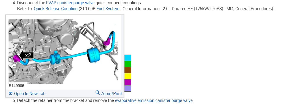

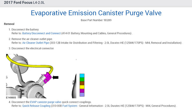

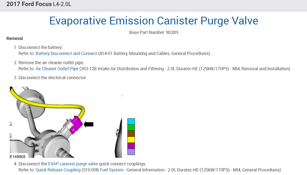

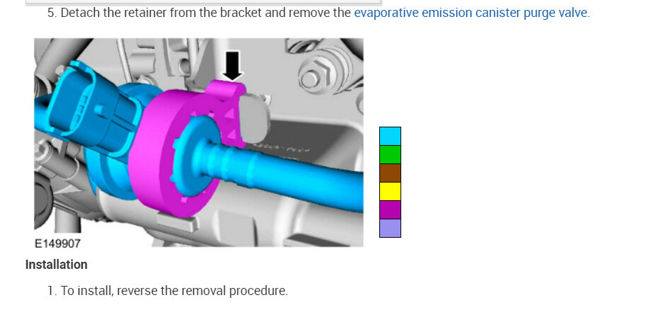

So, it looks like you have an EVAP purge valve that is not working. Here is the location so you can check it out. Check out the images (below). Please let us know what happens.
