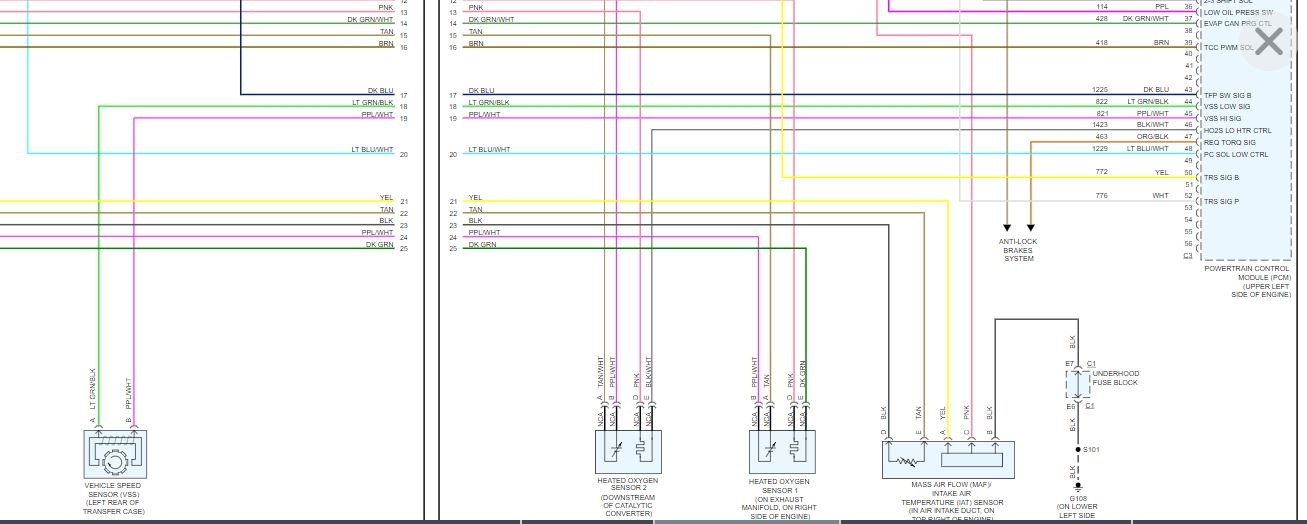

Below are the possibilities for the code. In most cases, it is the sensor.
P0135
Descriptor
Probable Causes
Diagnose Other DTCs First
Heated Oxygen Sensor (HO2S) Heater Low Control Circuit Open
Heated Oxygen Sensor (HO2S) Heater Low Control Circuit Short to Ground
Heated Oxygen Sensor (HO2S) Heater Low Control Circuit Short to Voltage
Heated Oxygen Sensor (HO2S) Ignition 1 Voltage Circuit Short to Ground
Heated Oxygen Sensor (HO2S) Intermittent Condition or Poor Connection
Heated Oxygen Sensor 1 (HO2S)
Oxygen Sensor (O2S) Fuse
Powertrain Control Module (PCM)
Powertrain Control Module (PCM) Intermittent Condition or Poor Connection
