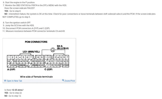

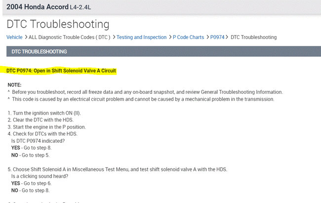

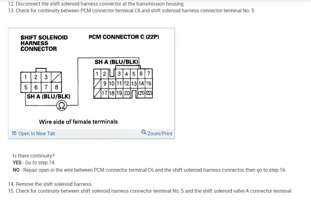

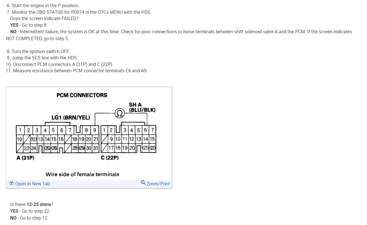

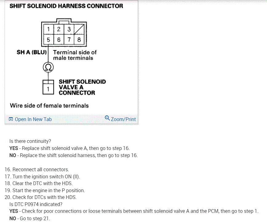

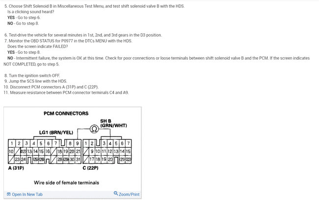

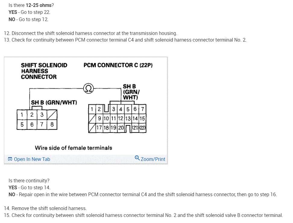

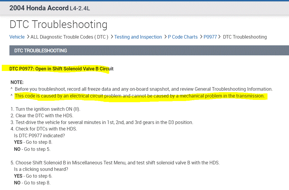

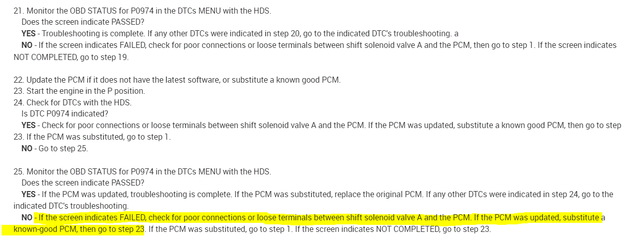

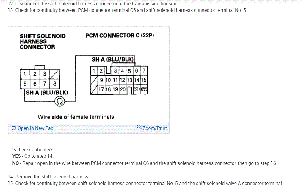

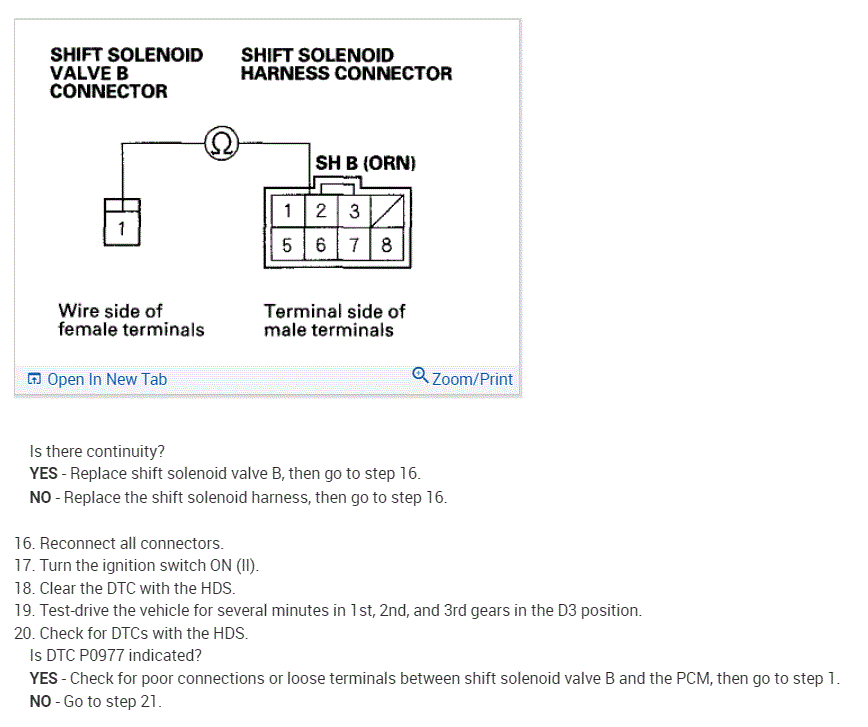

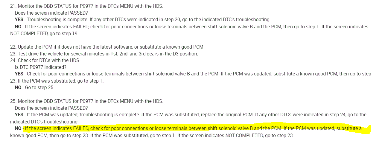

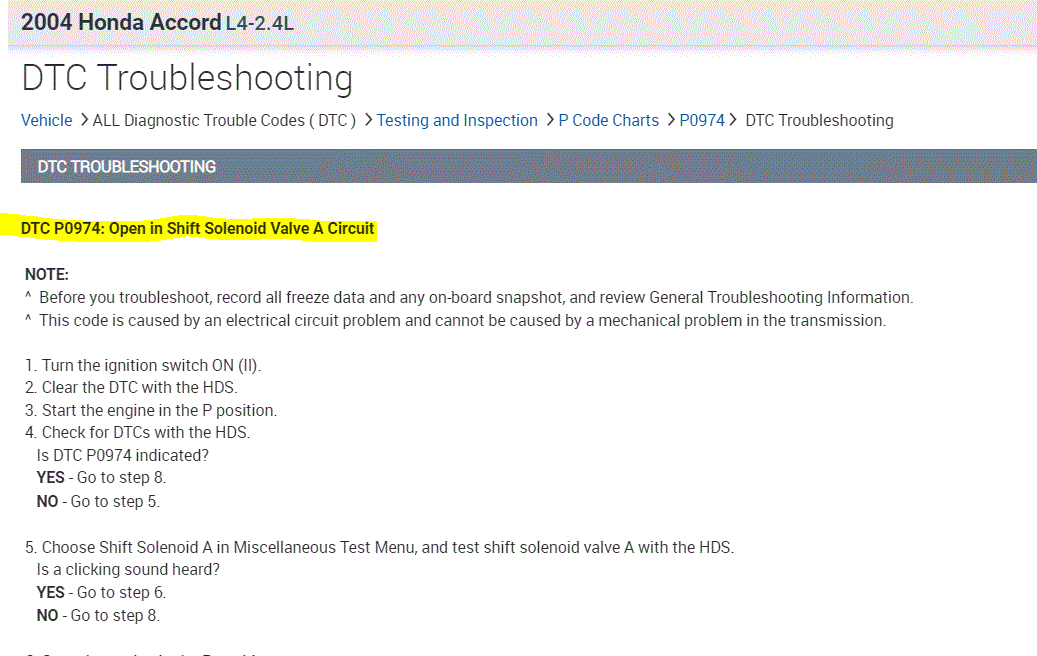

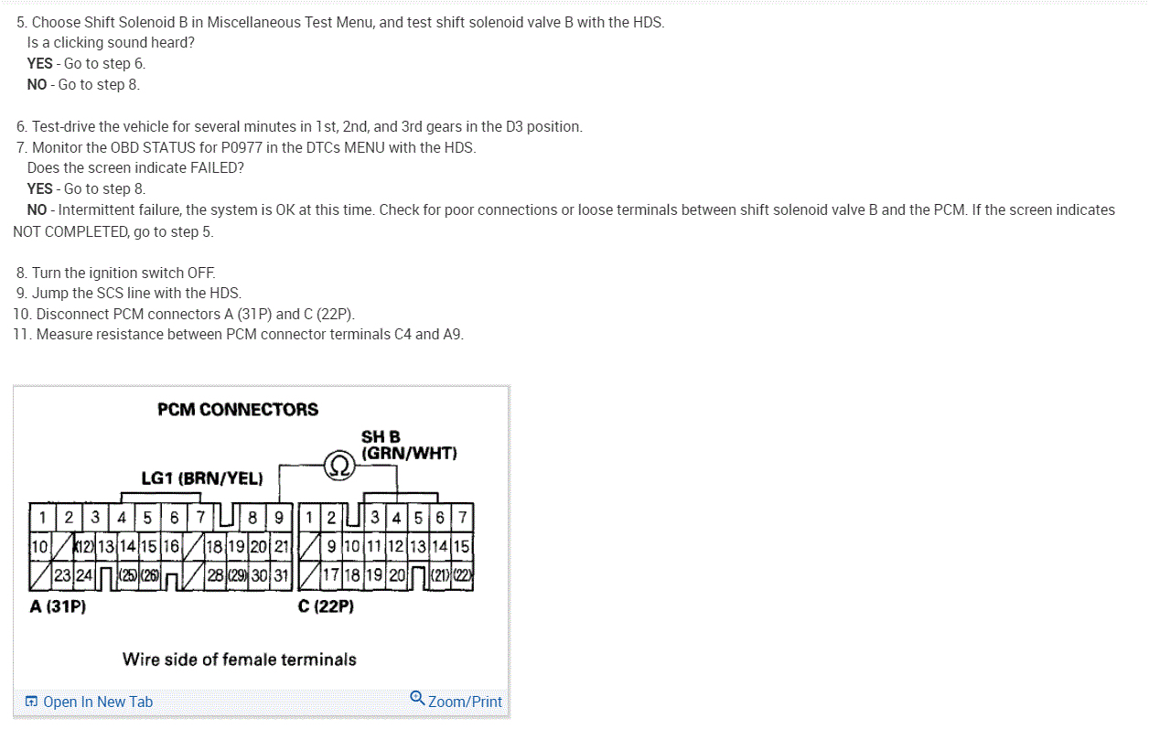

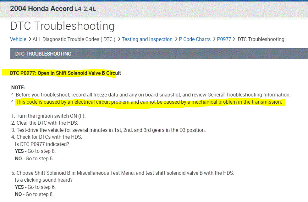

As far as the solenoids are concerned, I attached the diagnostics below. They start out the same as the 685 code, but if they fail, there are steps for testing to determine the cause. Ultimately, either there is an ECM issue or a wiring issue between the ECM and the shift solenoid circuits. It could be as simple as corrosion at the ECM connector or a broken wire between the two.
Take a look through the diagnostics below and let me know if it is something you feel comfortable doing. Wiring can be difficult to trace. However, on a good note, the codes seem like an electrical issue and nothing mechanical in the transmission.
See pics below.
