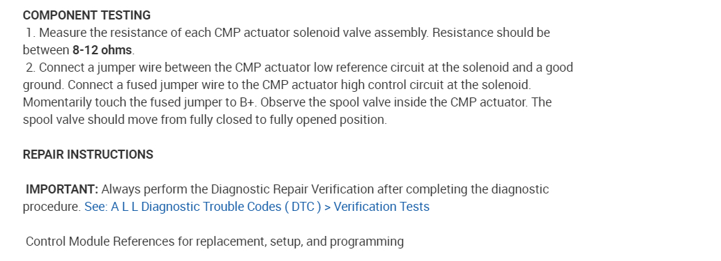

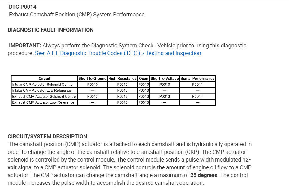

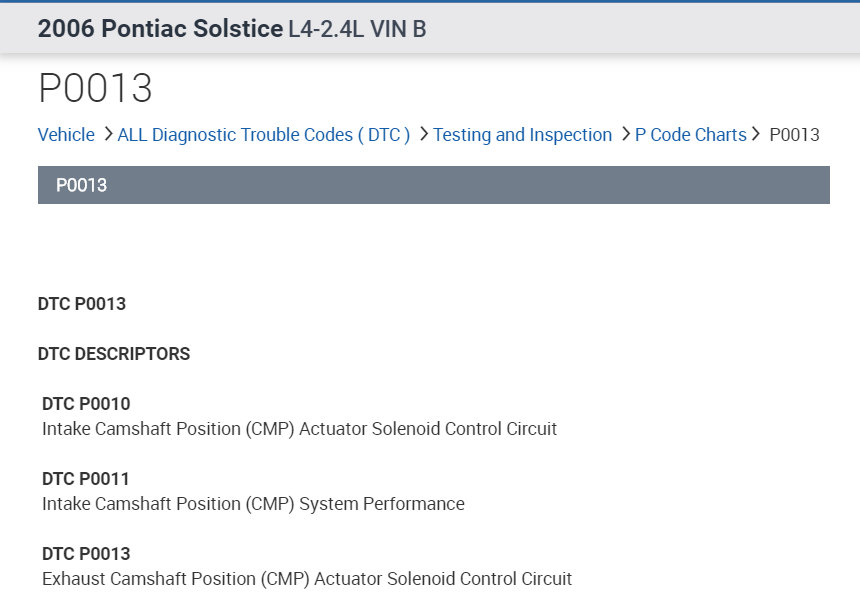

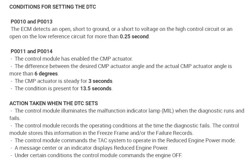

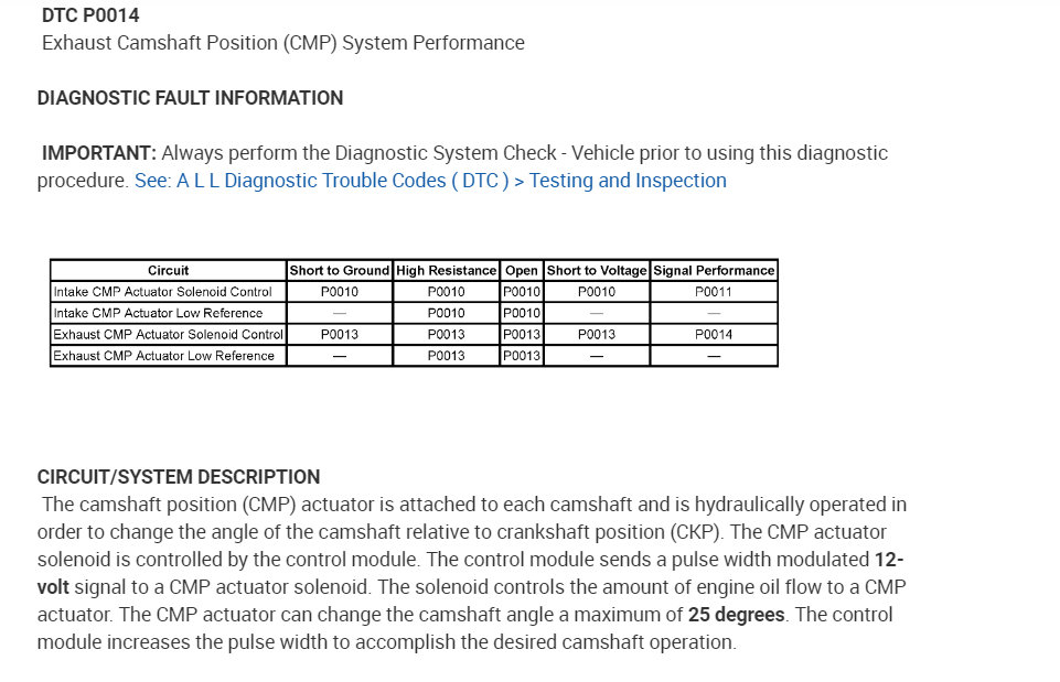

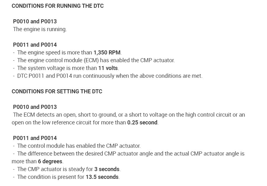

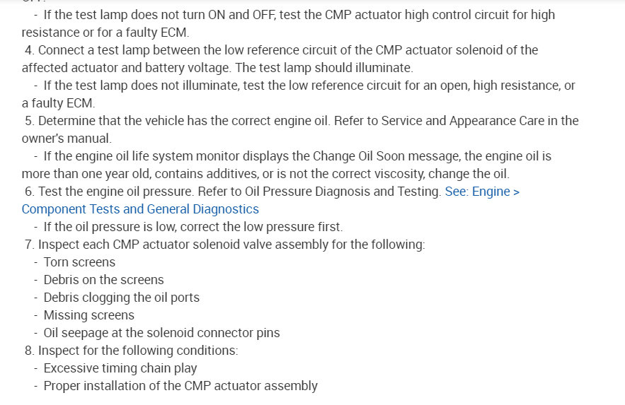

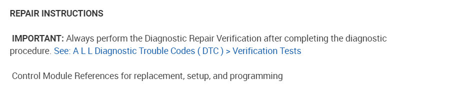

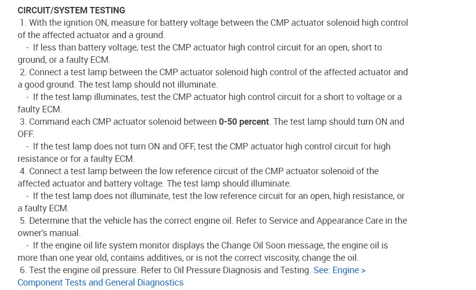

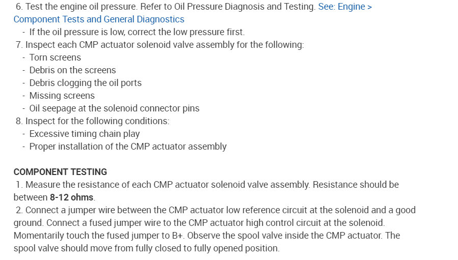

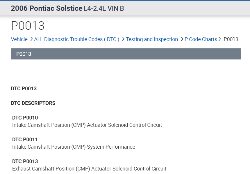

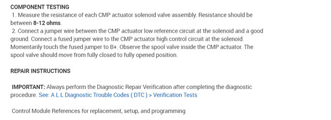

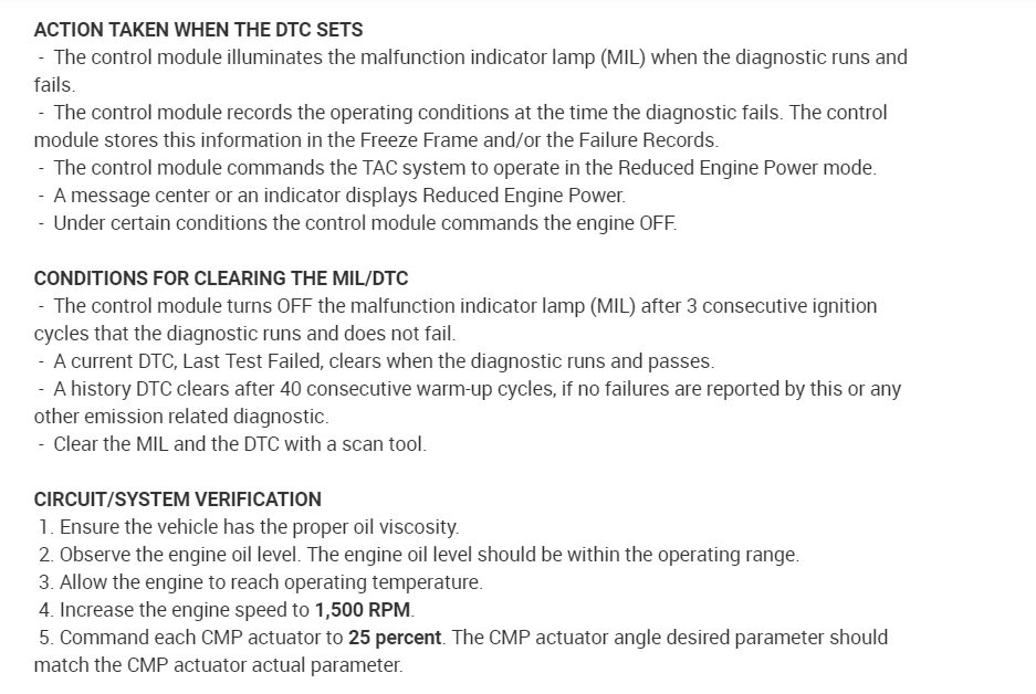

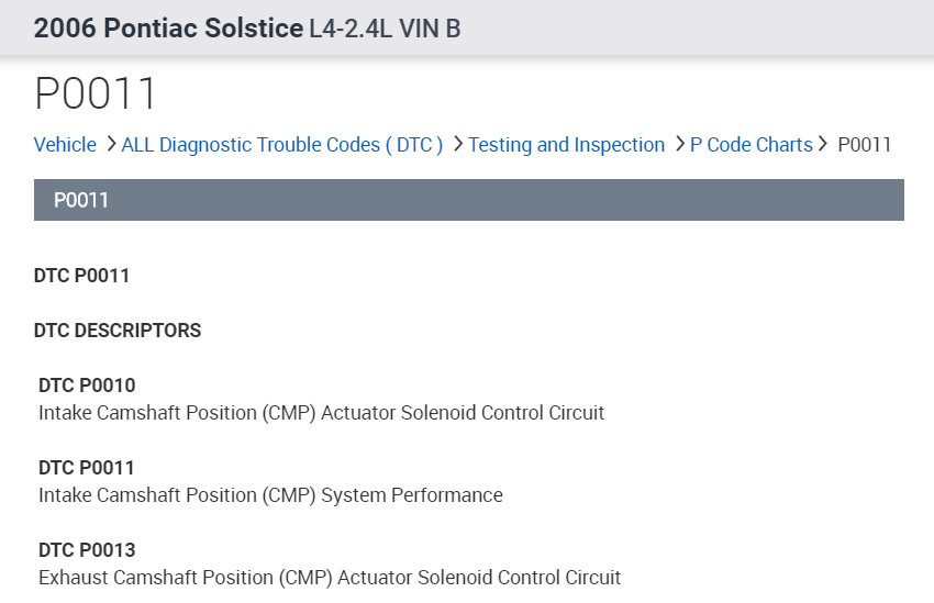

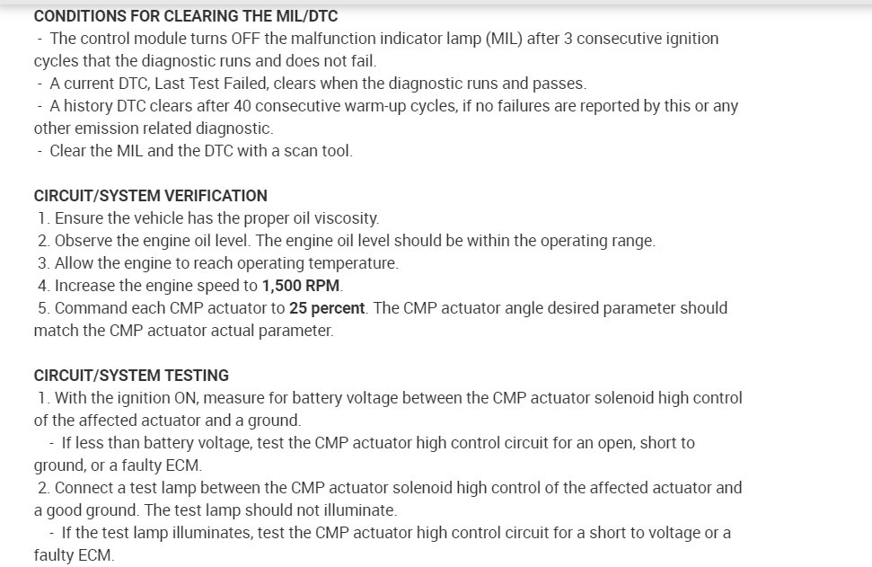

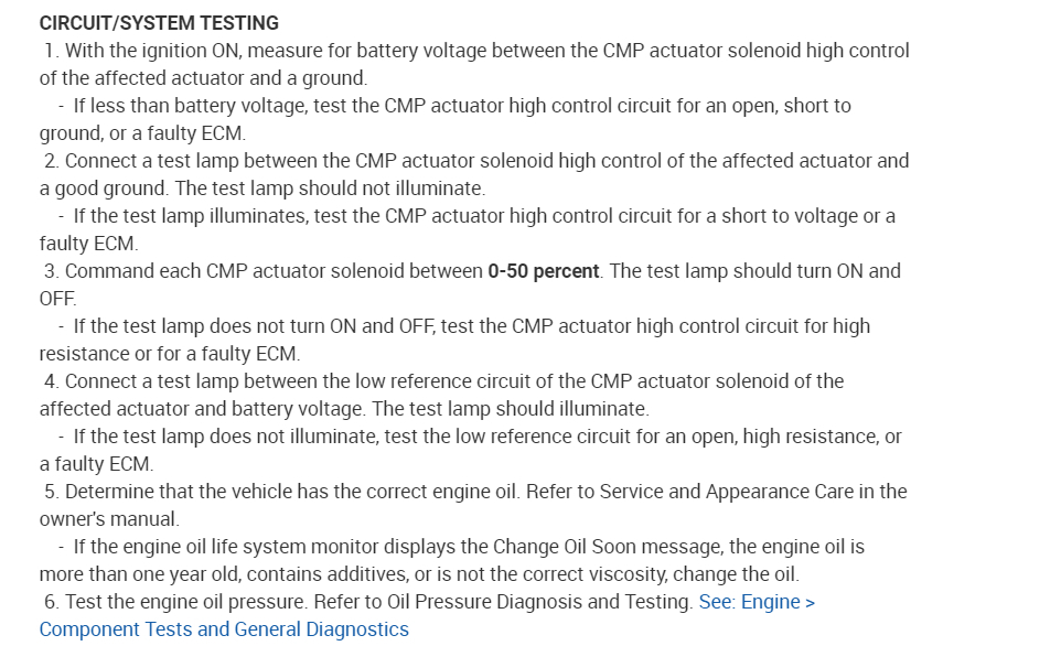

There is no Direct Trouble Code (DTC) P07e8. DTC's have a letter (P,B,U,C) followed by four numbers. In the diagrams down below I have included the factory diagnostic troubleshooting guides for DTC's P0011 and P0013. Please go through these guides and get back to us with what you are able to find out.
