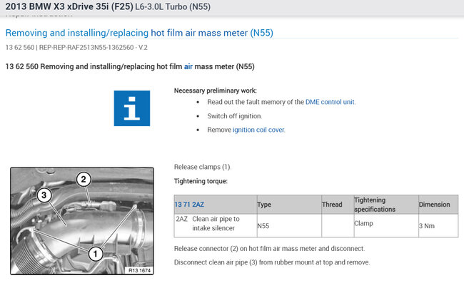

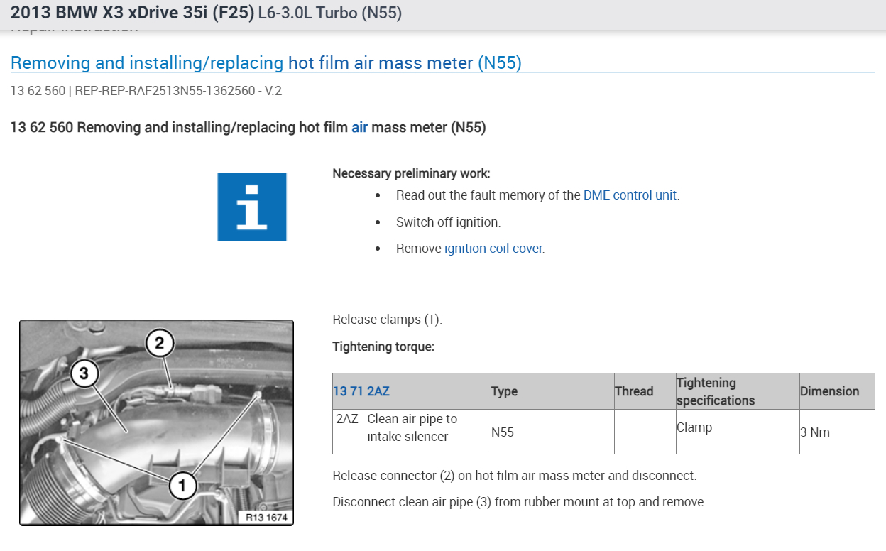

So, I would make sure the air intake is in good shape with no cracks, if there were no leaks I would change out the MAF sensor and then clear the codes. Check out the images (below). Please let us know how it goes.
Jul 15, 2023 at 11:32 AM

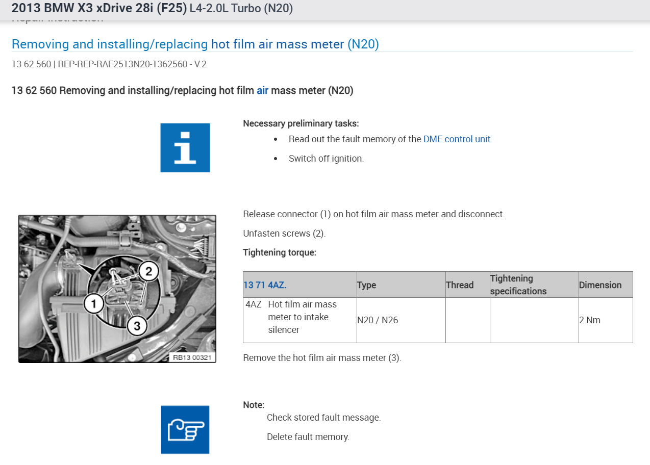

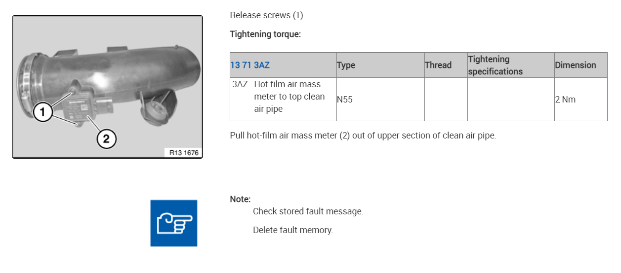

My bad, sorry, here is the correct information. Check out the images (below). Please let us know what happens.
Jul 17, 2023 at 9:54 AM
