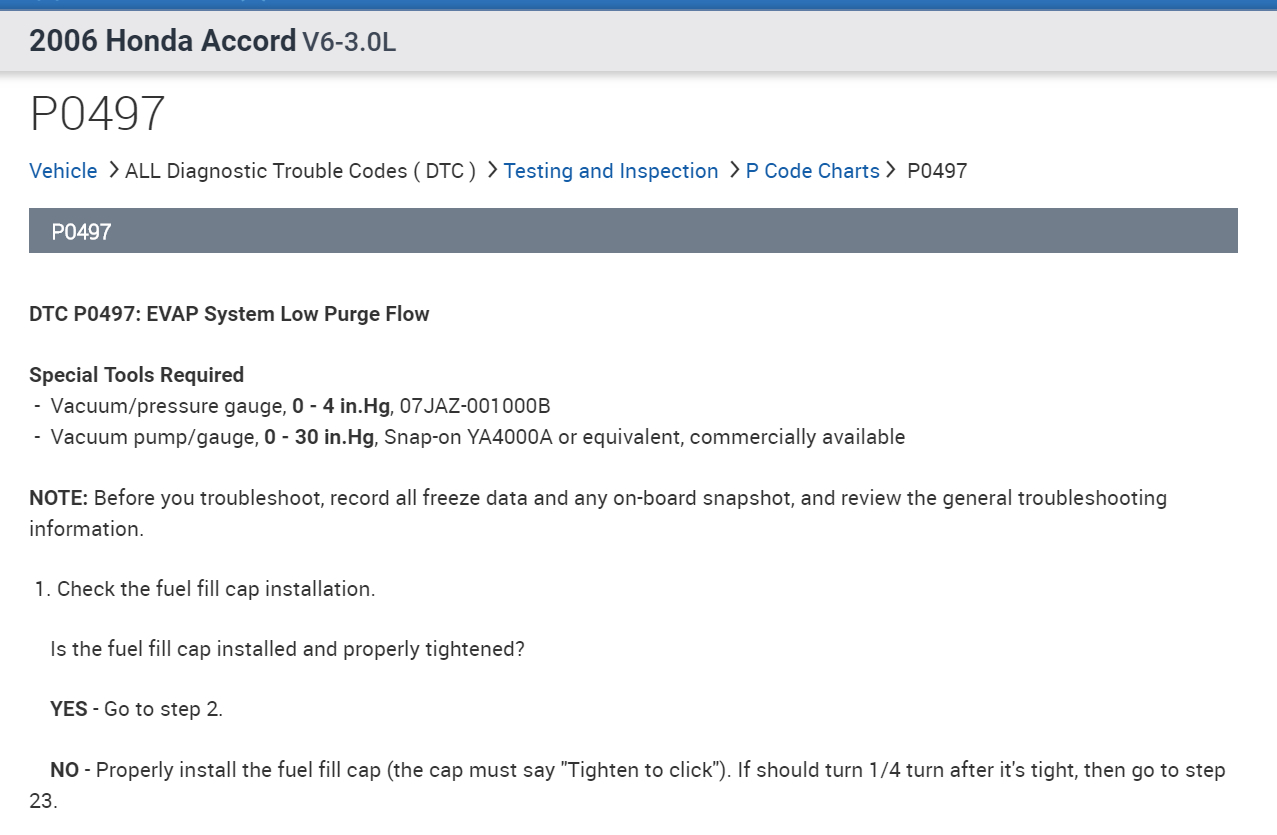

Hello, My car was bought new will be thirteen years old next month. car is well maintained. just replaced catalytic converter, then code came back had o2 sensor replaced on down stream replaced only. then code still came back po497. it said purge canister going to bring back to shop Monday morning. last year I had the purge solenoid replaced. thanks for reading. let me no what you think next action to take. car has been my little baby. thanks again, Steve
