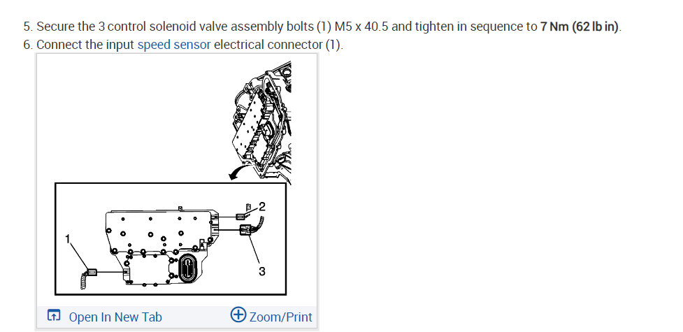

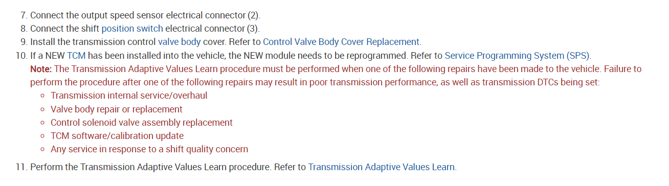

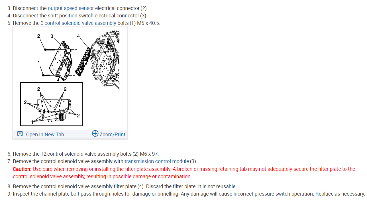

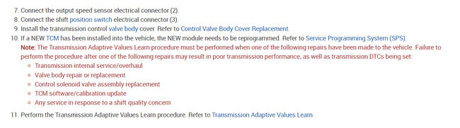

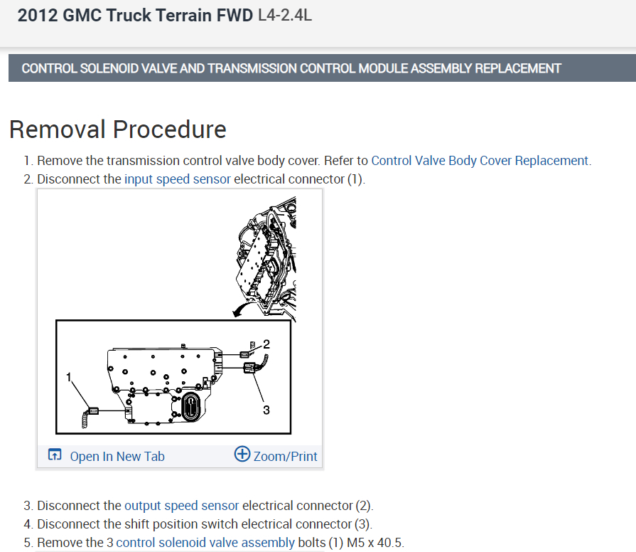

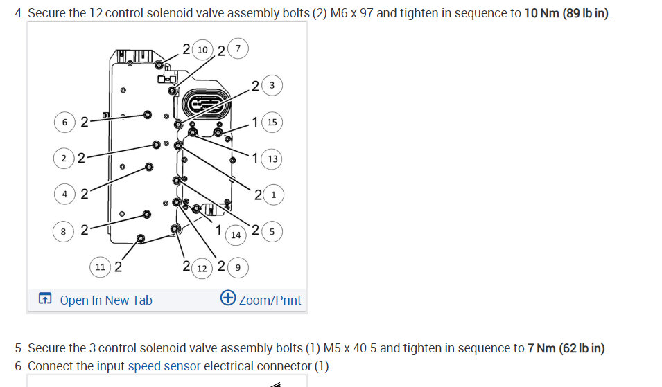

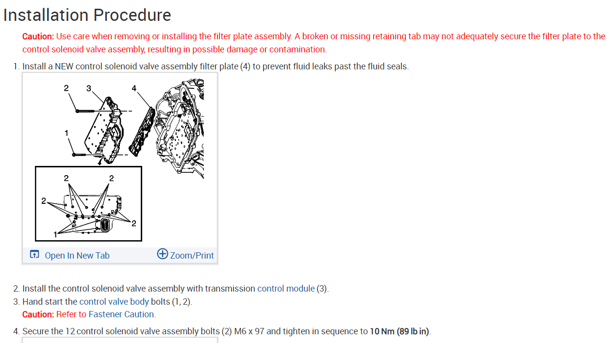

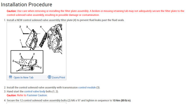

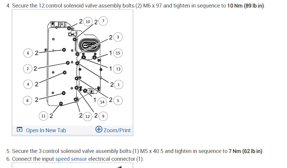

I have since replaced the high pleasure sensor ( what a pain it's under the intake) I changed plugs and coils replaced both cam and crank solenoids cleaned the intake and throttle body I wrapped the intake with sound deadening foam for insulation ps it does have a foil layer. Ran good for a few days and runs good while driving the problem happens when I come to a stop then I get the errors again. I bought a cheap obdll scanner (elm 327) now since I've cleared codes, I'm getting just 2 errors obdll code u0100 and transmission control module code u0100. I haven't been able to locate the tcm the part I googled doesn't seem to be the same. So, I don't really know where the TCM is.
