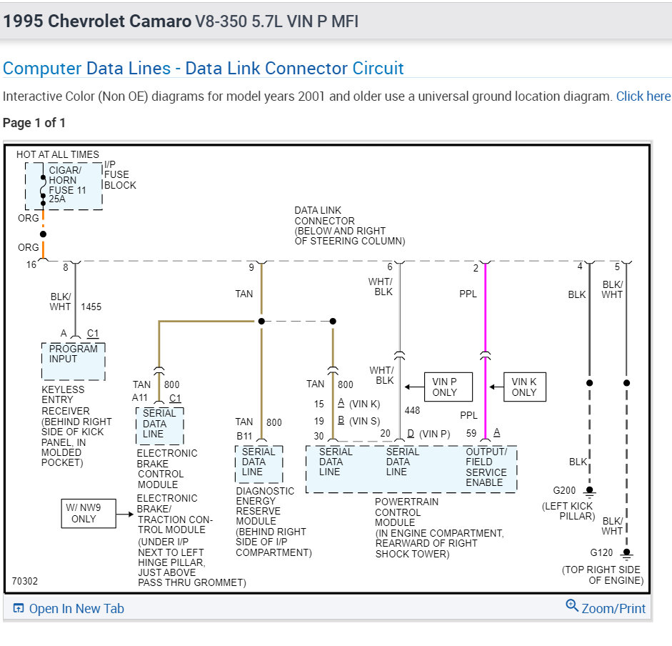

I hear you; can you check the orange wire at the OBD1 connector for power? This guide can help, we will find the problem hang in there.
Check out the images (below). Please let us know how it goes.

Yes, the orange wire has power.
Oct 12, 2023 at 1:44 PM
Good, now check the blk and the blk/wht wires for ground at the ALDL.
Just connect the test light to the power side of the battery.

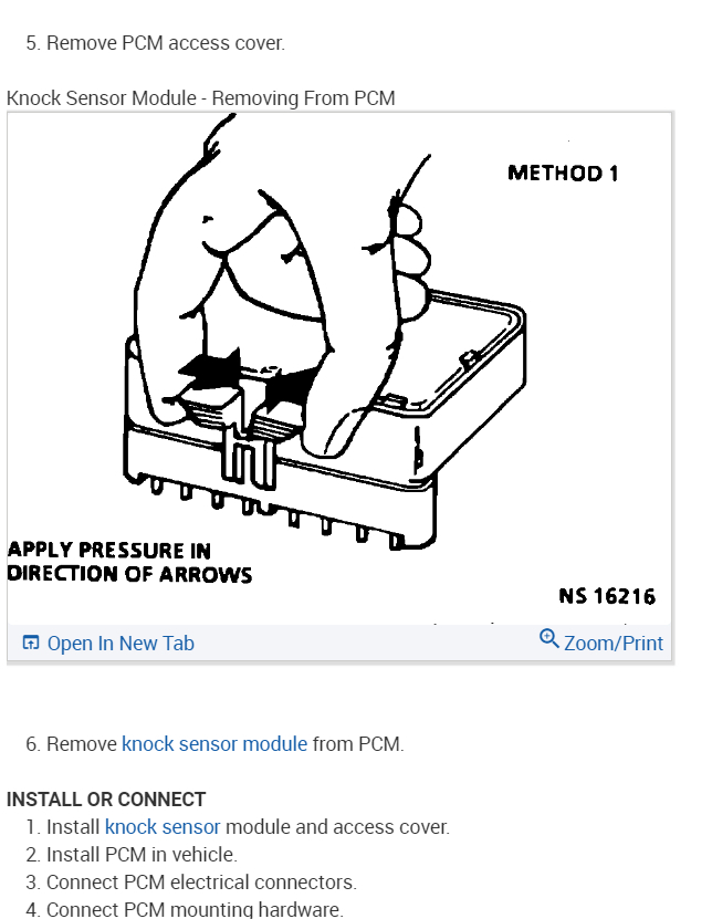

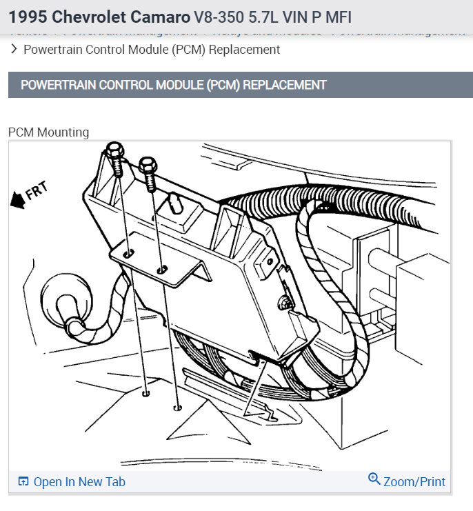

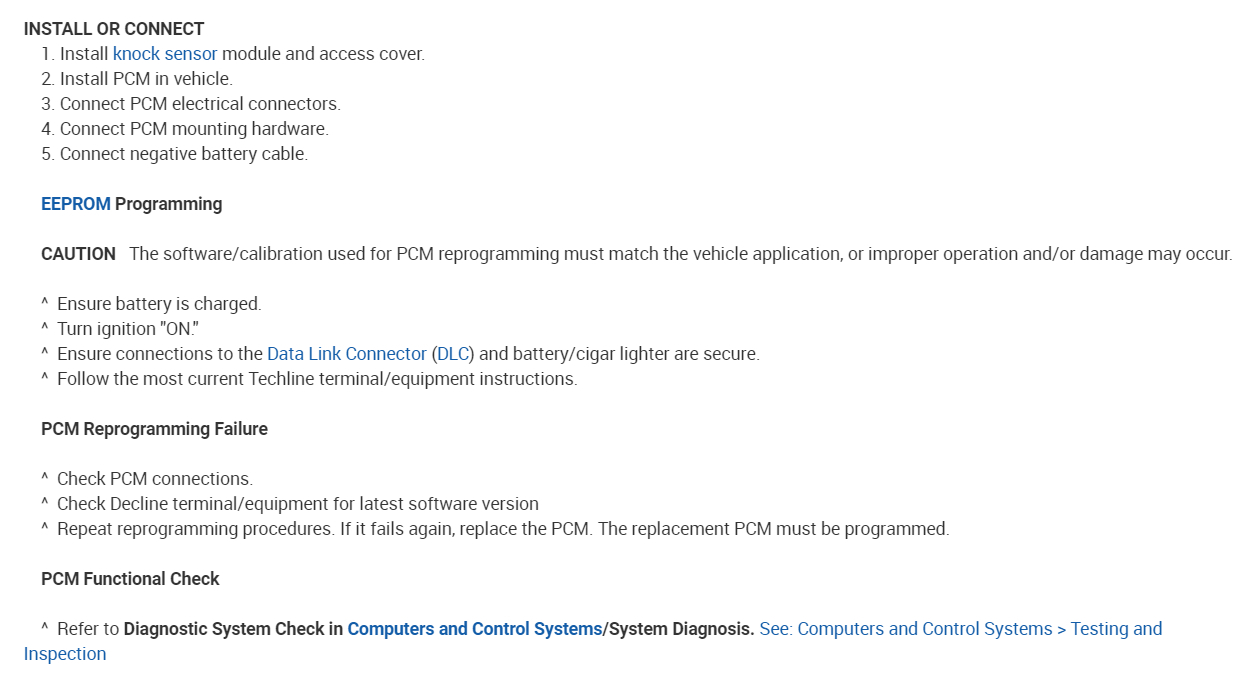

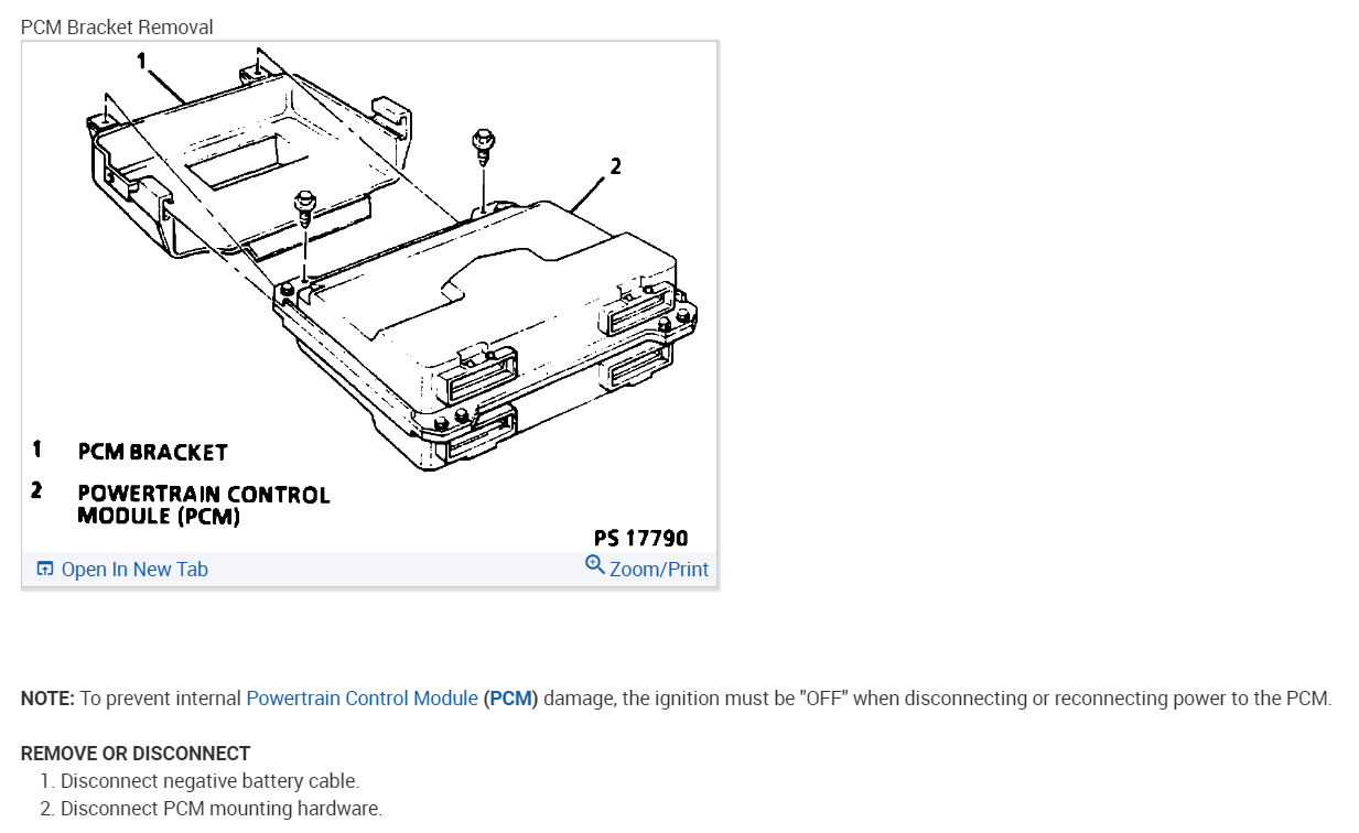

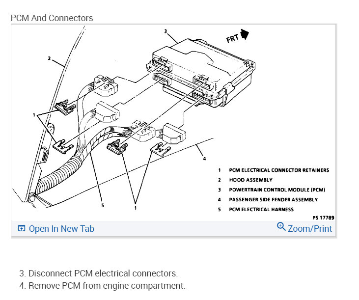

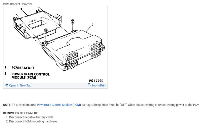

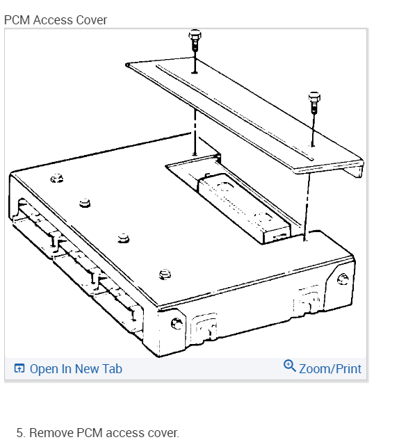

I would check all fuses and if okay I would send the PCM in for testing, here is the location and how the job is done. Check out the images (below). Please let us know what happens.
