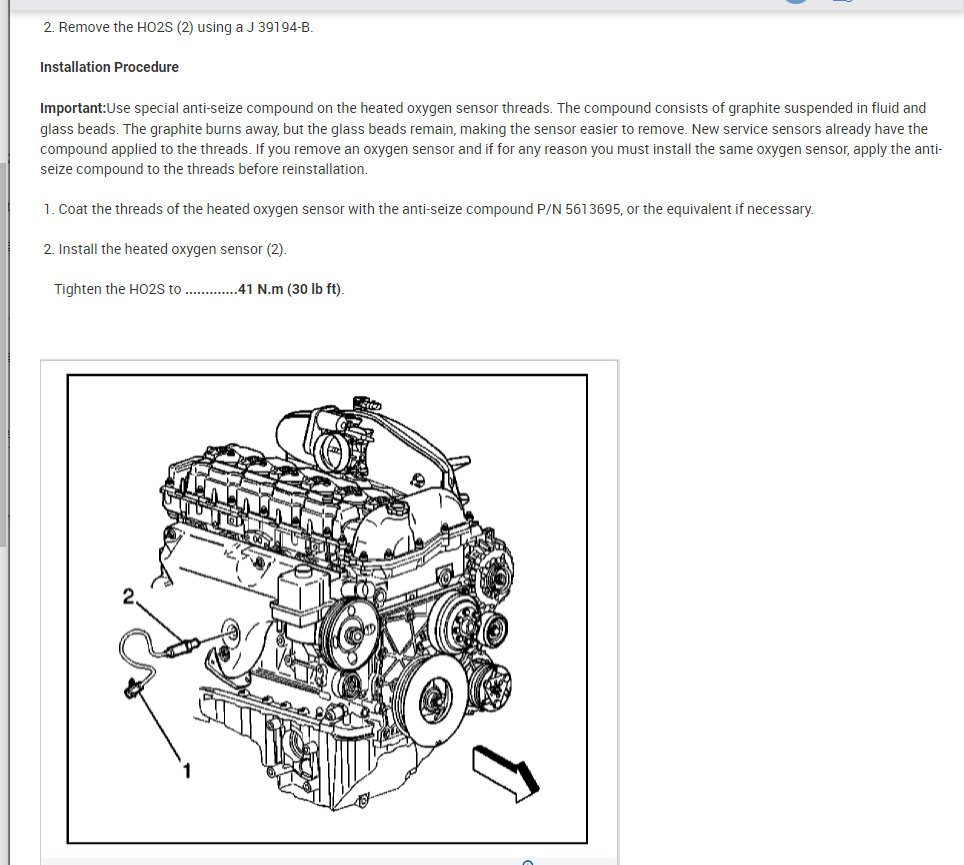

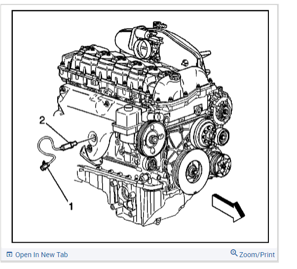

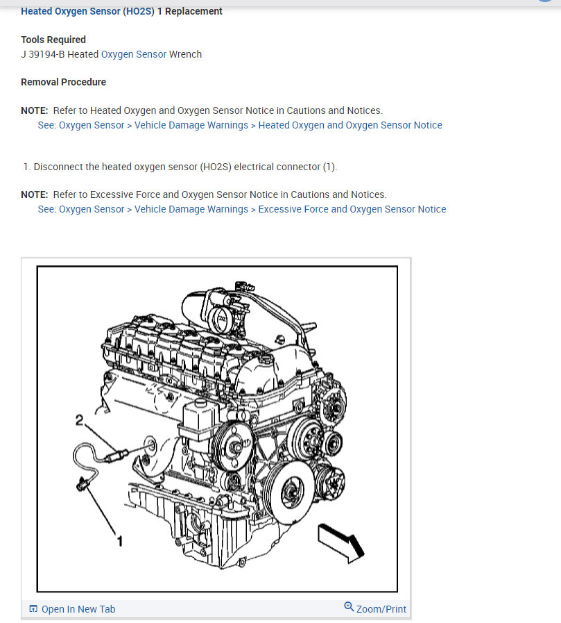

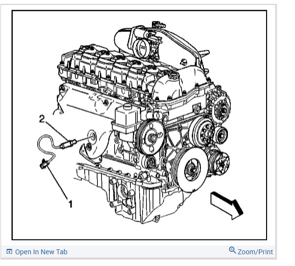

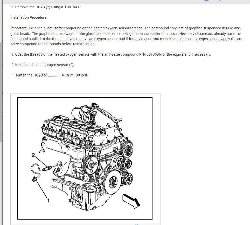

Need to know where the oxygen sensor bank 1 sensor 1 is located at?
Oct 24, 2018 at 8:53 AM
SQM
CERTIFIED EXPERT
6,383 POSTS
Please see attached picture below.
Also, here are a couple guides that will help with testing and info on o2 sensors:
https://www.2carpros.com/articles/how-to-test-an-oxygen-sensor-02-sensor
https://www.2carpros.com/articles/how-to-replace-an-oxygen-sensor
Below you will find the process from the manual which includes the location of the sensor.
Please me know if you have other questions.
