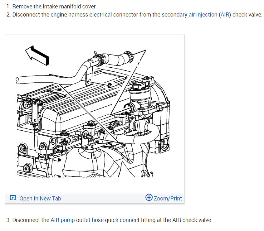

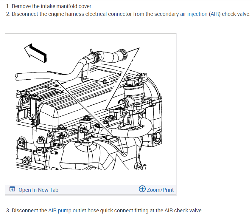

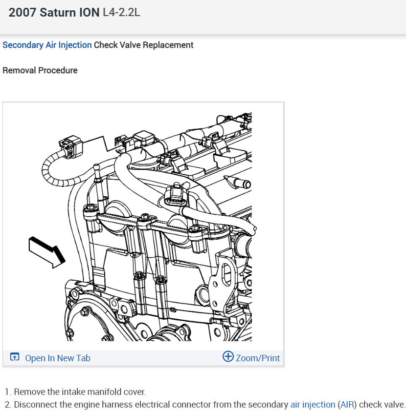

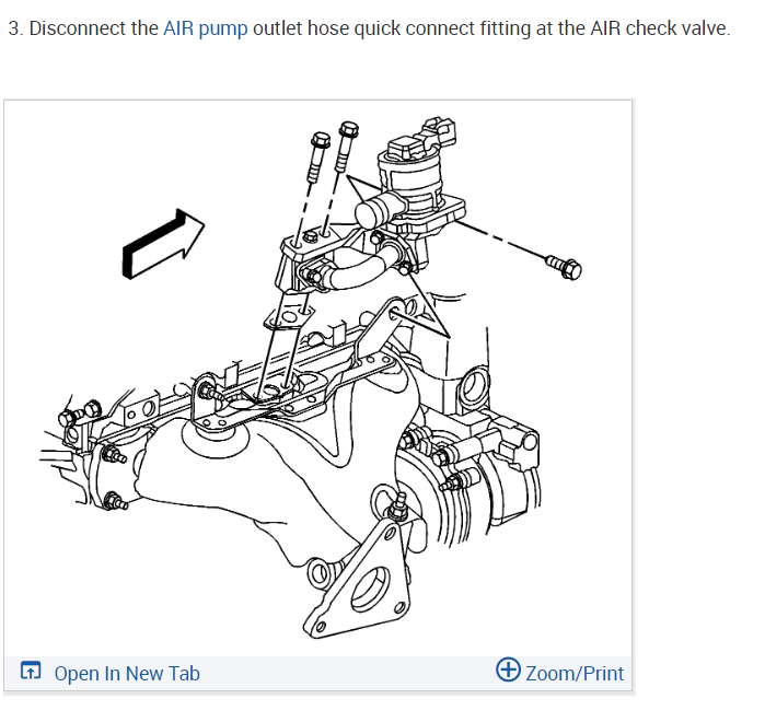

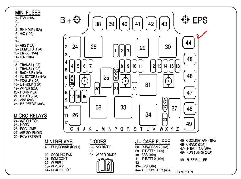

So, what happens is the air check valve ends up going bad. I would remove the valve, you should be able to blow through it one way only. If you can blow through it both ways it is bad. Also, I would swap out the air pump relay because they can burn up once the air pump motor goes bad. Check out the images (below). Please upload pictures or videos in your response of any problems so we can see what to help you with.
