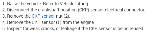

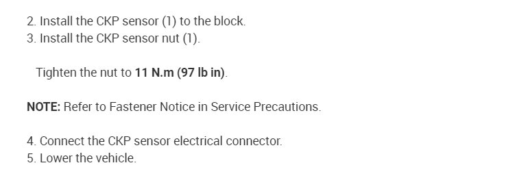

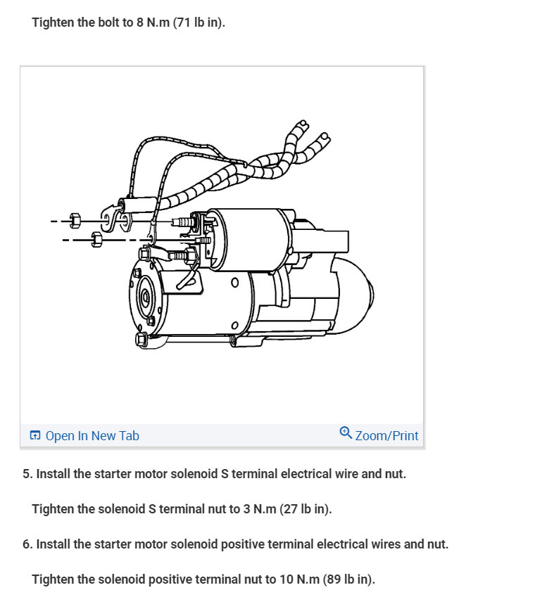

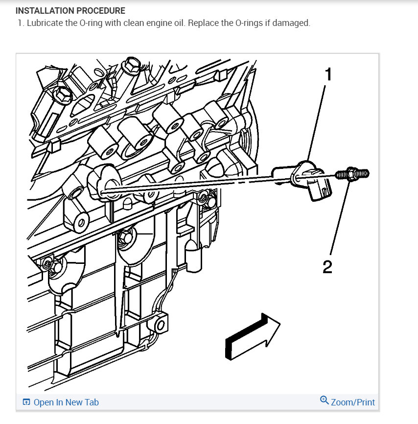

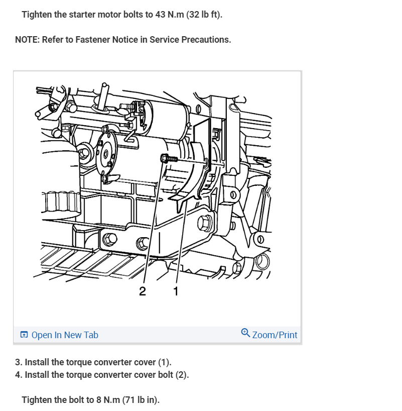

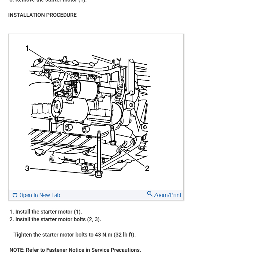

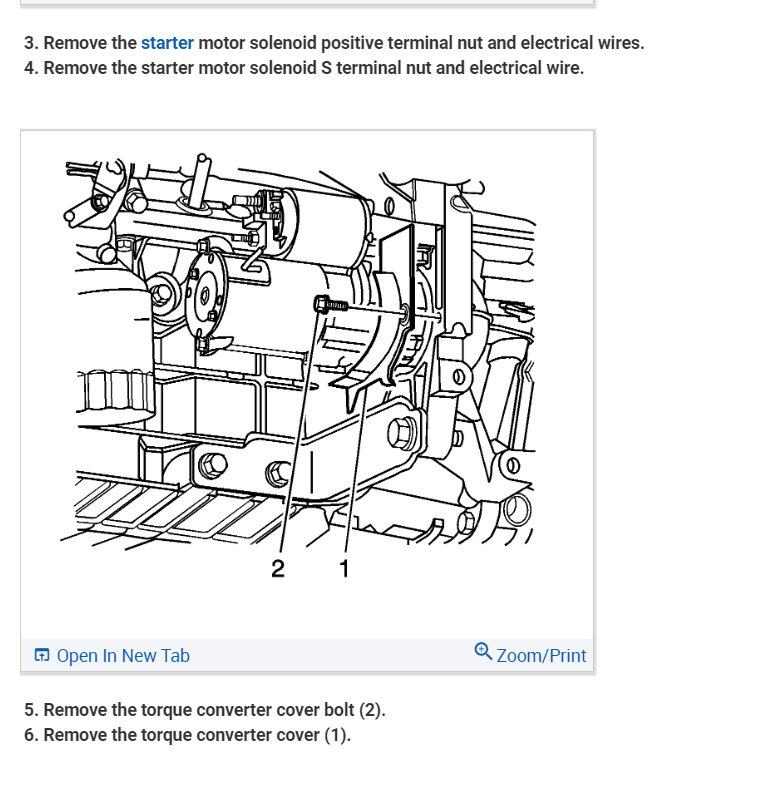

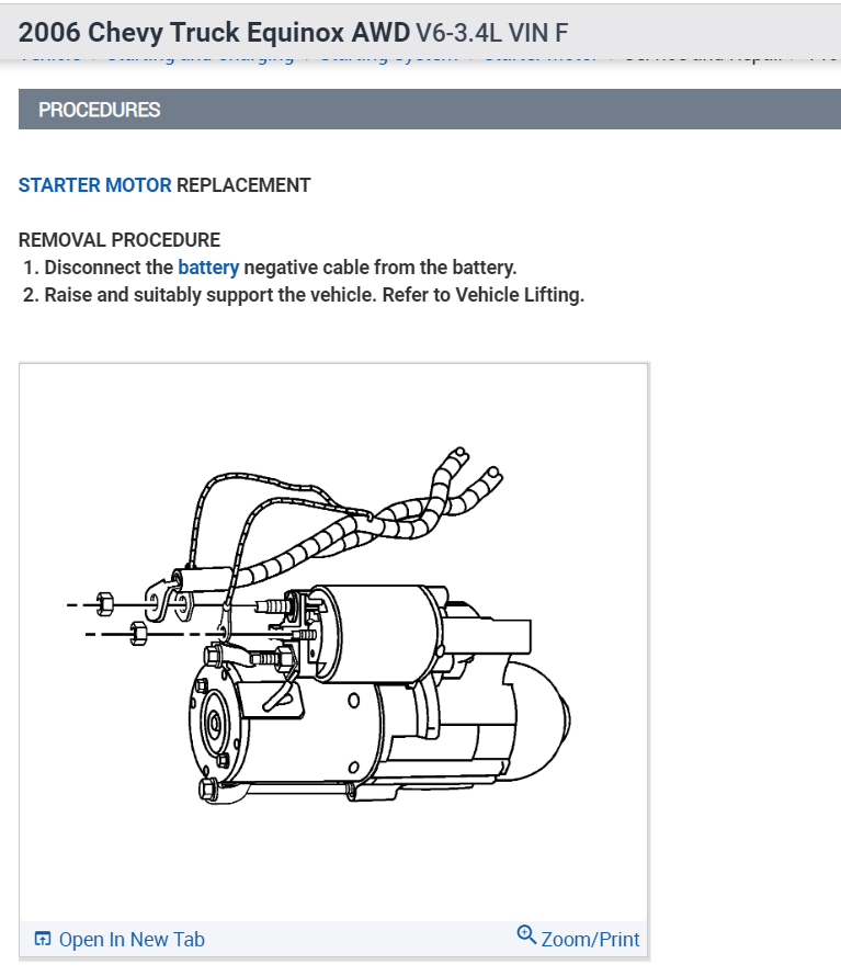

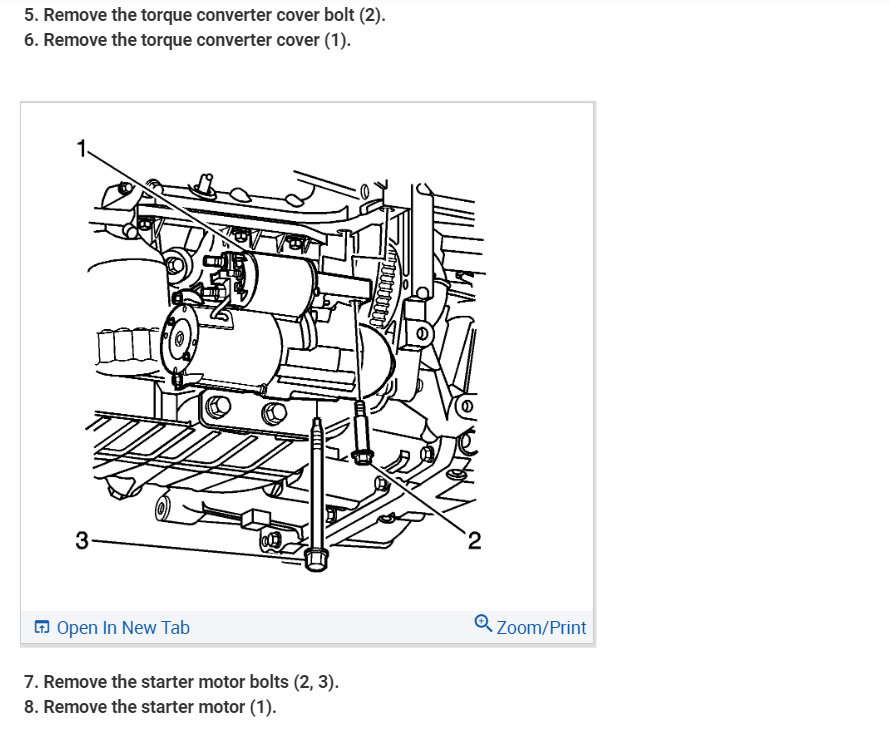

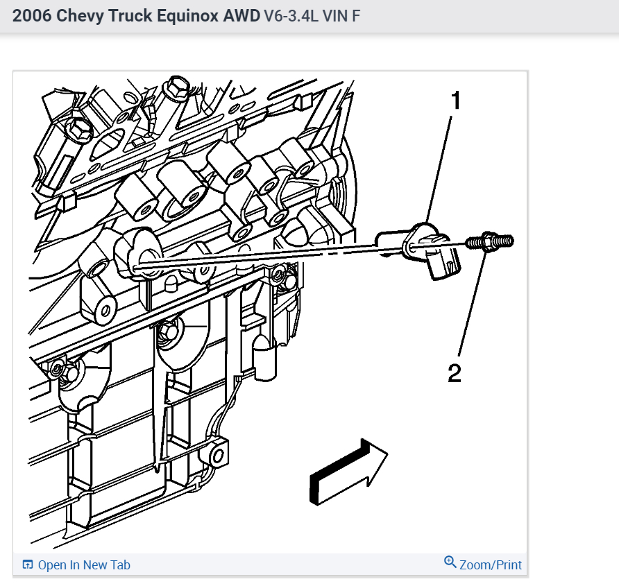

It sounds like the starter has gone bad or you have a bad connection at the battery, here are two guides to help us see what's going on and I have included how to change the starter out in case you need it. Also, I would remove the new sensor to see if it is too long and contacting the crankshaft.
https://www.2carpros.com/articles/starter-not-working-repair
and
Check out the images (below). Let us know what happens and please upload pictures or videos of the problem so we can see what's going on.

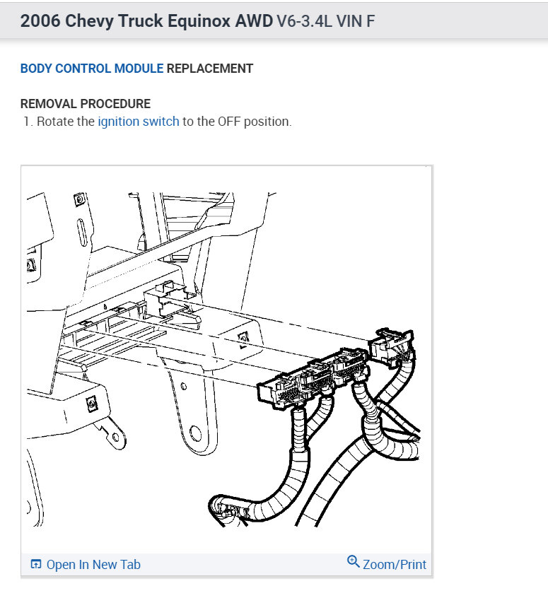

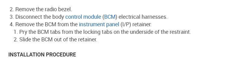

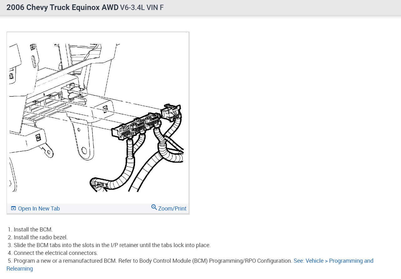

The BCM can cause all of the problems you are having but I would check the fuses first. Here is the location and how to change the BCM out. Check out the images (below). Please let us know what happens.
Jun 11, 2023 at 11:47 AM

Good morning, Ken, my friend, I hope all is well. fuses look good I will order a BCM I understand how to put it in but I'm not too sure about programming. I will keep you informed. thank you. Kenny

Good morning, my friend hope all is well. I just changed the BCM about twenty minutes ago car is still doing same thing will not start is there a relearn or program or maybe I missed a fuse in checking. then I only checked the one under hood could not get down to under dashboard on drive side due to my health.
Jul 10, 2023 at 5:09 AM
Was the BCM perprogramemd? Also is the security light flashing when you try to crank the engine over?
Jul 10, 2023 at 10:33 AM
PRRYPERRYS
  • 150 POSTS
Hey, my friend, I don't know if it was programmed. I bought it used from a parts store offline. Ebay and just put it in my car.
The security lockout light is blinking now. Before I changed BCM it was not blinking it was just on.
Jul 10, 2023 at 12:55 PM
It must be preprogrammed, or you will have this problem of the security lock out.

You must send it in to be programmed or have a scanner capable of doing so from data collected from your old BCM.
