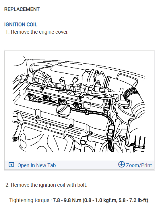

car has dead miss shows code p0302, has new plugs, checked for fire # 2 cylinder has none what controls the fire where is it located?

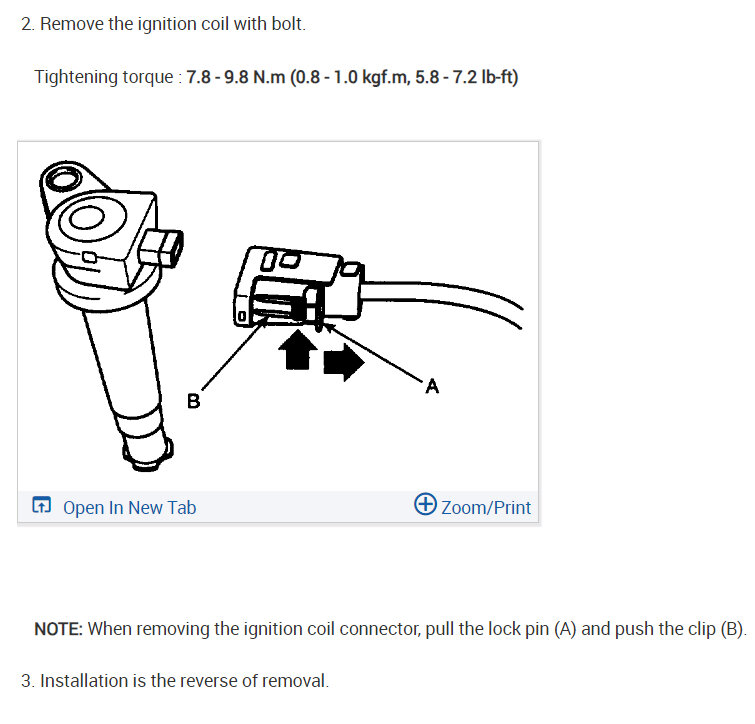

This can be low compression or the bad fuel injector or ignition coil, if you don't have spark replace the coil, this guide and video should help.
https://www.2carpros.com/articles/engine-misfires-or-runs-rough
and the spark test video
https://youtu.be/baq_aEWNQ0Y?si=0FFx-xoLhabJuzoh
Here is how to change the ignition coils out. Check out the images (below). Please let us know what happens.
