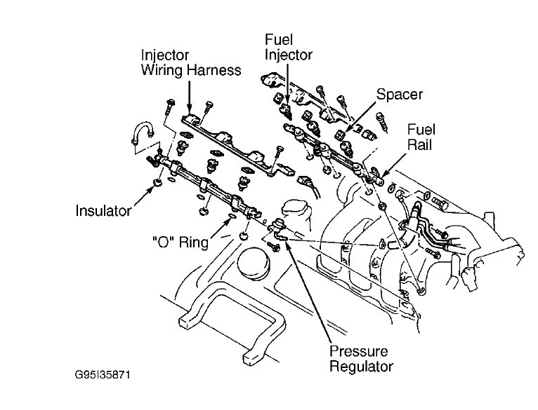

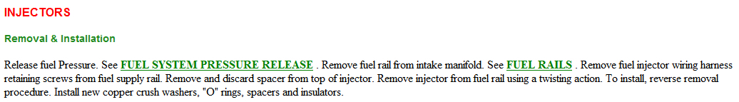

Have you checked the injector number 2? if the pulse from the control unit present, you can use a noid light for injector pulse test its the easiest way. also perform compression test at cylinder 2 compare with others.
