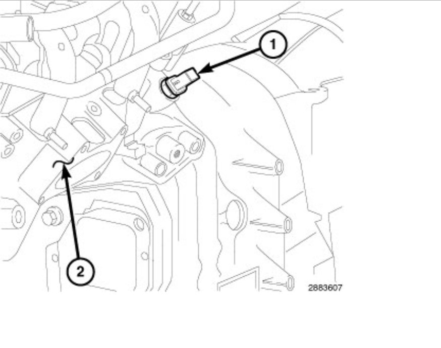

Here is a guide to show you what you are in for when doing the job and a diagram (below) to help you get the sensor replaced:
https://www.2carpros.com/articles/coolant-temperature-sensor-cts-replacement
and if the code comes back I would replace the thermostat .
