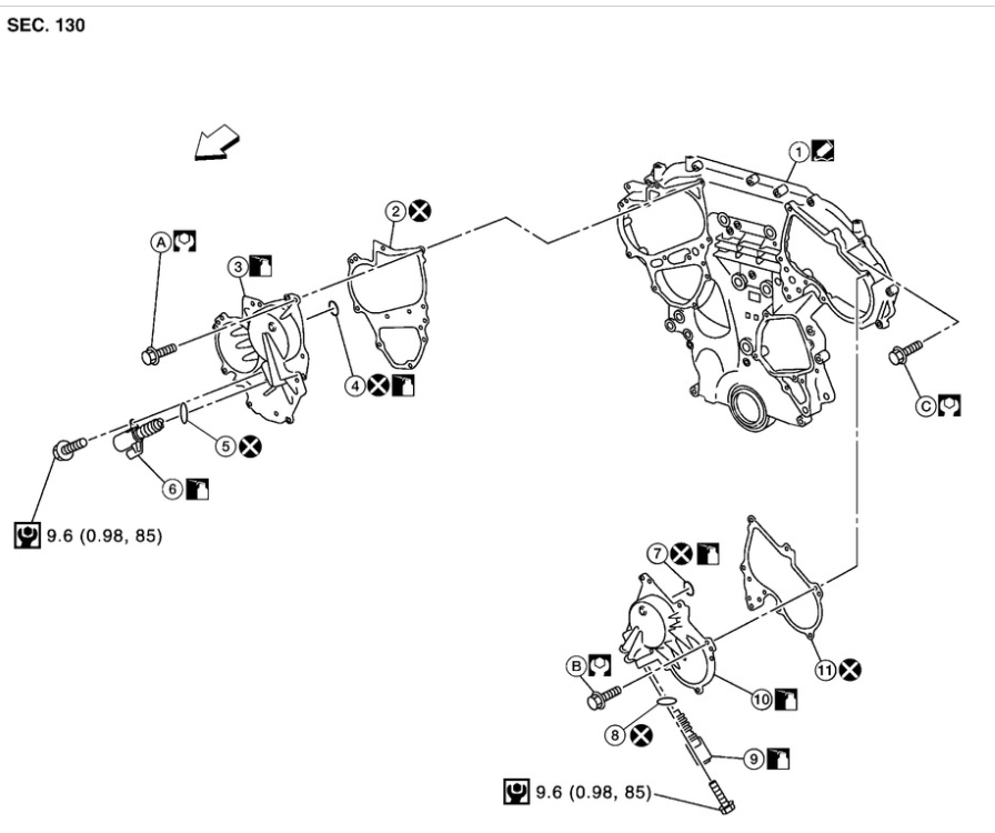

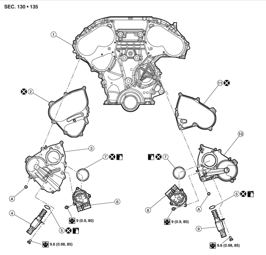

I would check both valve timing (IVT) control actuators on each side. There should be a screen on the end of the control valve which come become clogged with gunk and metal shavings. Check out the images (below). Please let us know what happens.

Hi Ken, would you mind pointing out (what number in the pictures) where this screen is and what the actuators are? Getting a randomly repeating P34C4 code after doing the timing chain at startup. vehicle runs normally.
Apr 29, 2024 at 4:31 PM
Did you replace the camshaft actuators? They go out often. They are #4 and #9 in the diagrams. I would remove the oil control valves and see if the screen is clogged, which also happens regularly.

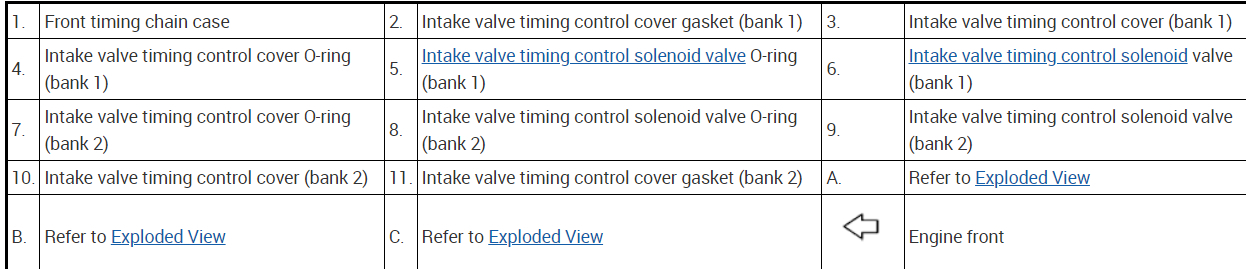

Thanks for the tips. Will give that a go. Which one is Bank 1 (pertaining to P34c4 code), left or right (assuming left). Wondering if I accidentally got a bit of sealant dripped on the actuator when putting the cover back on.
Apr 29, 2024 at 6:52 PM
JOEL MURPHY
  • 6 POSTS
nevermind on the banks i see you've attached a legend that explains it. Thanks for the help!
