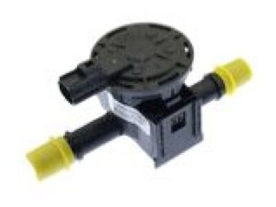

After reading multiple forums, it was suggested that the problem could be the Canister Vent Valve (some people called it the Fuel Tank Isolation Valve FTIV). I attached a picture of the part in question.
This is an expensive part, so is there any way for me to check to see if this is actually the problem?

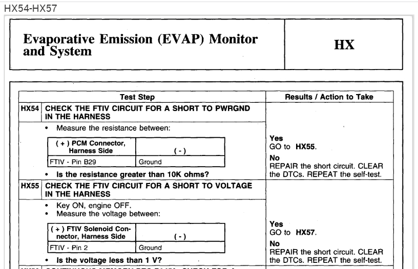

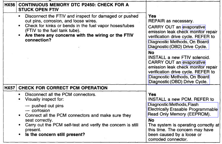

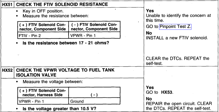

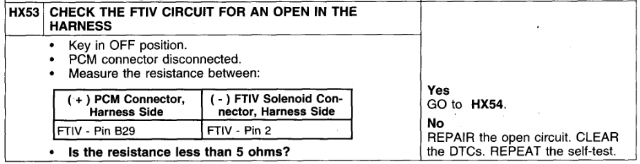

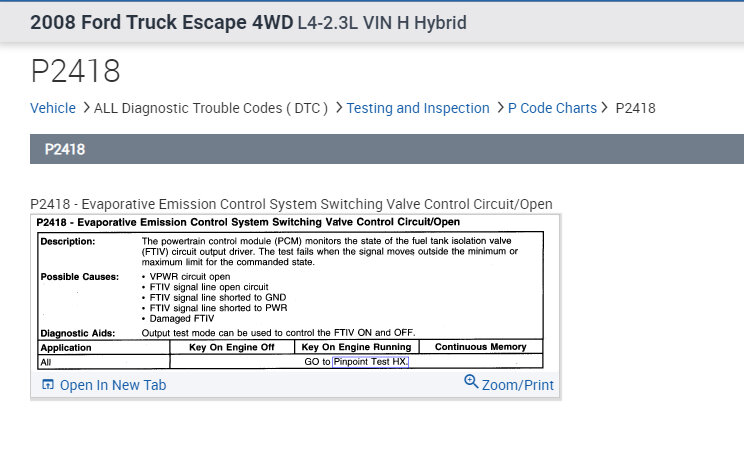

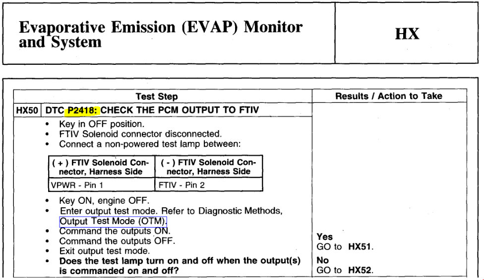

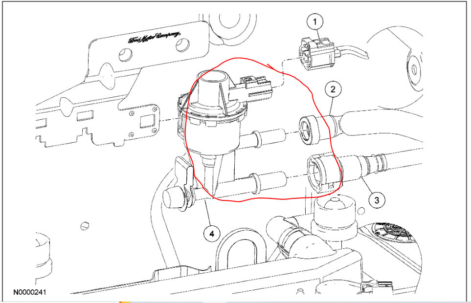

That's the part. As far as testing, my manual provides a 57 step test. LOL By luck, I read in the first few test procedures to go to step 51 or 52.
Take a look at the diagnostics below. Let me know if they help.
Joe.
See pics below.
