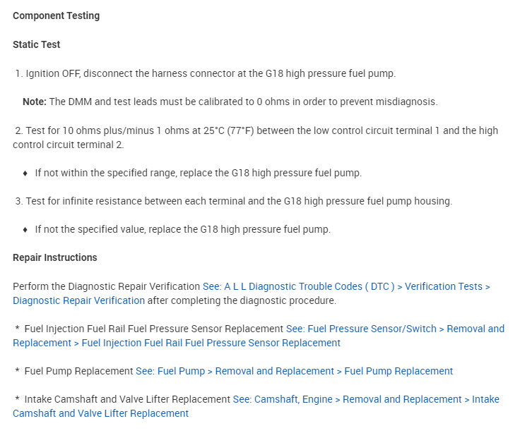

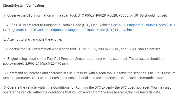

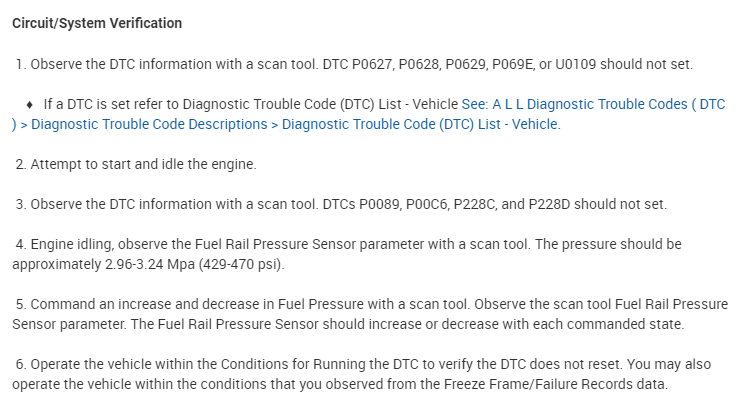

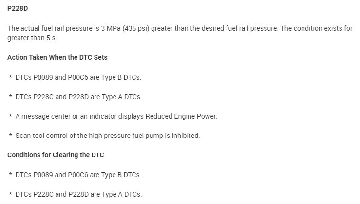

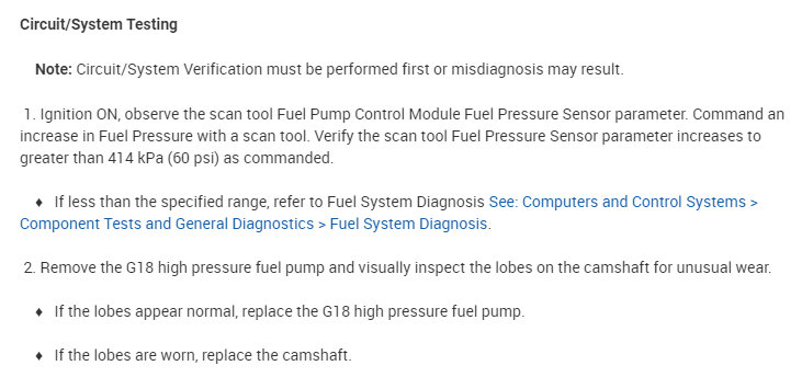

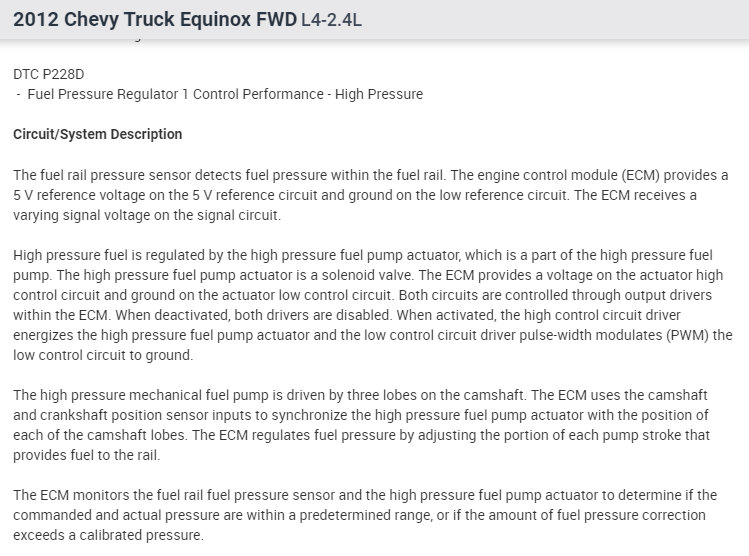

Hi, I have been dealing with a number of issues with this car. When driving down highway the car will go into low power mode or engine reduce power. There is a loud ticking sound coming from engine and it is idling very rough. Took it to shop and was told it was a bad timing chain. We replaced the timing chain and balancing chain because the tensioner broke. After repair, the noise is still there and we are still getting a message of “engine reduce power” while idling rough.. a new code came up after repair of timing chain - p228d. Have you experienced any of this and do you have any recommendations? Thank you for your time!
