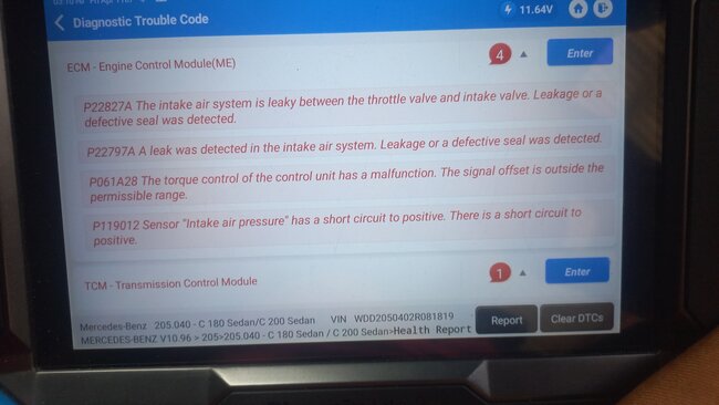

I performed a scan and these codes P22827A and P22797A are showing up. I did a smoke test and found everything to be good, no leaks. I was thinking about the PCV valve but I'm not sure. Any further assistance will be appreciated. Thanks
Apr 11, 2025 at 5:03 PM
Did you check the air intake boot/tube between the throttle body and MAF sensor, this is where the leak will be not the intake manifold.
Code: P22827A Air system leak between MAF and throttle body
Code: P22797A Intake air system leak - air leakage detected
I would remove the air tube and MAF and look for a broken seal or a spilt tube. Please upload pictures or videos in your response of any problems.

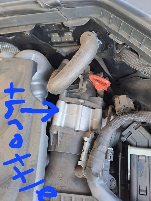

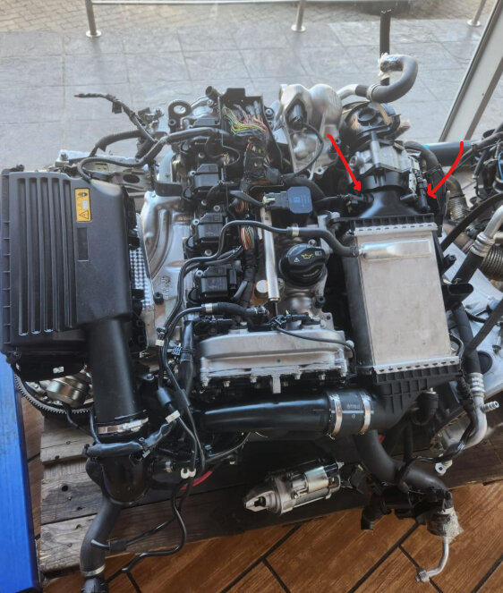

M274 is the model engine. Photos of the engine and diagnostic scan codes. When zoom in the photos there are 2 sensors opposite to each other before the throttle body. So it's 2 sensors, the throttle body and then intake manifold.
To note throttle body bolts directly on the intake manifold.

Where is the MAF sensor in these pictures I don't see it? Did you look for the leak between the two?

Trying to figure our where is the MAF sensor located.
Apr 20, 2025 at 10:33 AM
It should be in the intake tube before the throttle body.
Apr 20, 2025 at 11:19 AM
HSNDSOME
  • 31 POSTS

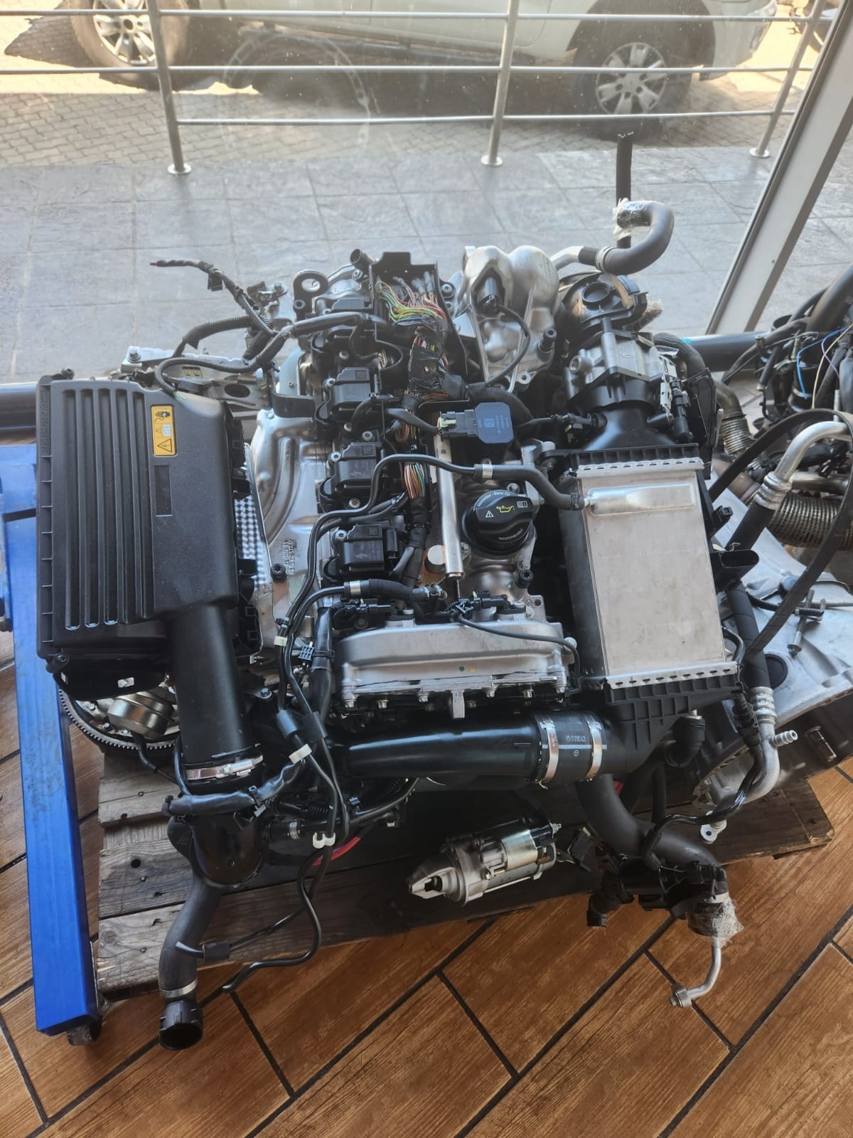

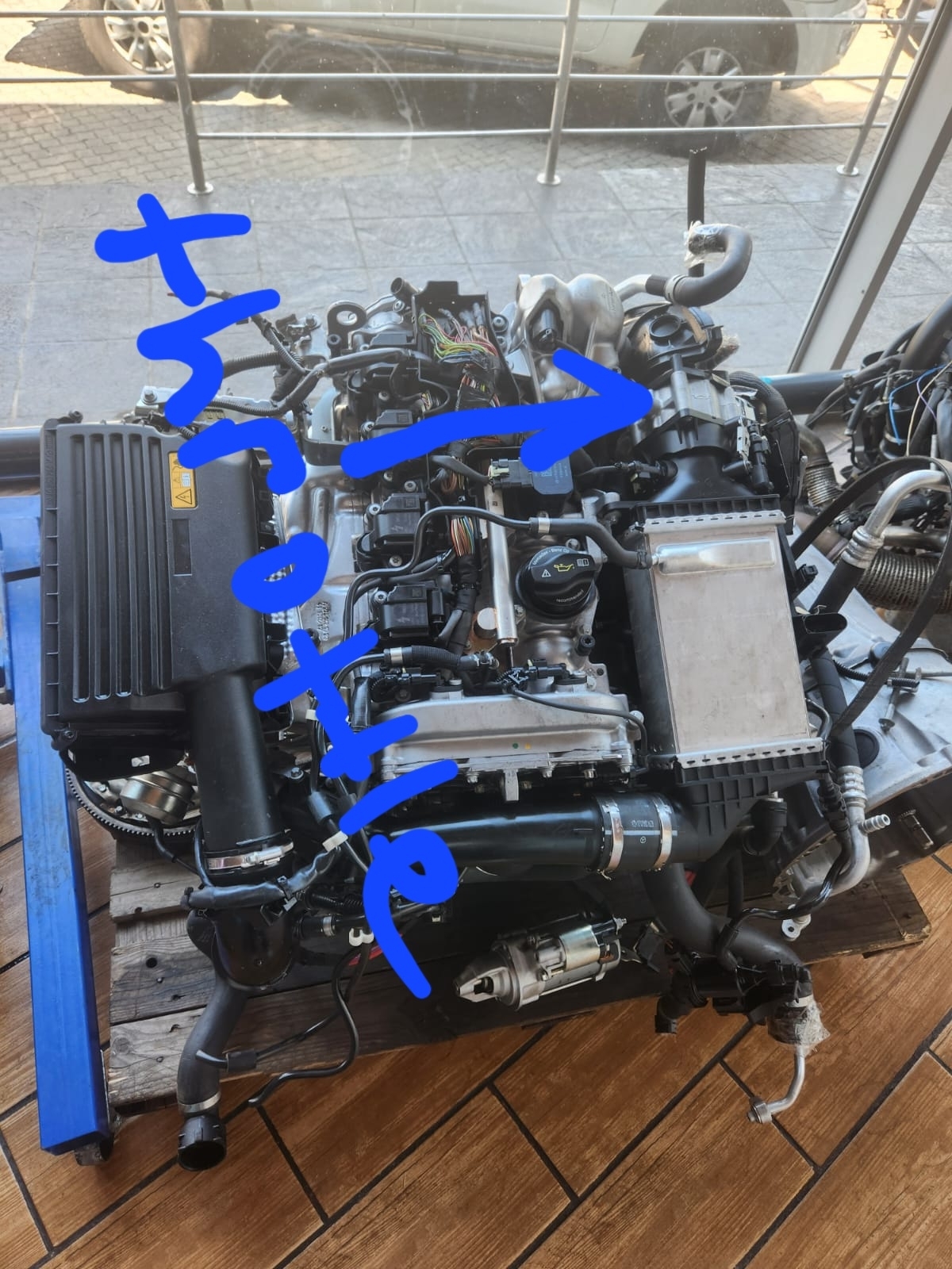

Photos of engine.
Apr 21, 2025 at 6:01 AM
I need better images of the engine intake but I marked where I think the sensor is. Check out the images (below). Let us know what you find.
Apr 21, 2025 at 9:58 AM
HSNDSOME
  • 31 POSTS
The sensors on the left is TEMPERATURE SENSOR; AT CHARGING AIR INTERCOOLER.
The sensor on the right is PRESSURE TRANSMITTER AT CHARGING AIR INTERCOOLER.
