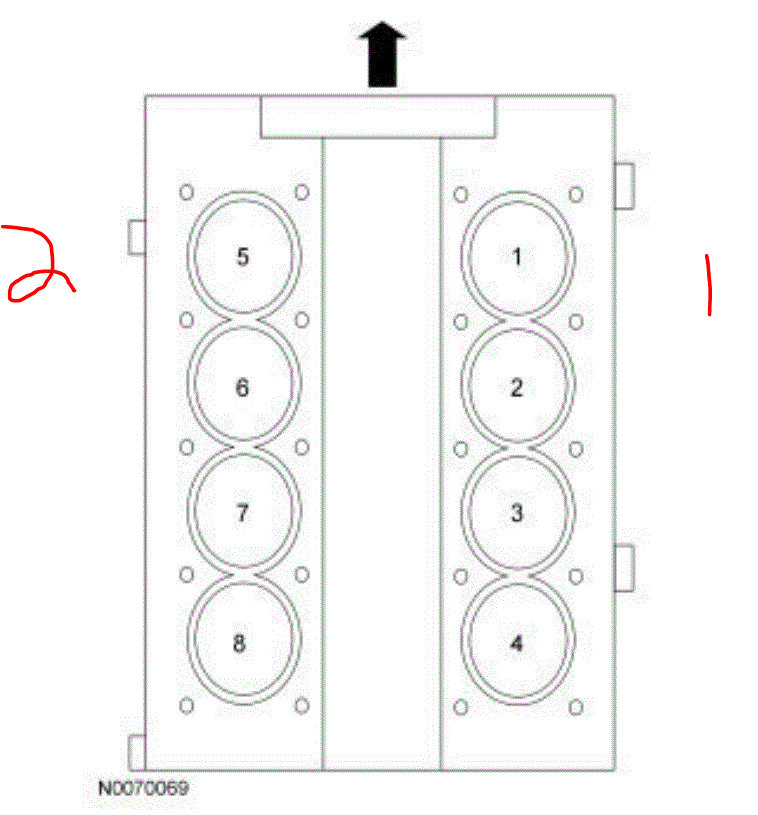

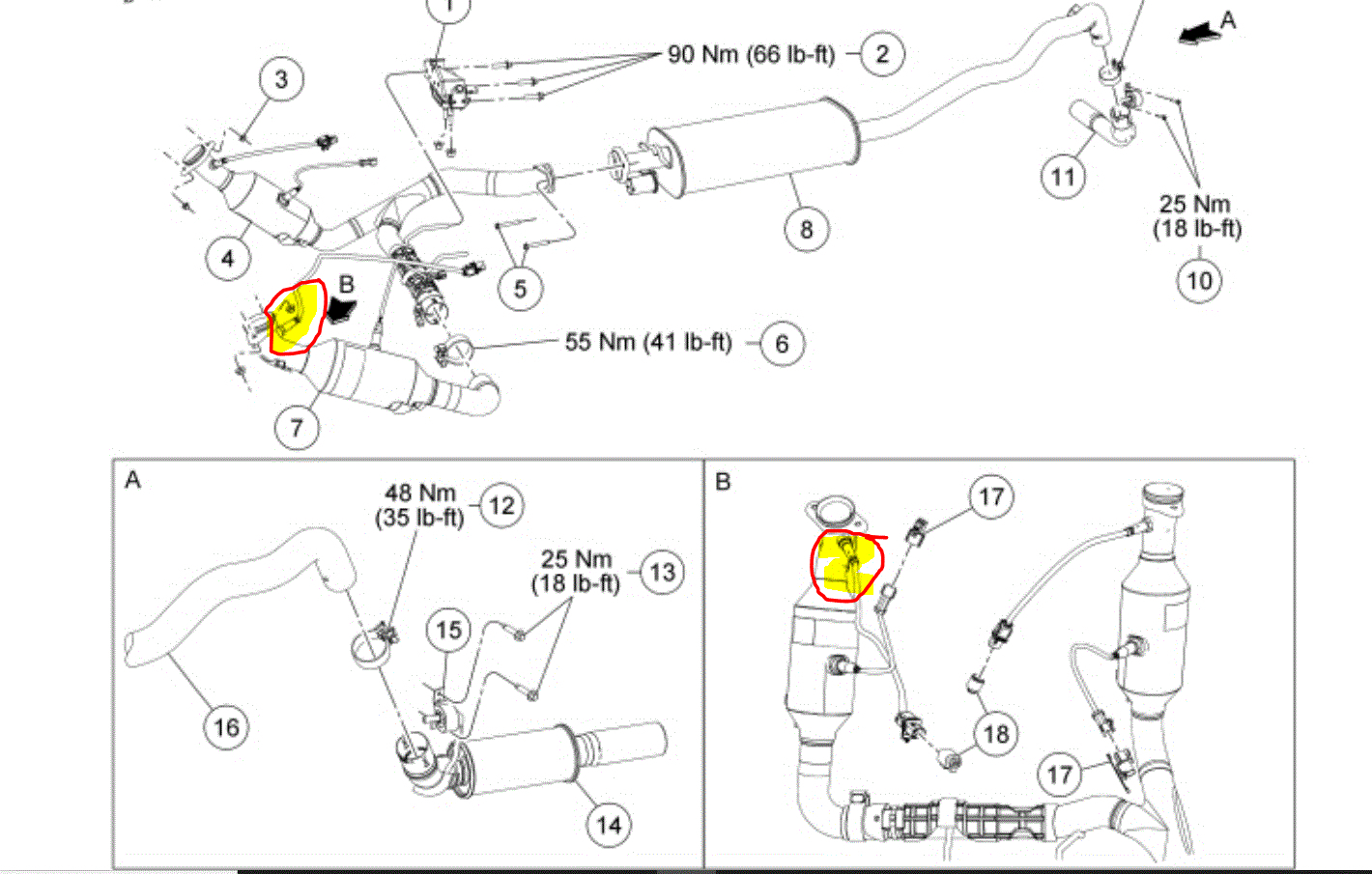

Repeatedly getting this code P2247 CODE 2013 Lincoln Navigator Bank Two Sensor One
Does anyone have a diagram to where the exact location of this sensor?

If you look at the pics below, pic 1 shows the exhaust system. There are a total of 4 sensors. The one you need is bank two which is the driver's side of the vehicle and it is right after the exhaust manifold and before the catalytic converter. I highlighted it in two places in the pic.
Pic 2 below shows the orientation of the engine with an arrow pointing towards the front of the vehicle. I numbered which side is bank 1 and 2.
Now here is the concern. The code indicates an open circuit to this sensor. You could have a broken wire, a damaged connector, or even a disconnected sensor, so check those things first before replacement. If everything looks good, chances are it is the sensor.
