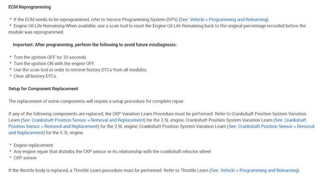

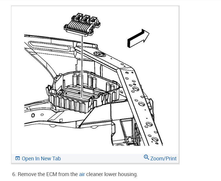

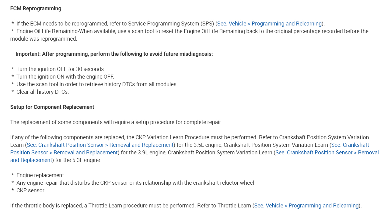

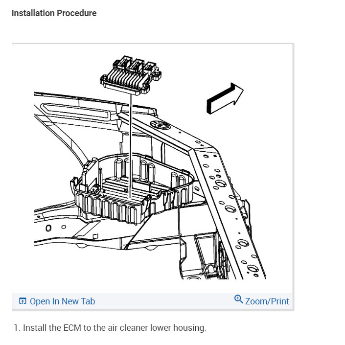

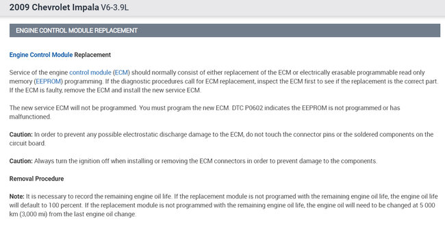

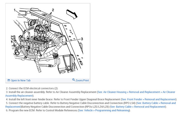

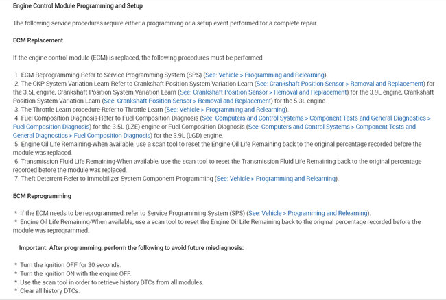

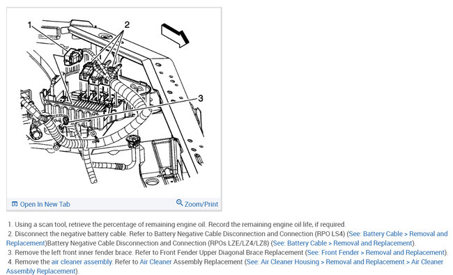

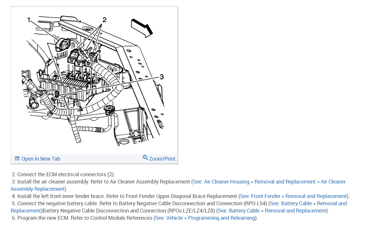

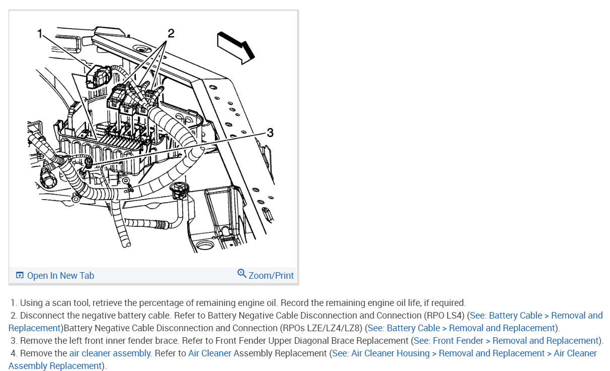

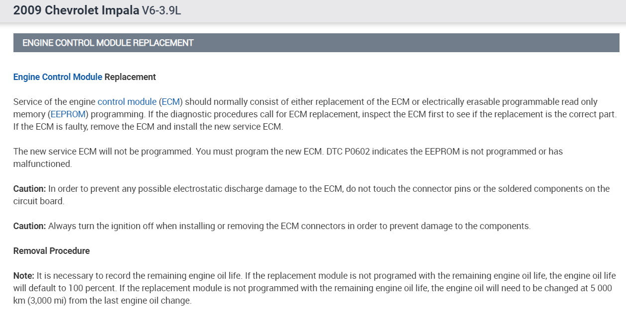

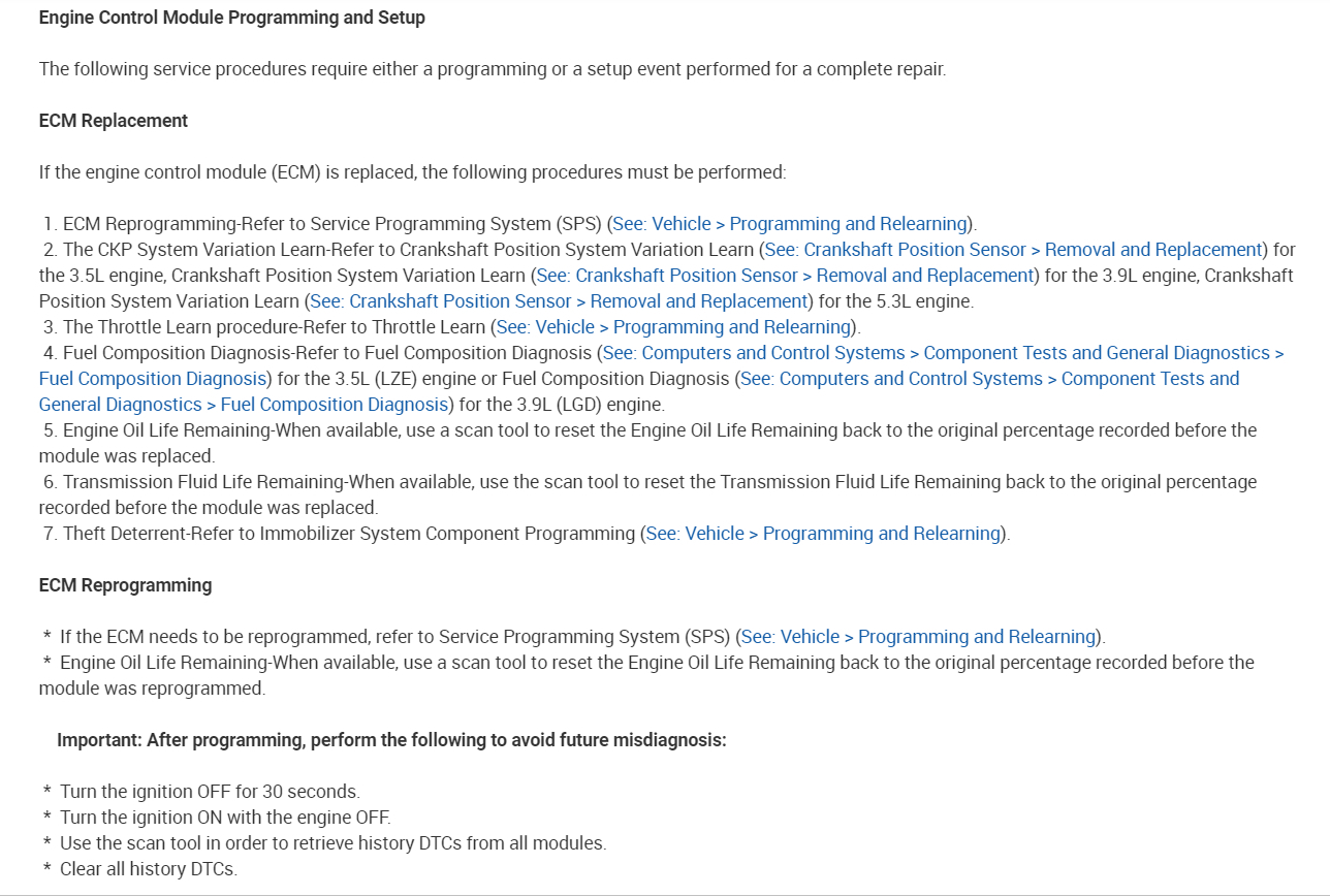

The code P2138 - throttle body position sensor and accelerator pedal position sensor do not match. When you say the accelerator pedal do you mean the accelerator pedal sensor? Also were they new parts? If so, you may have a PCM going out which can cause these codes as well. Here is how to change out the PCM in the images below, you can get a rebuilt unit by searching Google or Ebay, have your VIN number ready. This should not be a wiring problem because the code is not a circuit error. The rebuilt PCM will come preprogrammed. Check out the images (below). Please let us know what happens. Also, you can remove the electrical connectors for the PCM and check them for corrosion.

If I get a PCM that isn't programmed, how do I program it?
Dec 14, 2022 at 8:29 AM
You will need a bidirectional scanner or have the rebuilder program it for you.
