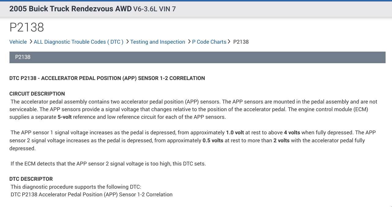

SCGRANTURISMO
CERTIFIED EXPERT
4,897 POSTS

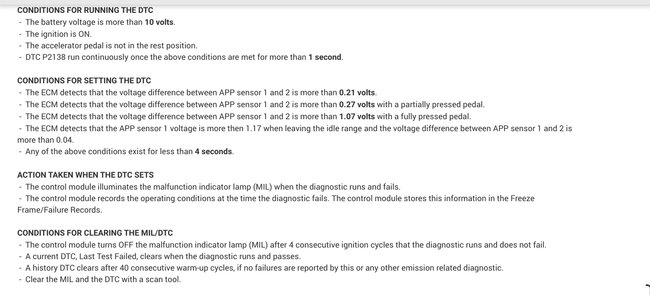

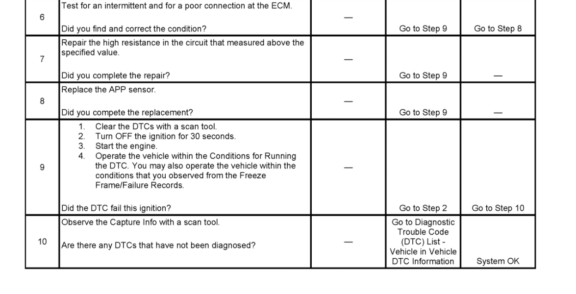

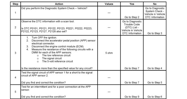

In the diagrams down below I have included the diagnostic troubleshooting guide from the vehicle manufacturer for Direct Trouble Code[DTC] P2138 for your vehicle. Please go through this guide and compare to what you did to fix the vehicle, and get back to us with what you find out. Happy New Year.
