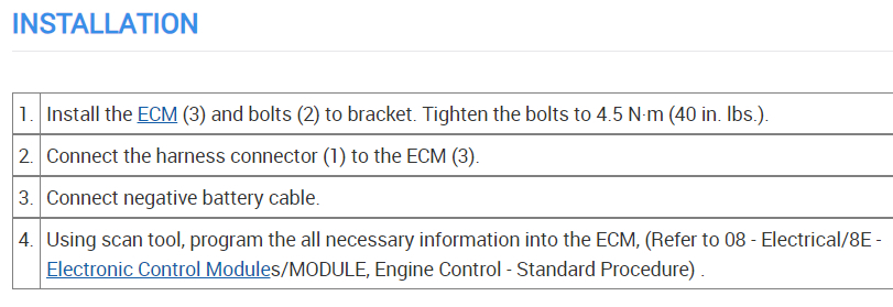

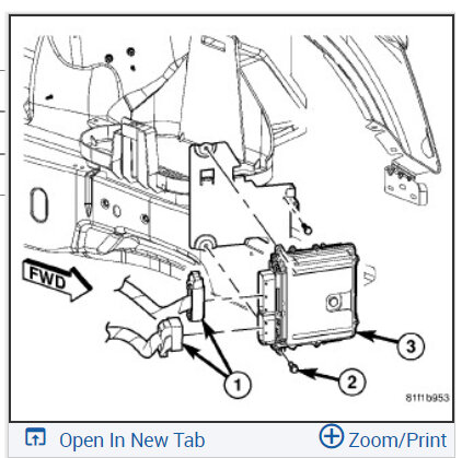

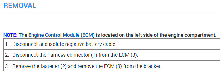

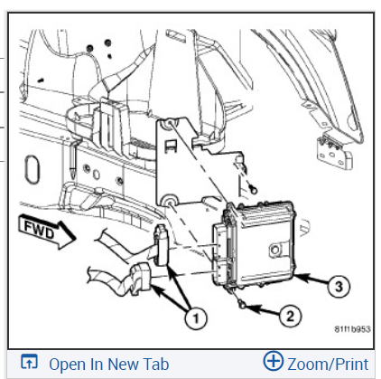

Shorted wiring at the injectors or shorted injectors can cause the other codes as well but if the injectors test good and the wiring is okay, I would remove the PCM and send it in for testing/rebuilding here is the location of the PCM so you can check it out. Check out the images (below). Please let us know what happens.
