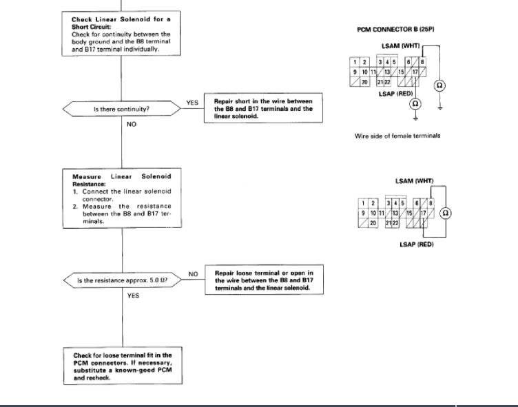

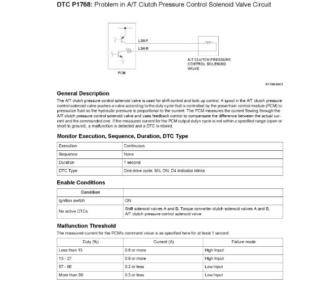

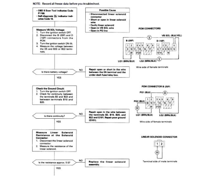

This is a code for the transmission. below is the possible failures.
Also, the flow chart is below for confirming the failure. too much here to try and give an opinion.
P1768
Descriptor
Probable Causes
Linear Solenoid
Linear Solenoid Connector Disconnected
Linear Solenoid Wire Open or Shorted
Open PG Line
VB SOL Wire Open
