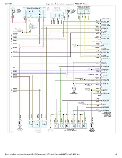

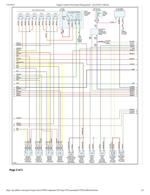

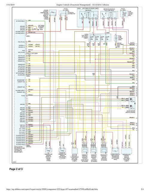

I have attached the wiring diagrams for your engine controls if you need them.
