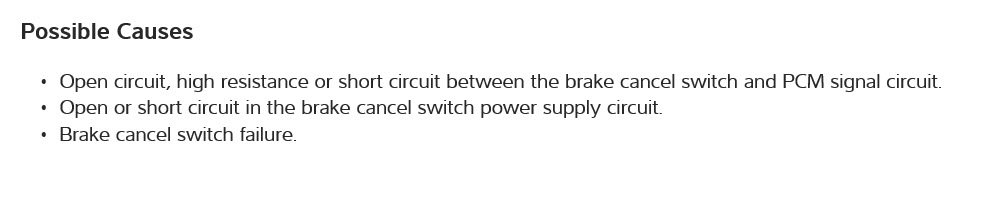

DTC code P1572 is brake pedal switch circuit malfunction.

it is a brake switch problem, but it also goes to the PCM so check for a shorted wire it is orange/yellow wire pin 25 on PCM. also check fuel pressure with a gauge auto parts rent it. and clean throttle plate on both sides and iac hole with choke cleaner. https://www.2carpros.com/articles/how-to-check-fuel-system-pressure-and-regulator
