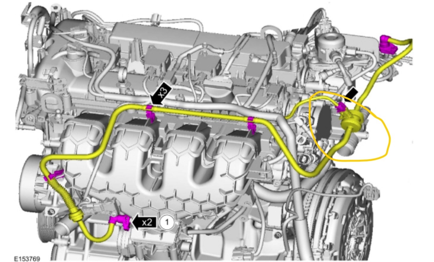

Because this is a turbo equipped vehicle the valve is the more likely failure item. To get to it you remove the trim cover from the engine, then the air intake tube and you will see where the valve tubing goes across the engine. It is a simple R&R procedure.
