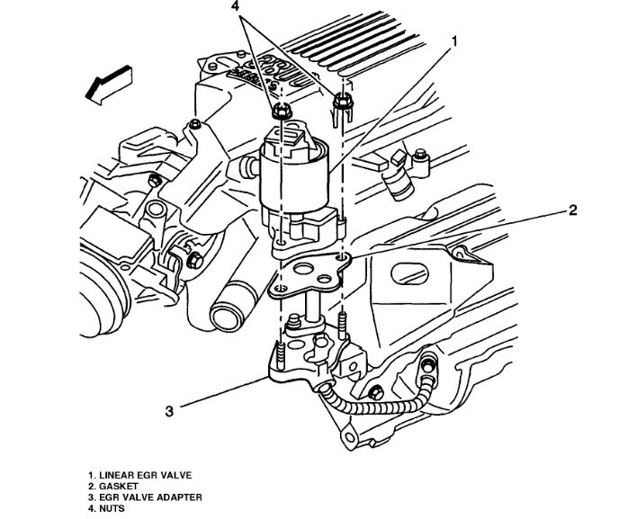

Good afternoon,
The most common issue for this is the EGR valve has carbon on the end of it not allowing to close fully.
Description below.
CIRCUIT DESCRIPTION
The PCM monitors the EGR valve pintle position input to ensure that the valve responds properly to commands from the PCM and to detect a fault if the pintle position sensor and control circuits are open or shorted. If the PCM detects a pintle position signal voltage outside the normal range of the pintle position sensor, or a signal voltage that is not within a tolerance considered acceptable for proper EGR system operation, the PCM will set DTC P1406.

No. The code is not for any of those issues.
