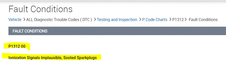

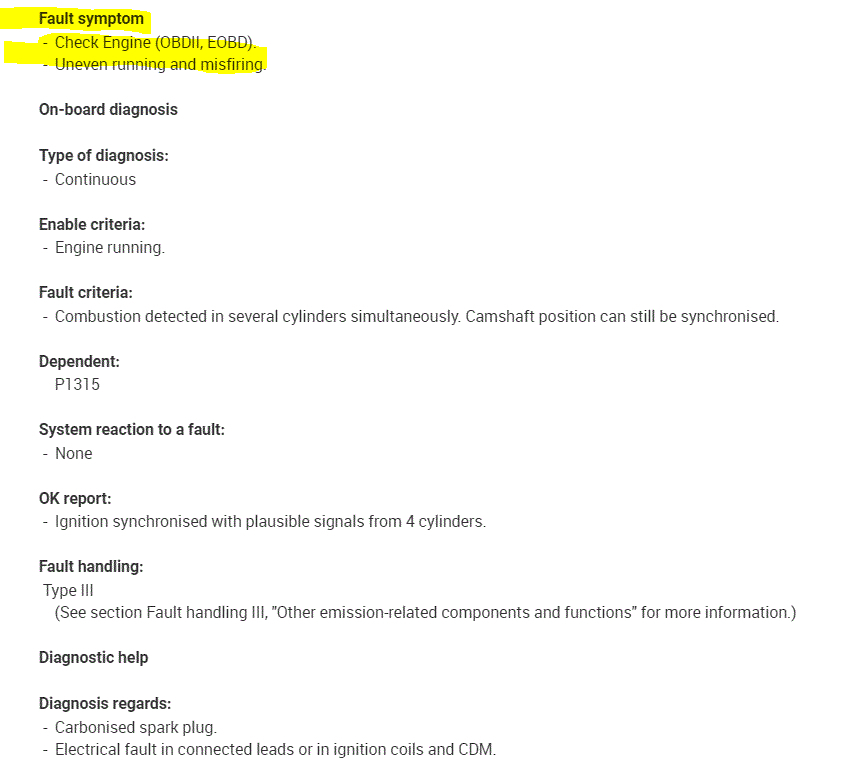

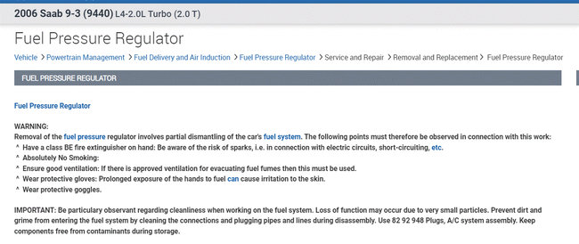

The code you have isn't related to the fuel pressure regulator. Take a look at pics 1 and 2 below.

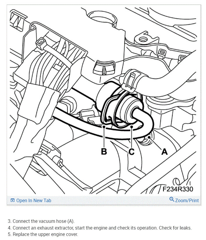

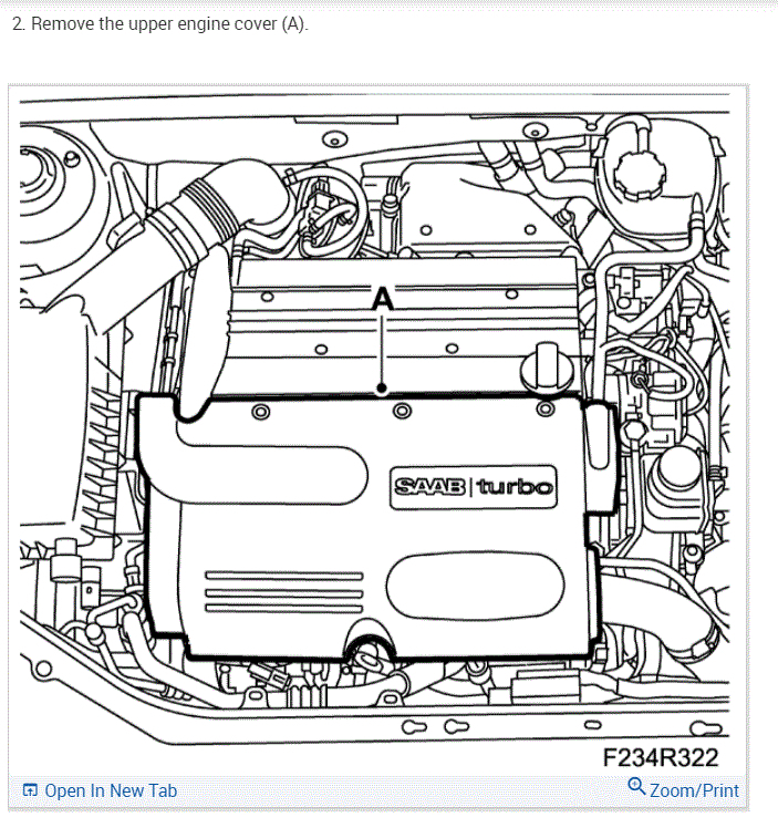

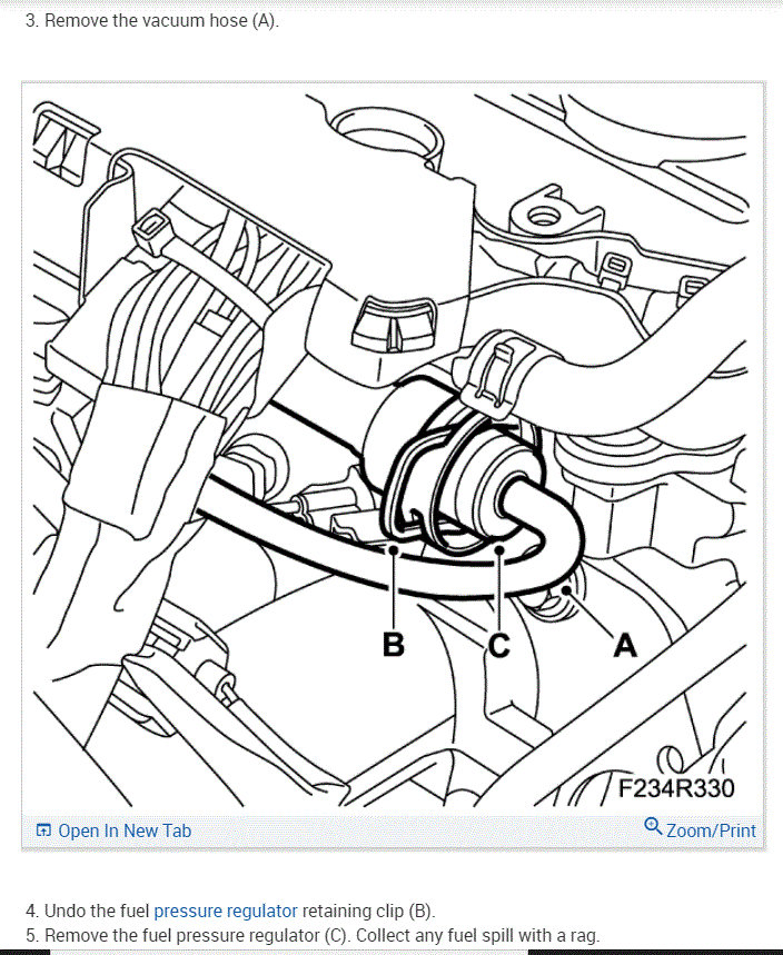

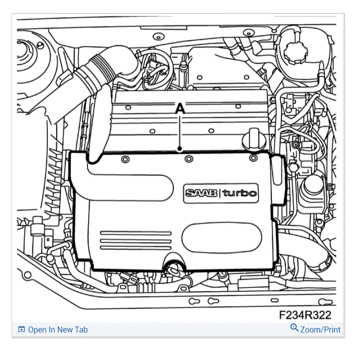

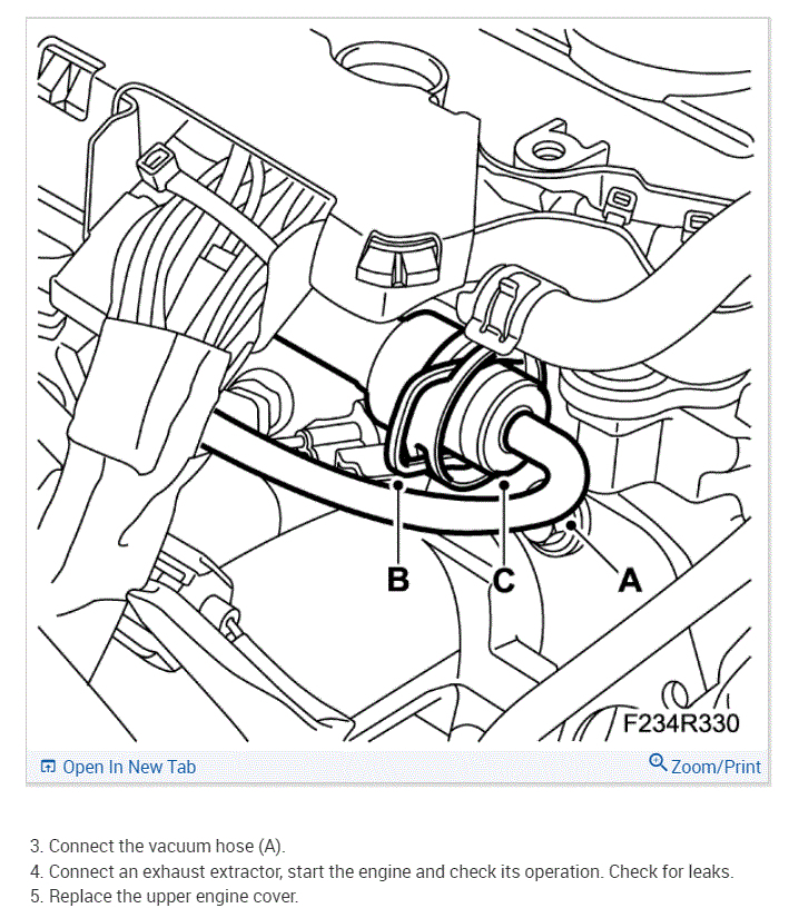

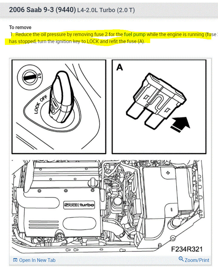

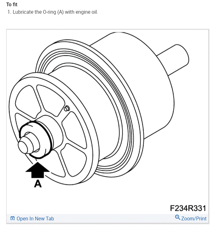

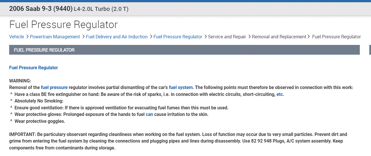

As far as the fuel pressure regulator, I attached the directions below for removal and replacement starting with pic 3.

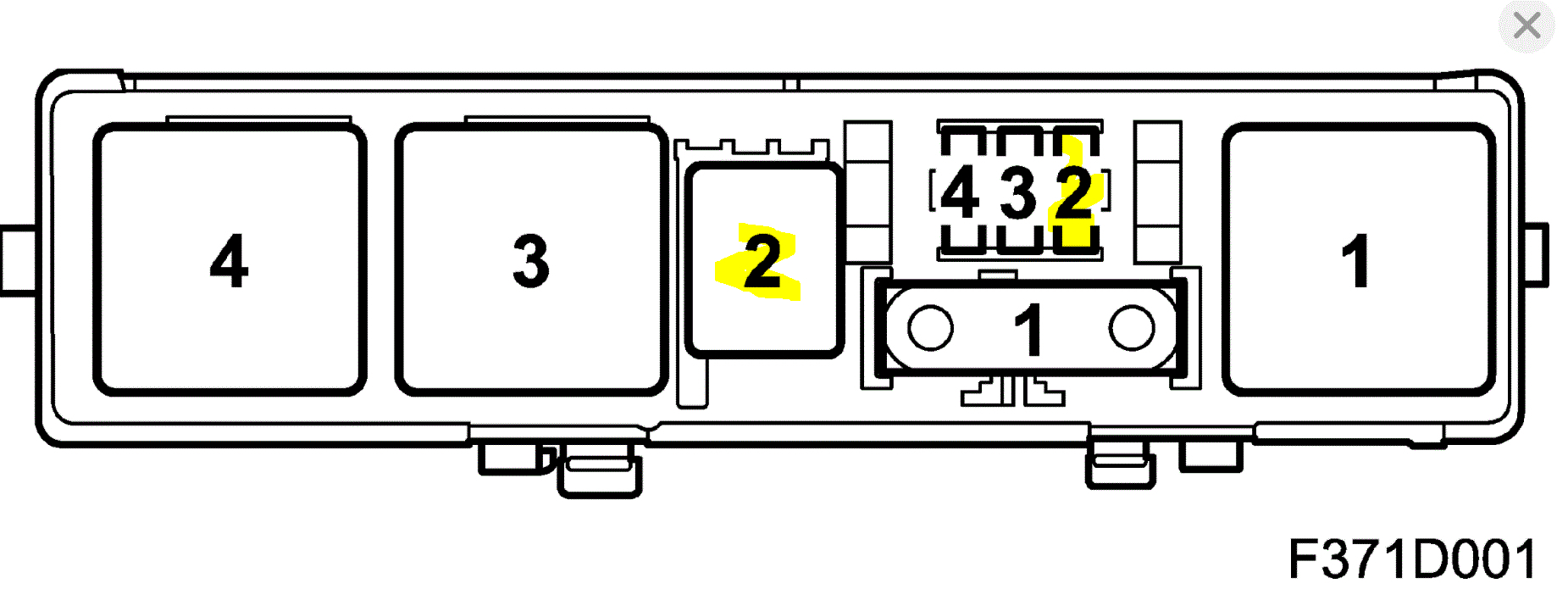

If you look at the last pic, it shows the main fuse box in front of the battery. According to the manual, it's fuse 2.
Also, I read through the directions for regulator replacement and there is a typo. It says to lower oil pressure, remove the fuse. I believe they meant to lower fuse pressure.
Once the fuse is removed, start the engine and within a very short time, it will stall due to lack of fuel. Turn the key off and proceed with the directions.
I hope this helps. Let me know how things turn out or if you have other questions.
