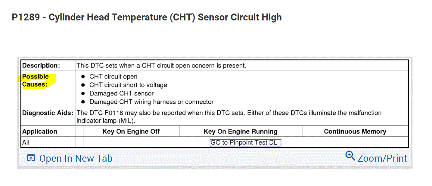

Code P1289
2015 FORD EXPLORER
100,000 MILES • 3.5L • 6 CYL • 4WD • AUTOMATIC
ALEXGG
I got a message in my board, it says "engine coolant overtemperature" and the check engine light is on" but my car is was all the night in the garage, so i did not thing the temperature is an issue. i got the computer code P1289 "cylinder head temperature sensor circuit high input". i guess it is the sensor. my question is, i am right? or can be another stuff, where is located the sensor? i tried to search in your web page but i did not find the info.
my vehicle lsited above is the Limited model with a v6, 3.5.
Thanks.
Oct 28, 2020 at 5:15 PM
If the engine was cold and you got that code, either the sensor is bad or there is a wiring issue. If you look at the last pic below, it shows the possible causes.
We have two choices here. Chances are the sensor is bad, but if you want to be sure, I have the diagnostics for the system. It is very extensive. Here it is.
If you want to try replacing it, see directions after the diagnostics.

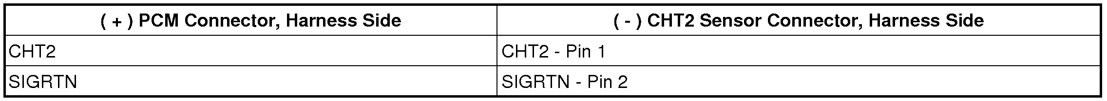

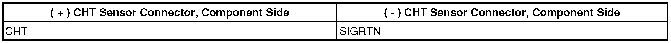

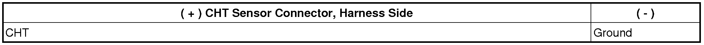

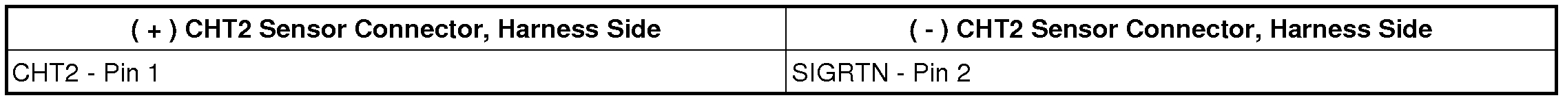

DL3 CHECK THE RESISTANCE OF THE CHT SENSOR WITH THE ENGINE OFF
Note:Refer to the chart at the beginning of this test for the resistance specifications.
- Ignition OFF.
- For the CHT2 sensor,
- CHT2 Sensor connector disconnected.
- Measure the resistance between:
pic 1
- For all others,
- CHT Sensor connector disconnected.
pic 2
Is the resistance within specification?
Yes
- GO to DL4
No
- INSTALL a new CHT sensor.
- REFER to the Service Information Section 303-14, Electronic Engine Controls.
- CLEAR the DTCs. REPEAT the self-test.

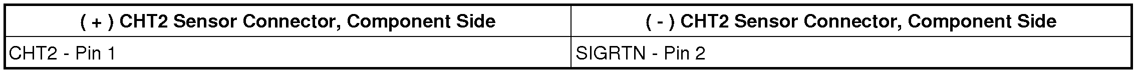

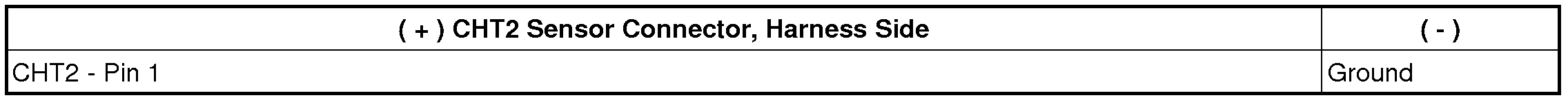

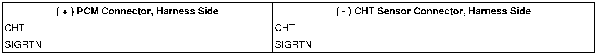

DL4 CHECK FOR AN OPEN CIRCUIT
- Ignition OFF.
- PCM connector disconnected.
pic 3
- For all others,
pic 4
Are the resistances less than 5 ohms?
Yes
- GO to DL5
No
- REPAIR the open circuit. Clear the PCM DTCs. REPEAT the self-test.

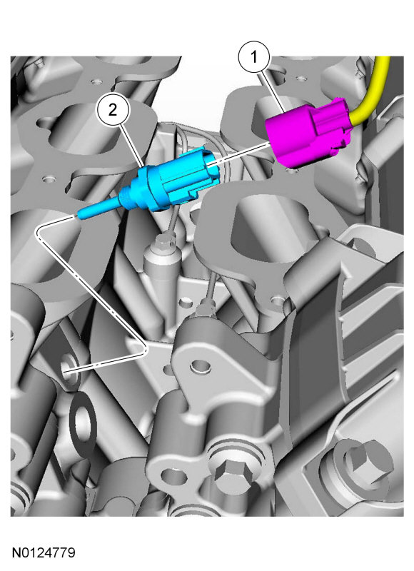

Here are the directions for replacement. Note: You must remove the lower intake manifold to access the sensor. I will provide the directions for manifold removal after this.
______________________
2015 Ford Truck Explorer 4WD V6-3.5L
Cylinder Head Temperature (CHT) Sensor - 3.5L Ti-VCT, 3.7L Ti-VCT
Repair Removal and Replacement Cylinder Head Temperature (CHT) Sensor - 3.5L Ti-VCT, Exploded View
pic 12
Item Service Part Number Description Tool Number Material Name Notes
1 - CHT sensor electrical connector (part of 12A581) - - -
2 6G004 CHT sensor - - 10 Nm (89 lb-in)

Fill and bleed the cooling system. REFER to Section 303-03, Cooling System Draining, Filling and Bleeding .
__________________________
I hope this helps. Let me know if you have other questions.
