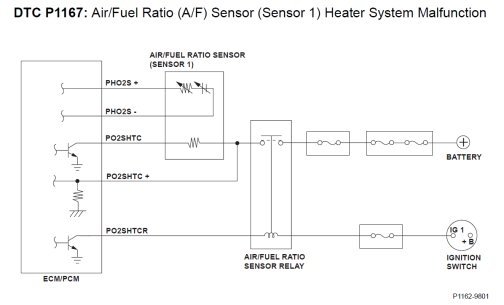

The code is related to the heater on the air/fuel sensor. When you say you replaced the one on the block, are you referring to the one on the exhaust manifold?
If so, check to make sure the wiring to it isn't damaged. Also, confirm the pins in the plug are not pushed, corroded, or damaged in any way.

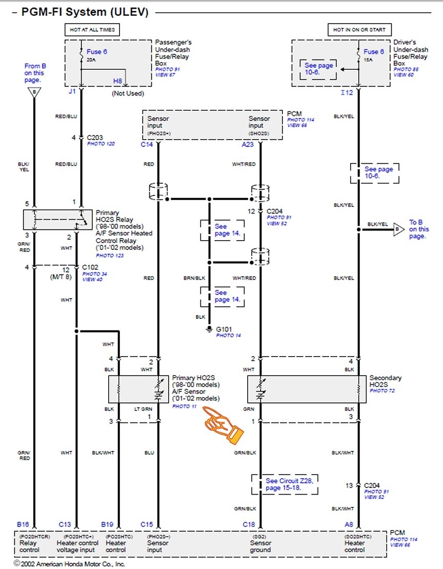

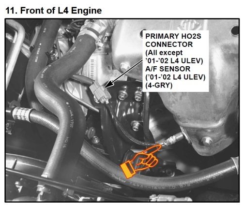

I did a little research and found the following information (TSB) related to this issue. Take a look through it and let me know if it helps. The attached pics correlate with the directions.
MIL reported on with code P1167
Jeff Campbell-
11/26/2014 | 13:05:55
ALLDATA Diagnostic Bulletin
RELATED VEHICLES: 1998-2002 Accord 2.3L SOHC
SUMMARY: P1167-A/F Sensor (Sensor 1) Heater System Malfunction; A heater for the sensor element is embedded in the air/fuel ratio (A/F) sensor (sensor 1) and is controlled by the engine control module (ECM)/powertrain control module (PCM). It is activated and heats the sensor to stabilize and speed the detection of oxygen content when the exhaust gas temperature is cold. The sensor cell resistance decreases as its temperature increases. If the sensor cell resistance is not less than a set value after the lapse of a specified time period since the heater is turned on, a malfunction is detected and a DTC is stored and the MIL is illuminated.
See pic 1

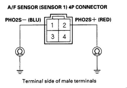

3. Ignition "OFF", disconnect the A/F Sensor 4P connector, and ECM/PCM connector C (31P).

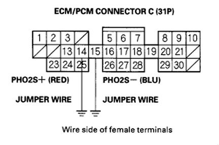

4. Connect ECM/PCM connector terminals C14 and C15 to body ground with a jumper wire.
See pic 2

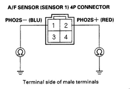

5. Check for continuity between A/F Sensor (Sensor 1) 4P connector terminal No.1, No.2, and body ground individually.
See pic 3
If you have continuity, replace the A/F ratio sensor
If you do not have continuity, check the wiring and connectors for damage, an open or short and remedy as necessary.

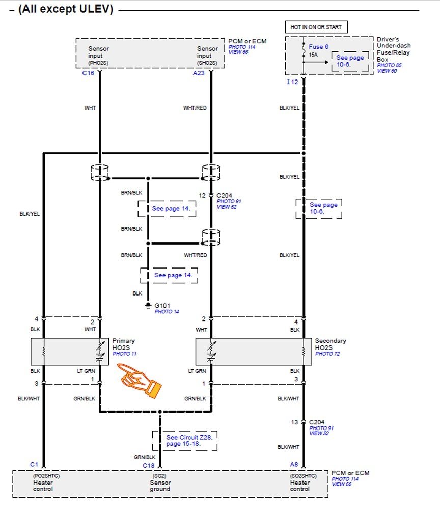

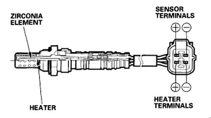

See remaining pics for schematics.

Hi nelson425a, So you have replaced the sensor. DTC P1167: A/F SENSOR (SENSOR 1) HEATER SYSTEM MALFUNCTION NOTE: If DTC P1162 is stored at the same time as DTC P1167, troubleshoot DTC P1162 first, then troubleshoot DTC P1167. 1. Reset the ECM/PCM 2. Start the engine. Wait for at least 80 seconds. Is DTC P01167 indicated? YES - Go to step 3. NO - Intermittent failure, system is OK at this time. Check for poor connections or loose wires at C102 (located under the under-hood fuse/relay box), the A/F Sensor relay, the A/F Sensor (Sensor 1), and the ECM/PCM. 3. Disconnect the A/F Sensor 4P connector, and ECM/PCM connector C (31P). 4. Connect ECM/PCM connector terminals C14 and C15 to body ground with a jumper wire.
https://www.2carpros.com/forum/automotive_pictures/192750_DTCP1167Accord01_1.jpg
5. Check for continuity between A/F Sensor (Sensor 1) 4P connector terminal No. 1, No. 2, and body ground individually.
https://www.2carpros.com/forum/automotive_pictures/192750_DTCP1167Accord02_1.jpg
Is there continuity? YES - Replace the A/F Sensor (Sensor 1) (see Primary HO2S & A/F Sensor Replacement ). NO - Repair open or short in the wire between the A/F Sensor (Sensor 1) and the ECM/PCM (C14 or C15).
