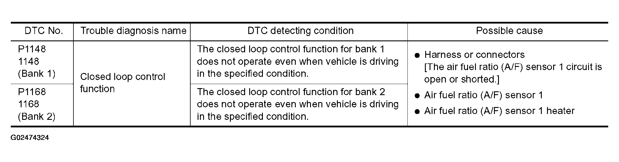

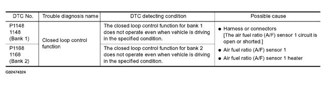

This code is for the number one air/fuel sensor (front oxygen sensor before the catalytic converter). It either has gone bad or the wiring to it has broken causing an open circuit. Do a quick visual inspection to see if there are any wiring problems.
