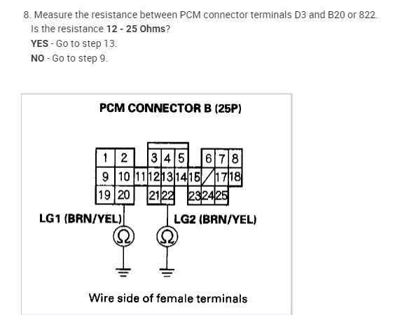

My check engine light came on and d5 light started flashing yesterday. No prior issues. The car has resistance in D3, D4, D5. Drives fine in 1-2 or reverse. Took solenoid C out, it reads 16 ohms. Transmission fluid Selma to be fine as well. Not sure what to do next.
Jul 17, 2023 at 4:36 PM

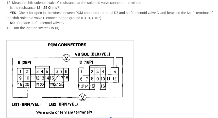

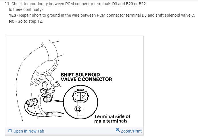

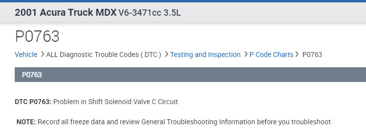

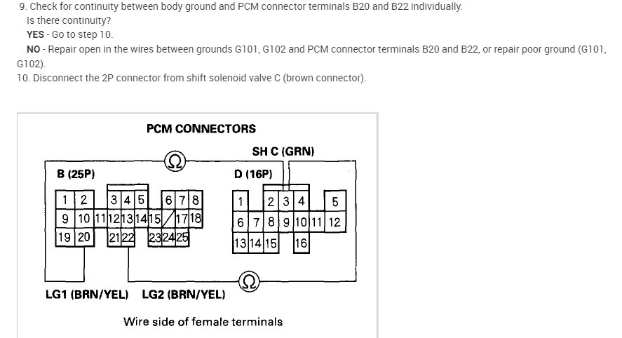

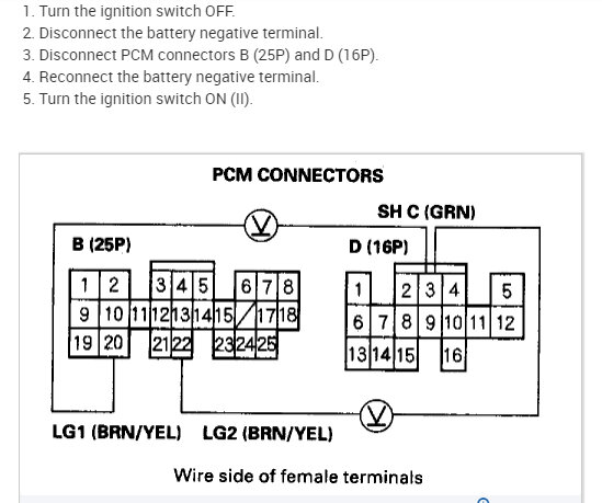

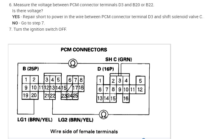

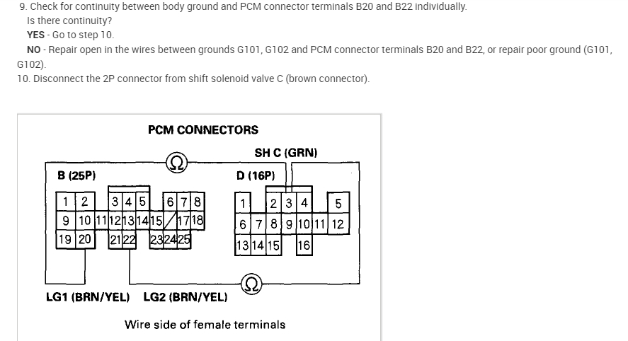

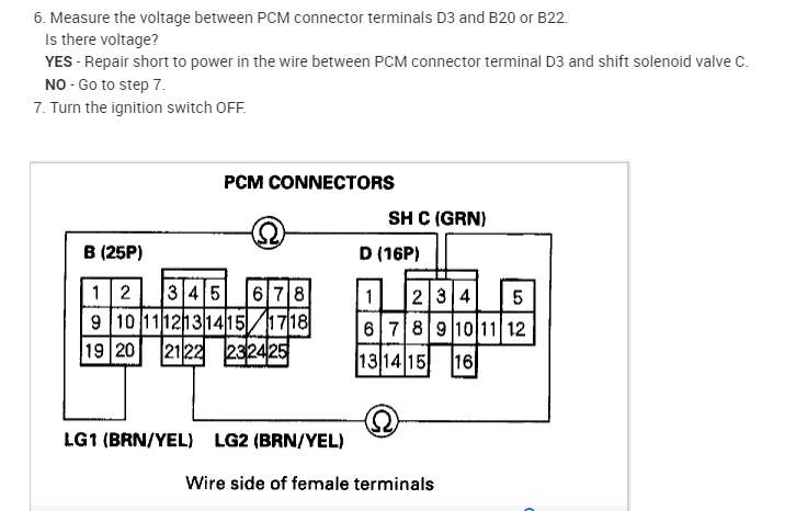

If that is the only code present, we need to check wiring issues. As far as the code is concerned, I attached the diagnostics below specific to this code.
Take a look through the diagnostics and let me know if you are comfortable performing them.
joe
See pics below.
