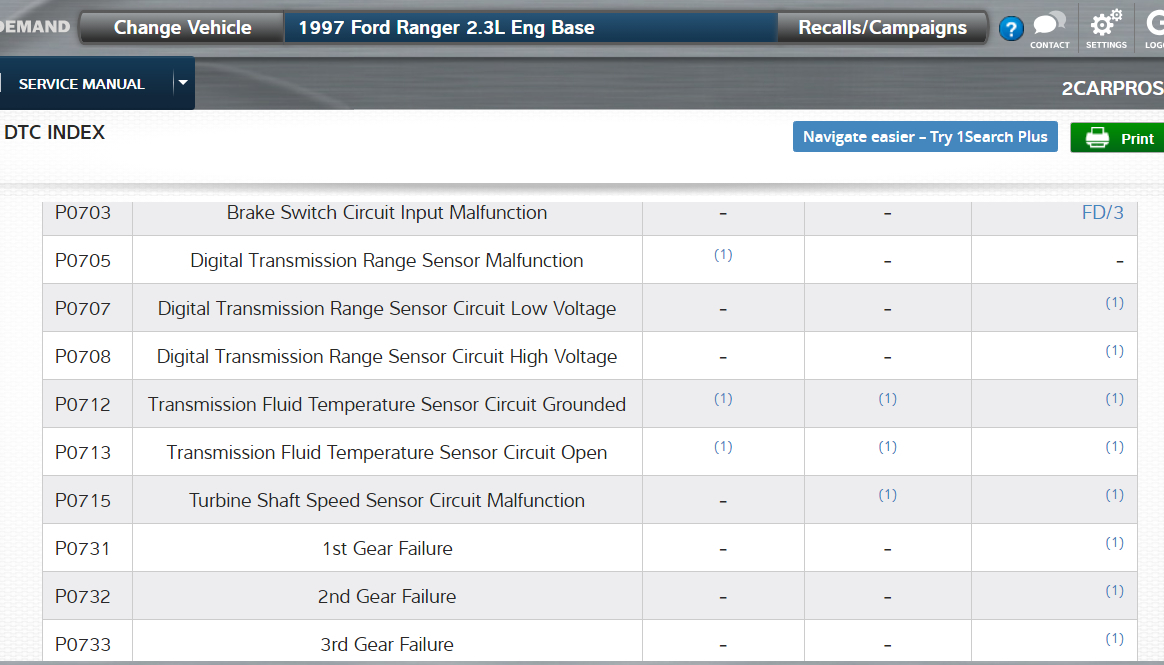

I show no Direct Trouble Code(DTC) P0709 for a 1997 Ford Ranger 2.3L 2WD Automatic Transmission Pickup in either Alldata or Mitchell 1. Are you sure you have got the Dtc # correct?
Thanks,
Alex
2CarPros
Apr 9, 2019 at 7:48 PM
LUDOO2818
  • 4 POSTS
Yes, positive.
Apr 10, 2019 at 4:41 AM
SCGRANTURISMO
  • 4,897 POSTS

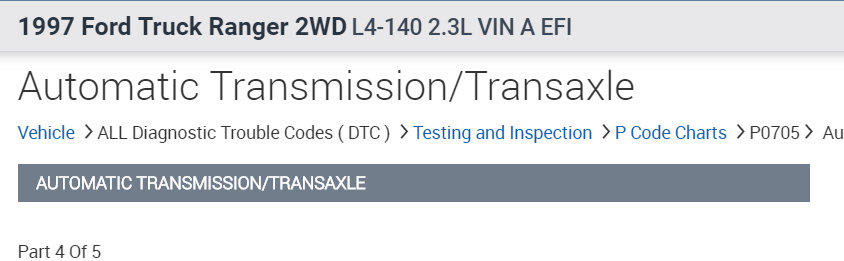

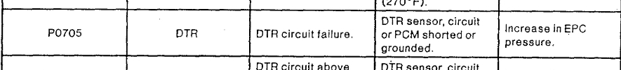

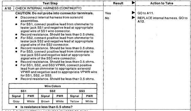

Hello again,

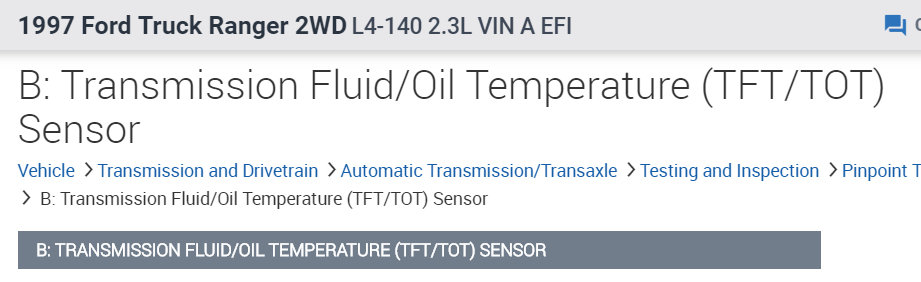

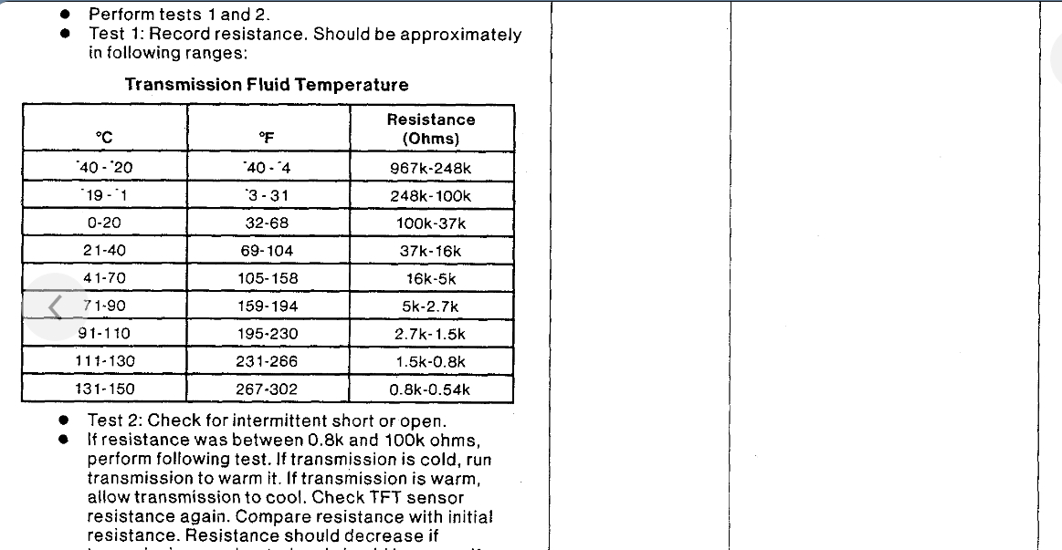

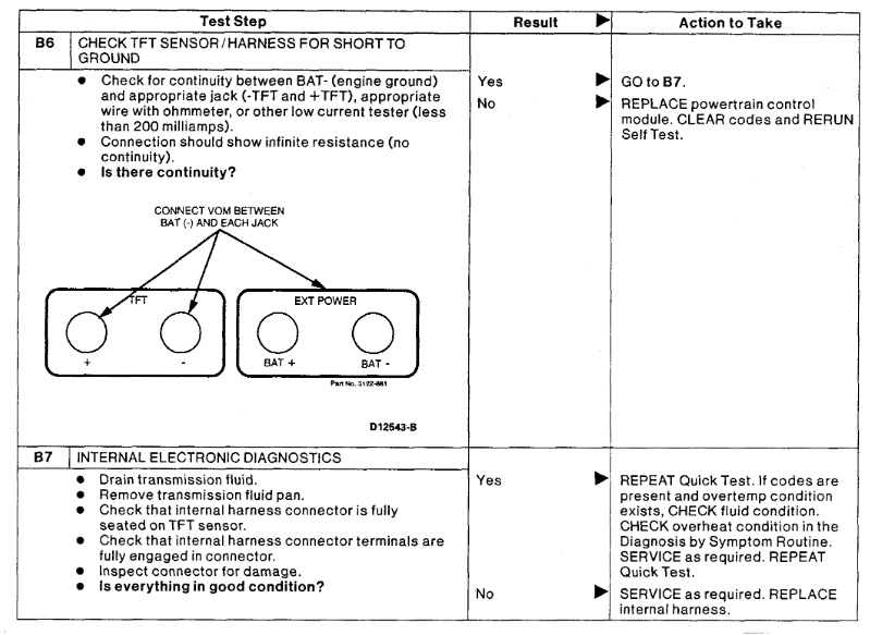

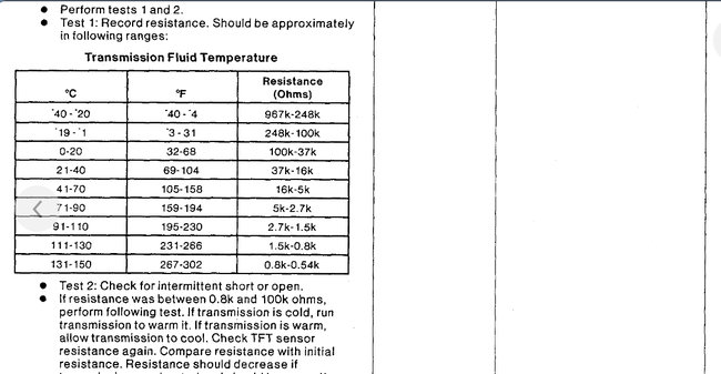

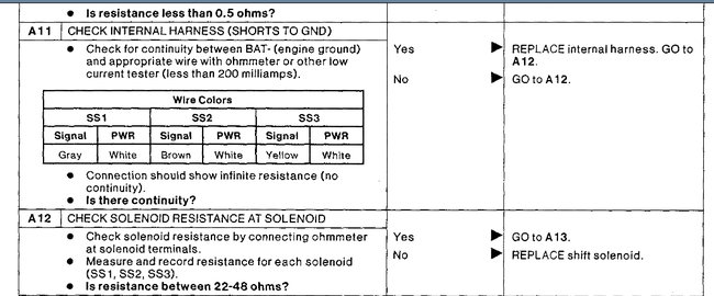

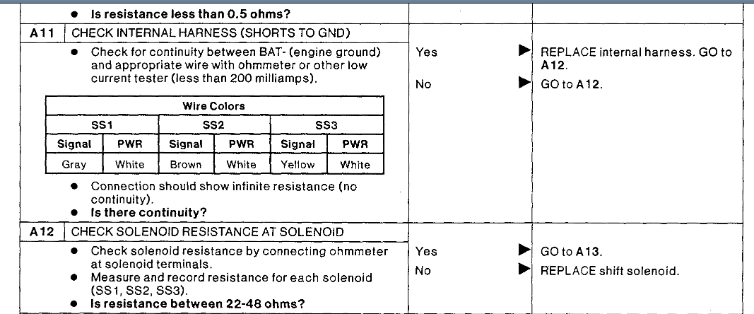

I have included in the diagrams down below the Direct Trouble Code (DTC) list from The Ford Motor Company for your vehicle from DTC P0703 - DTC P0733. I do not show DTC P0709. Please double check for me again. I would love to help, but if I don't know what's wrong, I can't fix it.
Thanks,
Alex

It's P0705.

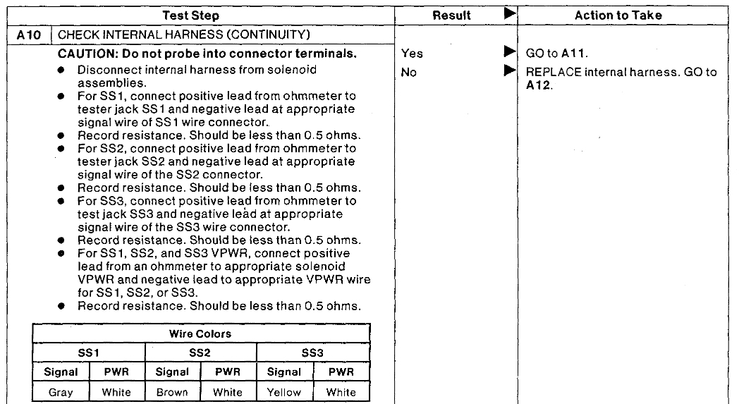

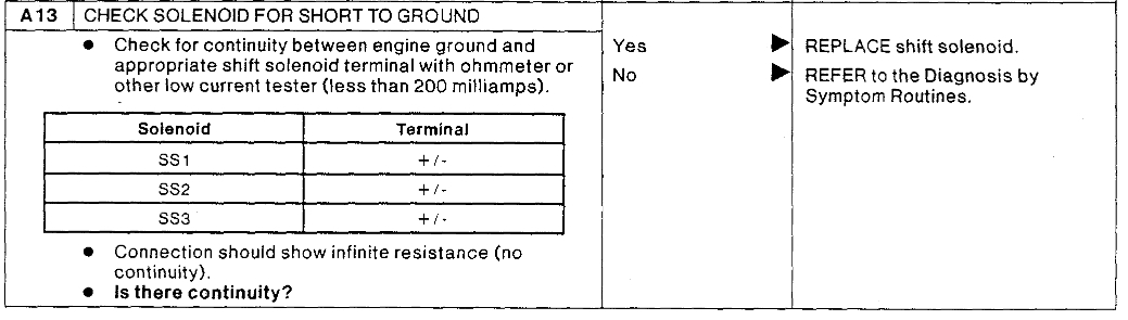

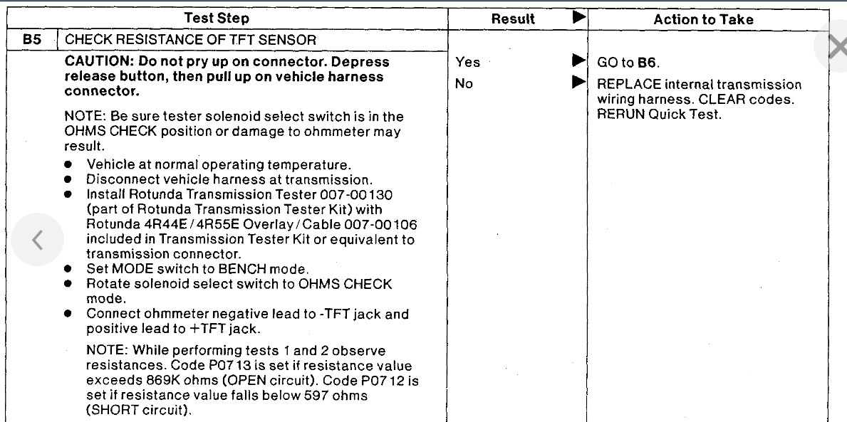

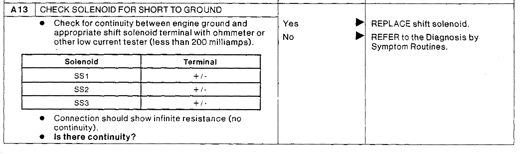

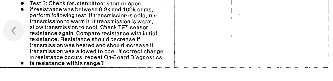

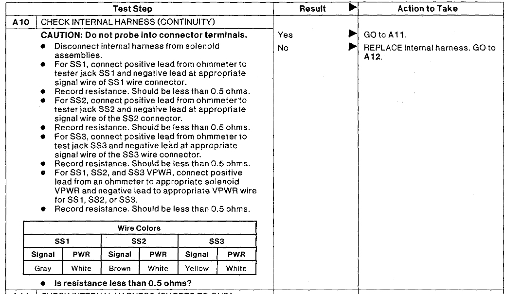

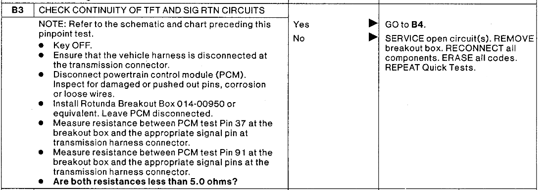

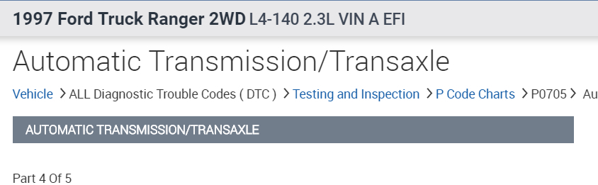

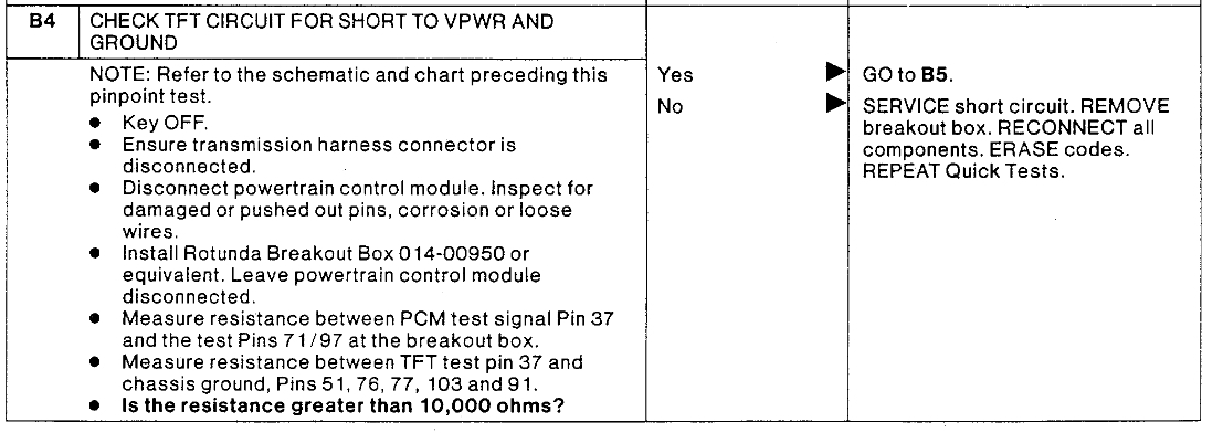

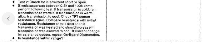

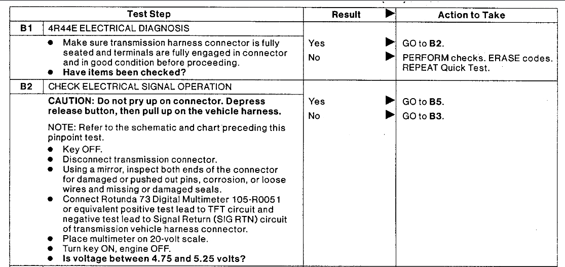

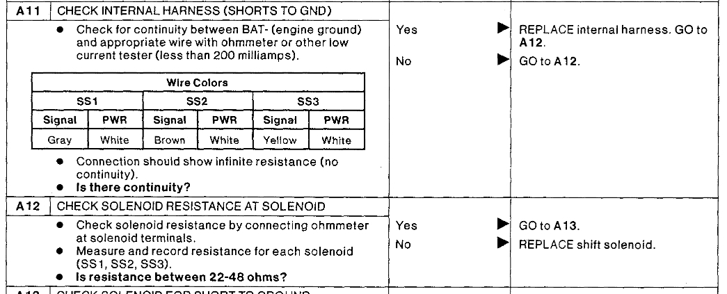

I have included in the diagrams down below the Ford factory diagnostic troubleshooting flowchart for this DTC. Please go through this flowchart and get to us with what you are able to find out please.
Thanks,
Alex
