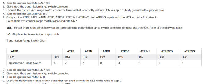

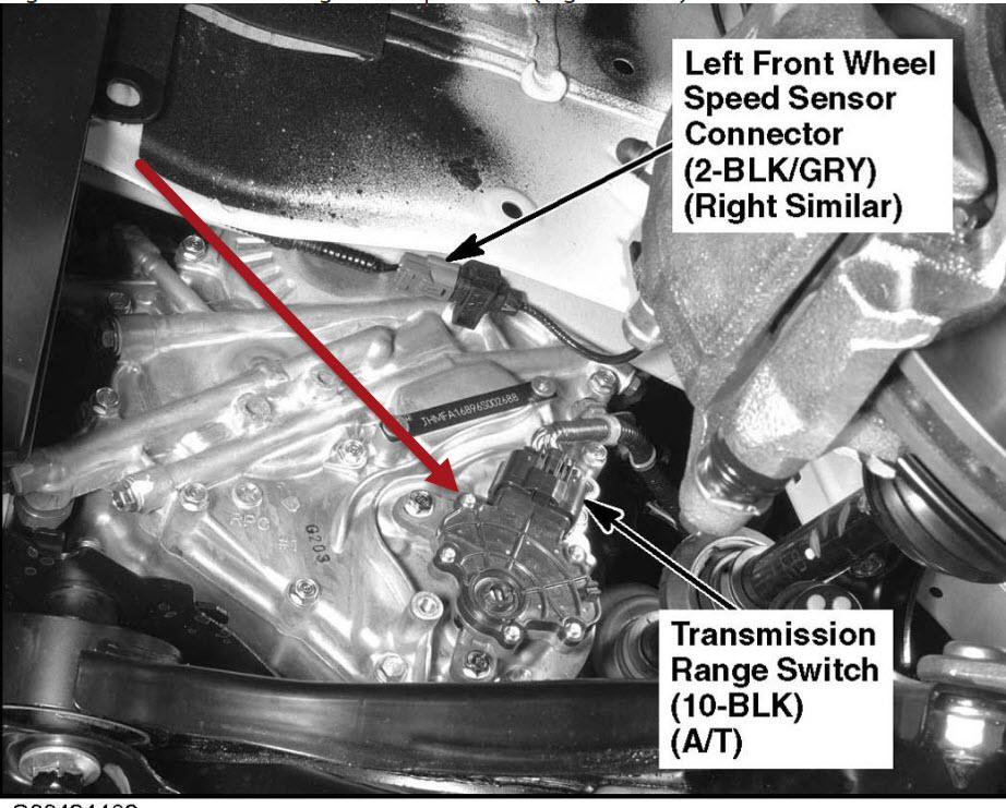

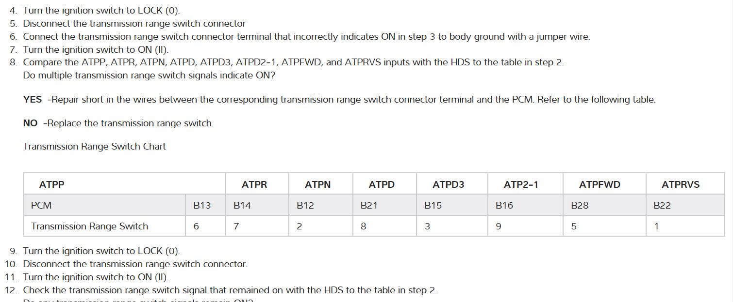

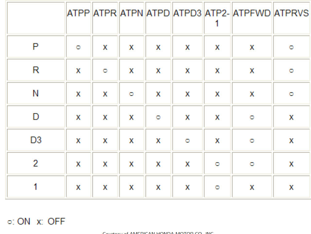

my car when its off and turn on after a moment the d light comes flashing and check engine is on with code p0705 . when car off and turn back on the d light is normal after a while the d lights flashes on and off i do feel that the trans feels weird when that happen but when the d light is normal the car runs perfect. check all connector for any short and nothing
