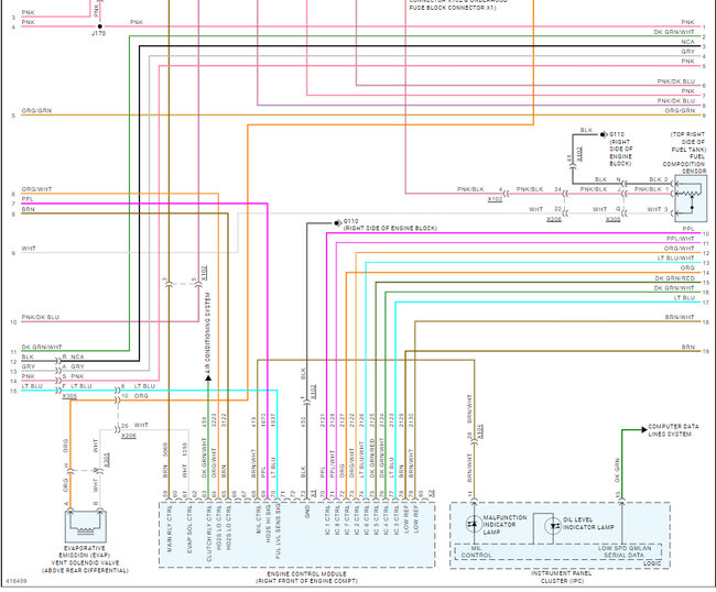

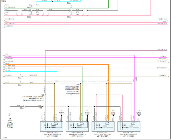

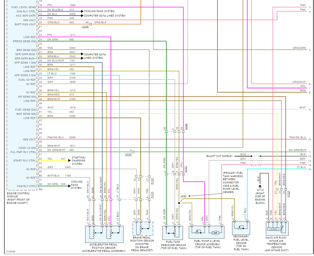

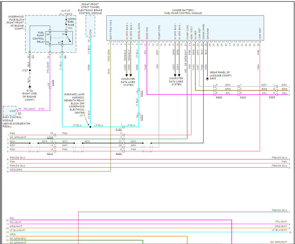

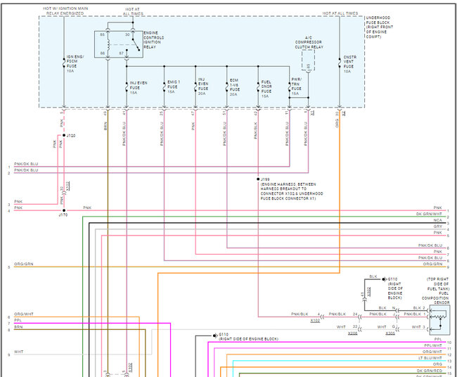

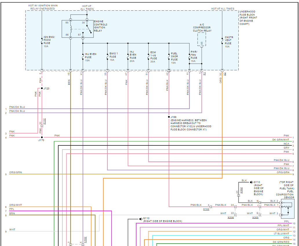

The P069E code indicates a problem with the fuel pump or its control module but since you replaced those already the problem will be in the wiring, or you have a blown fuse. I would start by checking the fuse "FSCM" 20 amp which is in the rear fuse panel and the IGN EGN FSCM fuse in the fuse panel under the hood.
This guide can help:
There is also a fuel pump control relay I would swap out as well which is in the fuse panel under the hood as well. Please check these out and get back to me, here is a guide to check the wiring and the fuel pump system wiring diagrams so you can see how the system works and which wires to test.
Check out the images (below). Let us know how it goes.

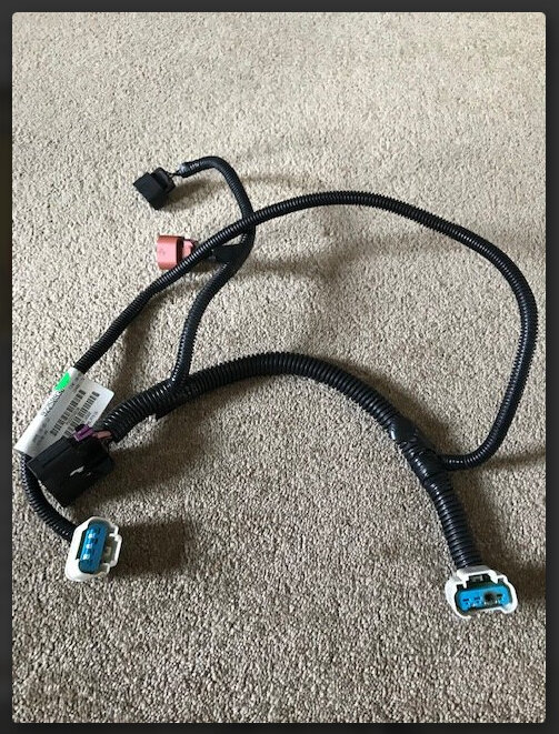

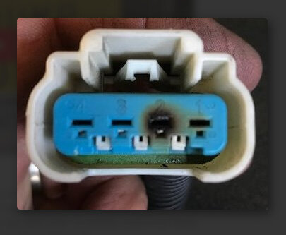

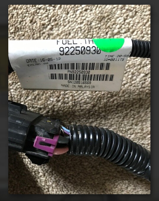

Have you checked the connector at the fuel pump for possible burnt pin 2?
See image below.
This seems to be a common problem. A replacement harness will need to be fitted if you find an issue.
