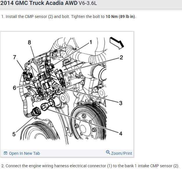

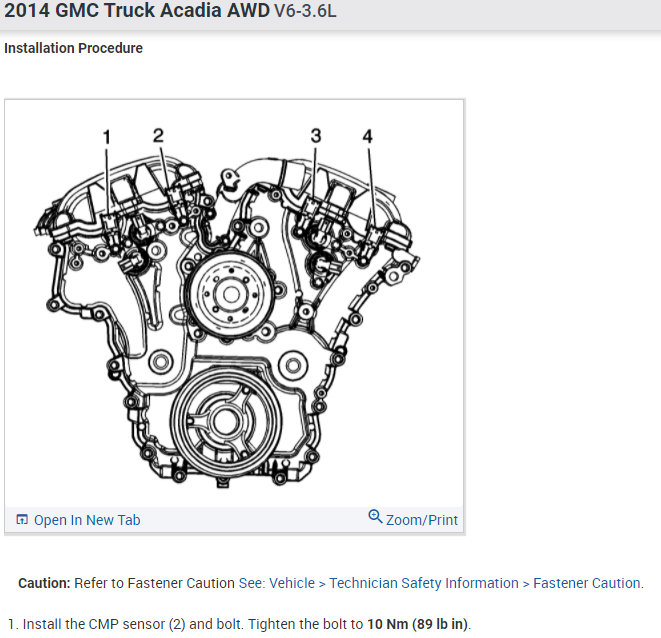

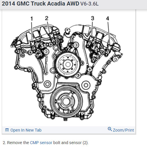

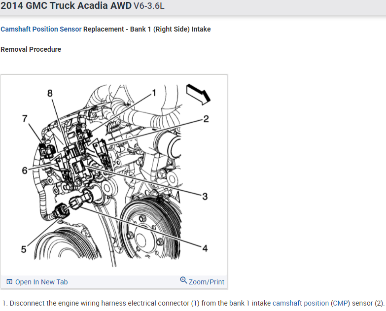

Cold start A camshaft position timing performance bank 1.
Where’s the location of this?

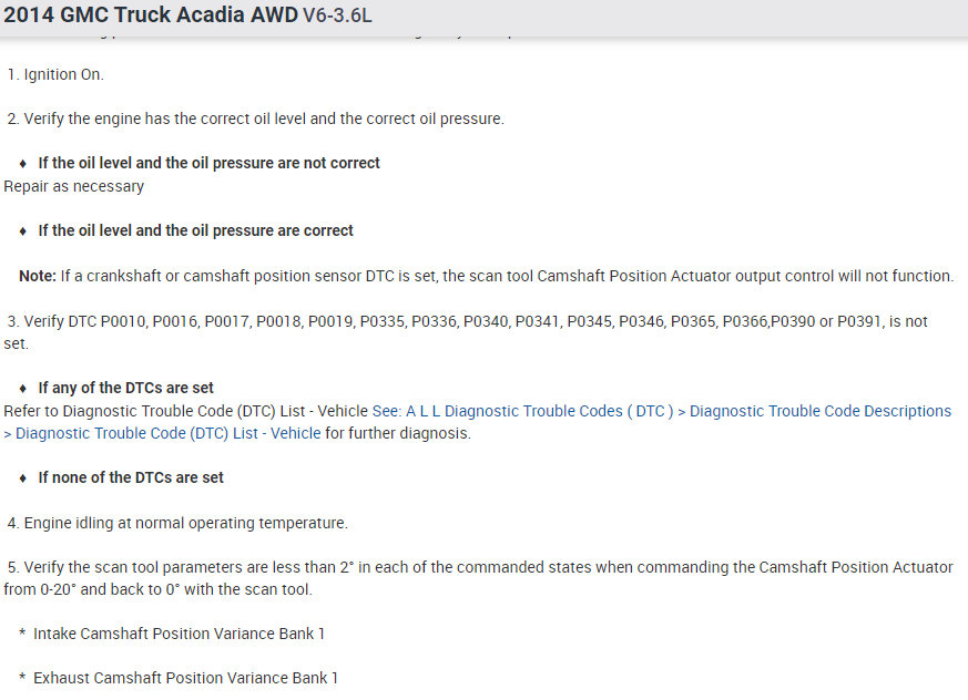

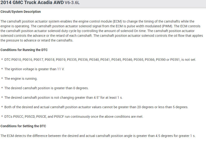

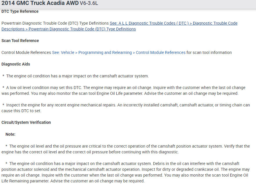

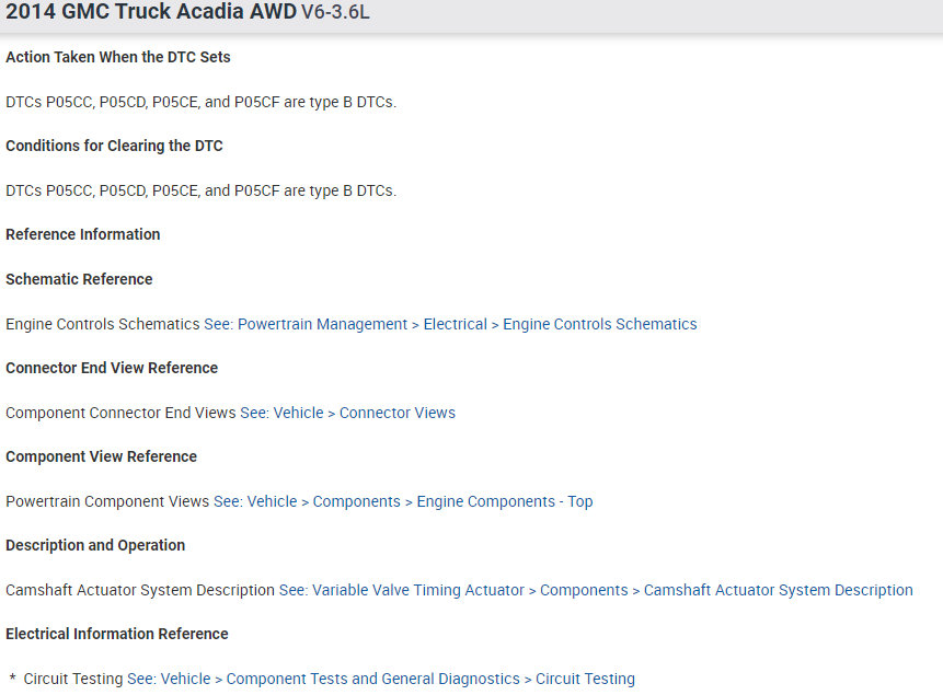

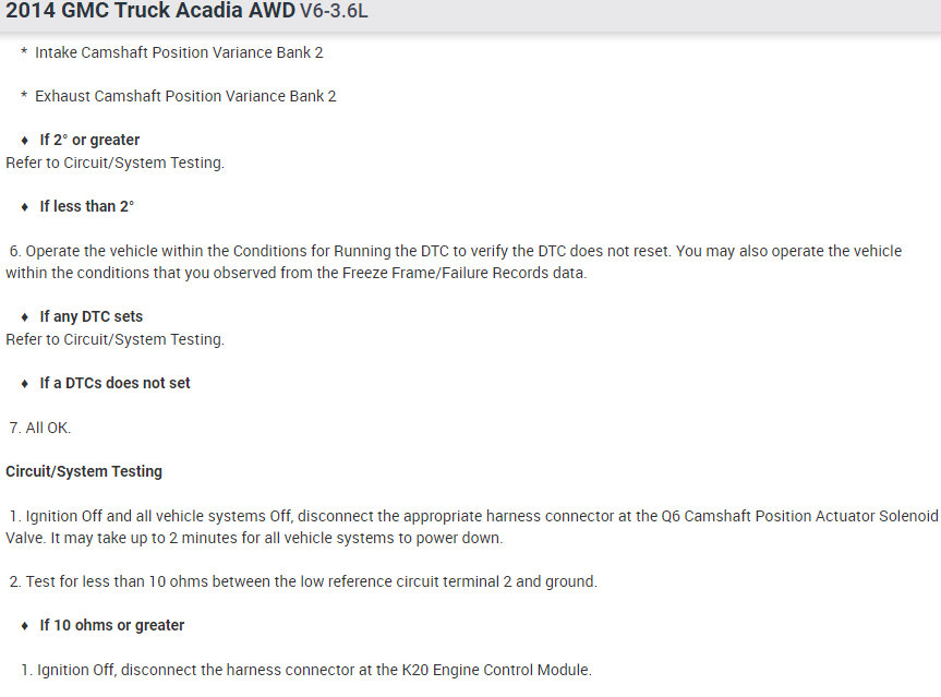

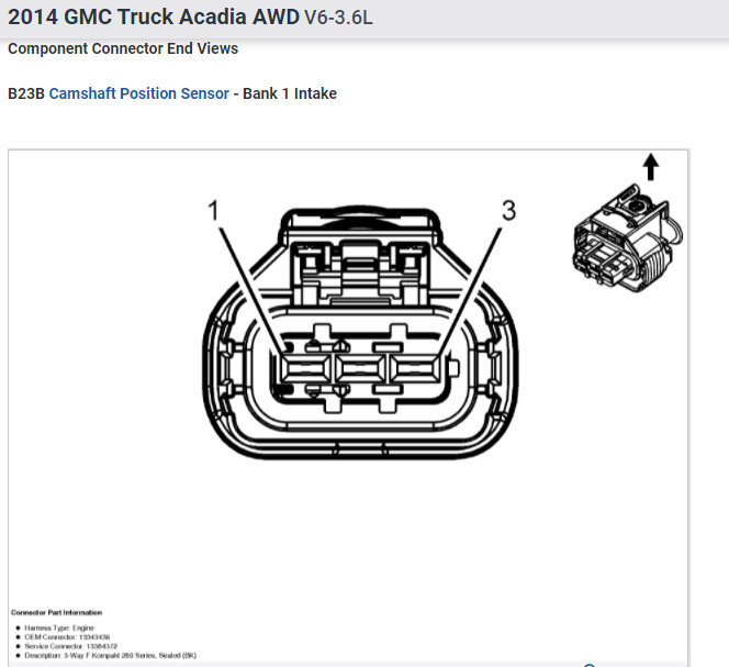

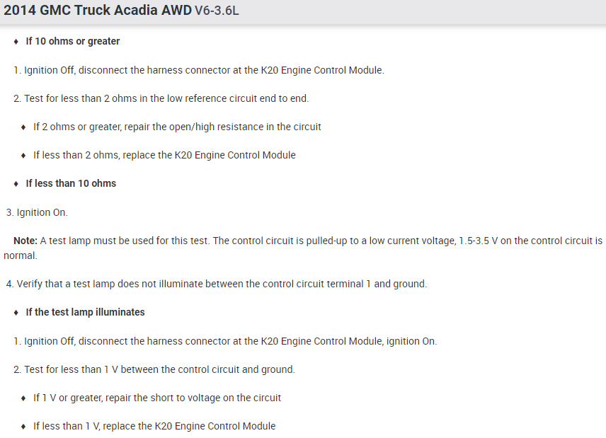

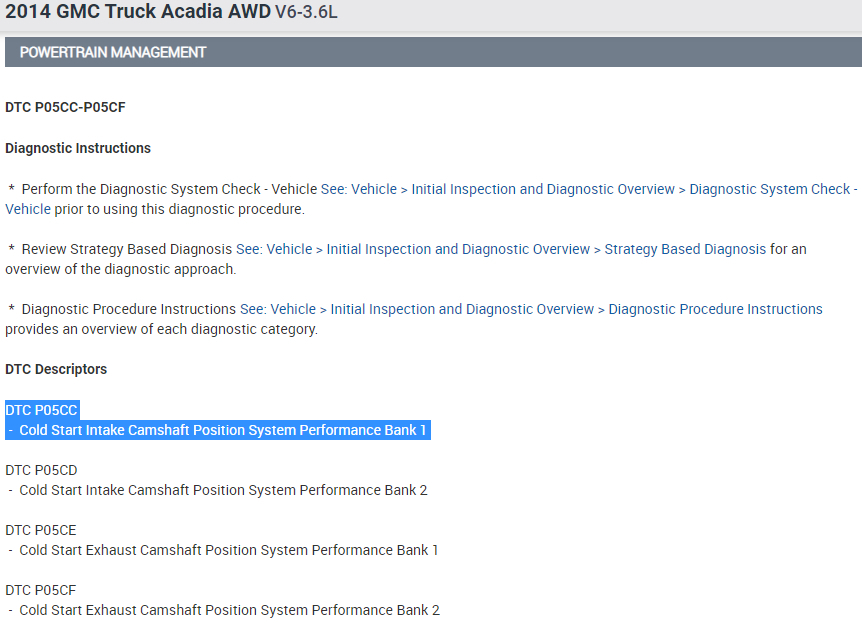

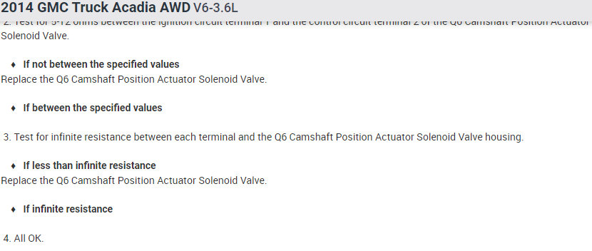

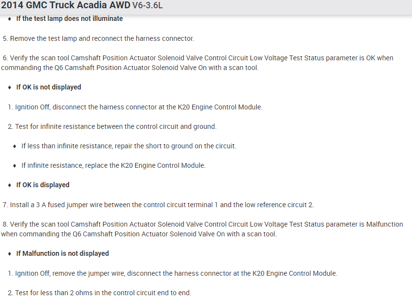

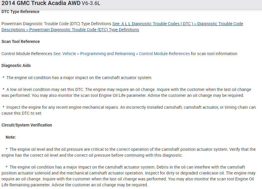

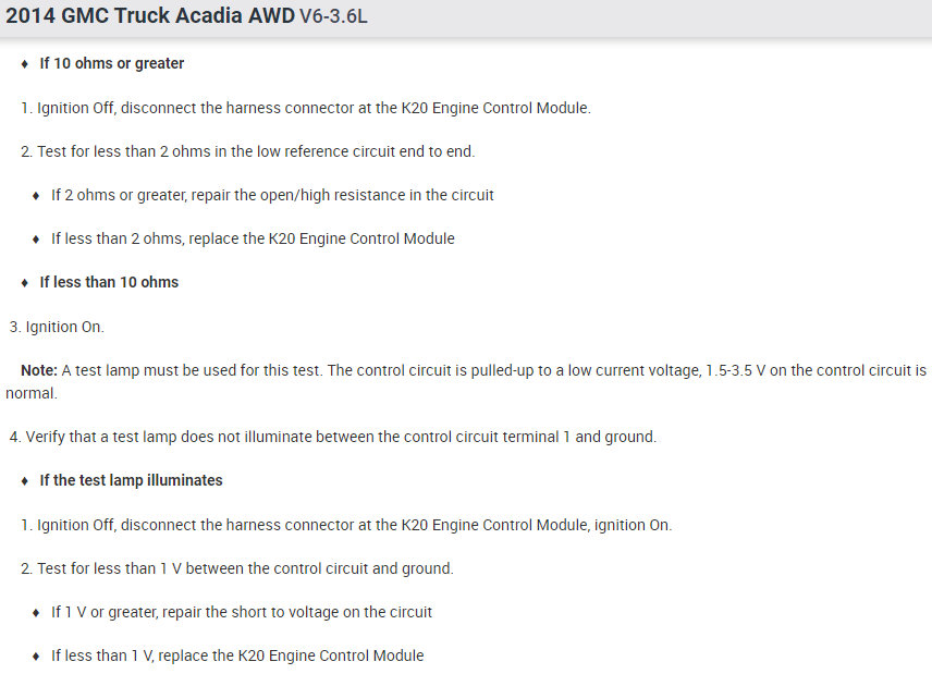

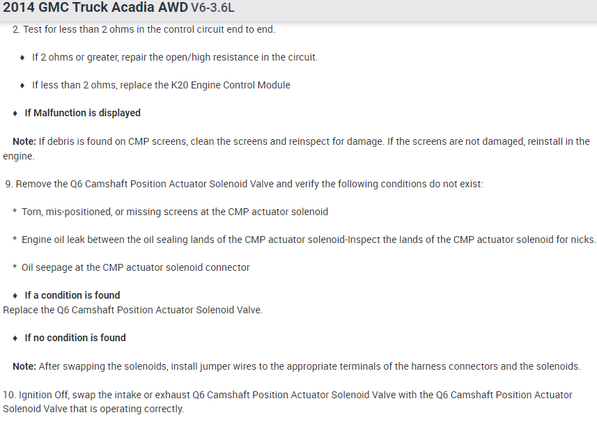

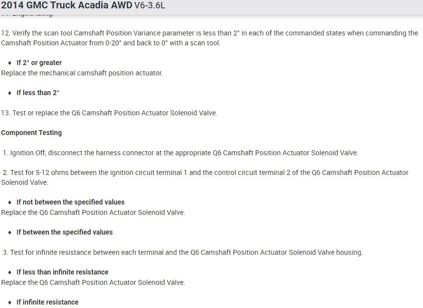

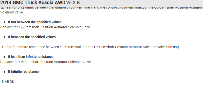

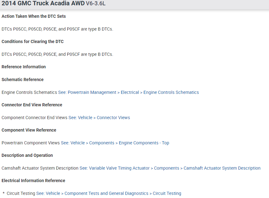

Here is a guide to help you step by step with instructions in the diagrams below to show you how on your car. I have attached the replacement procedure for the cam sensor as well as diagnostics procedure.
You might find this article helpful:
https://www.2carpros.com/articles/camshaft-angle-sensor-replacement
Check out the diagrams (below). Please let us know if you need anything else to get the problem fixed.
