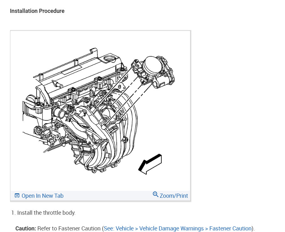

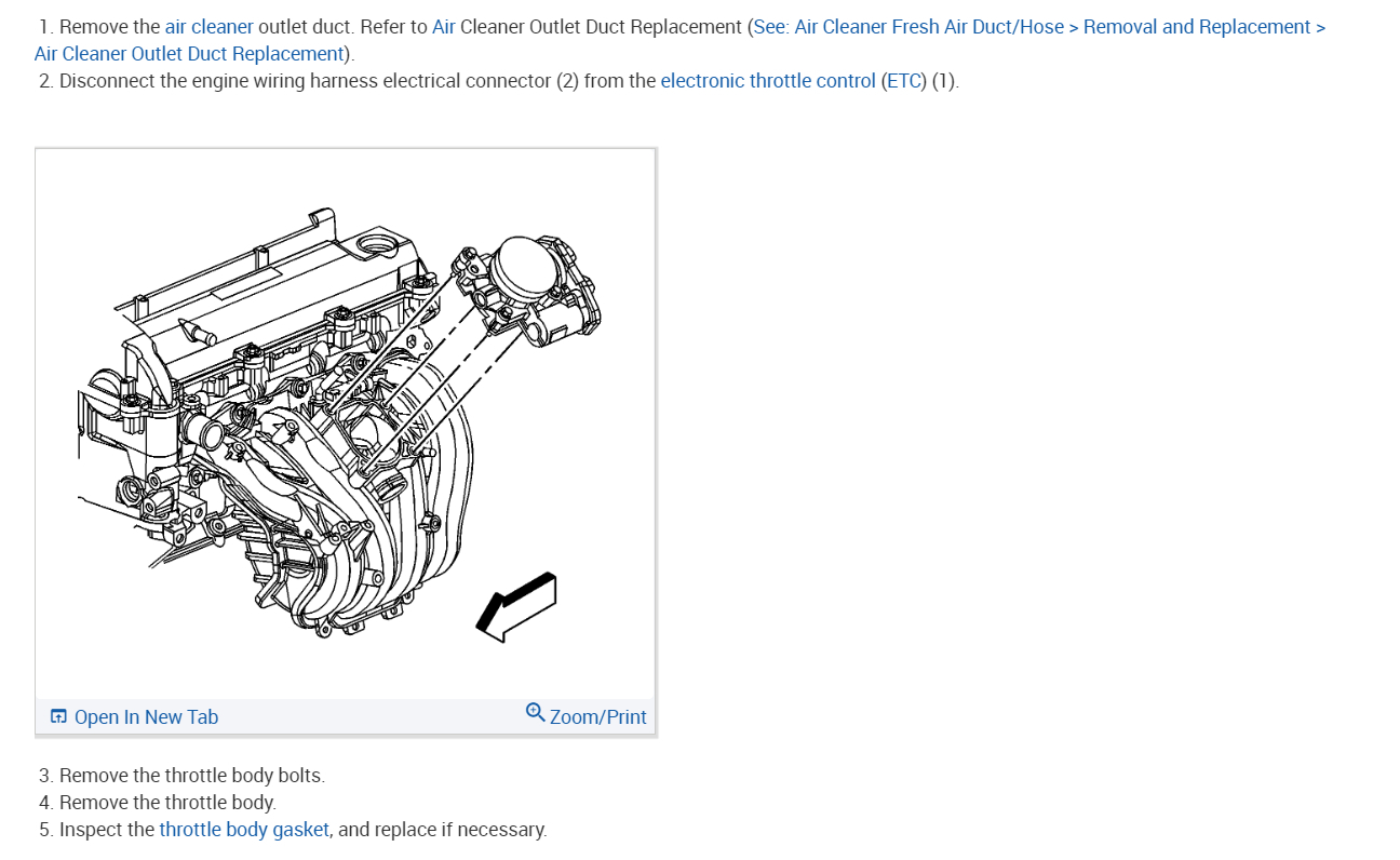

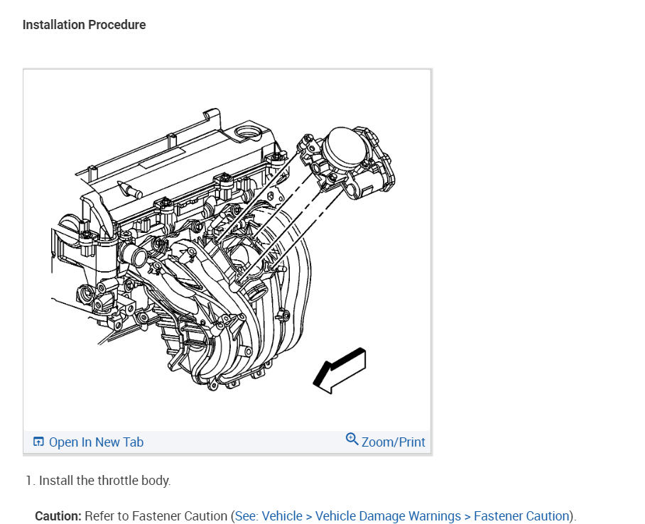

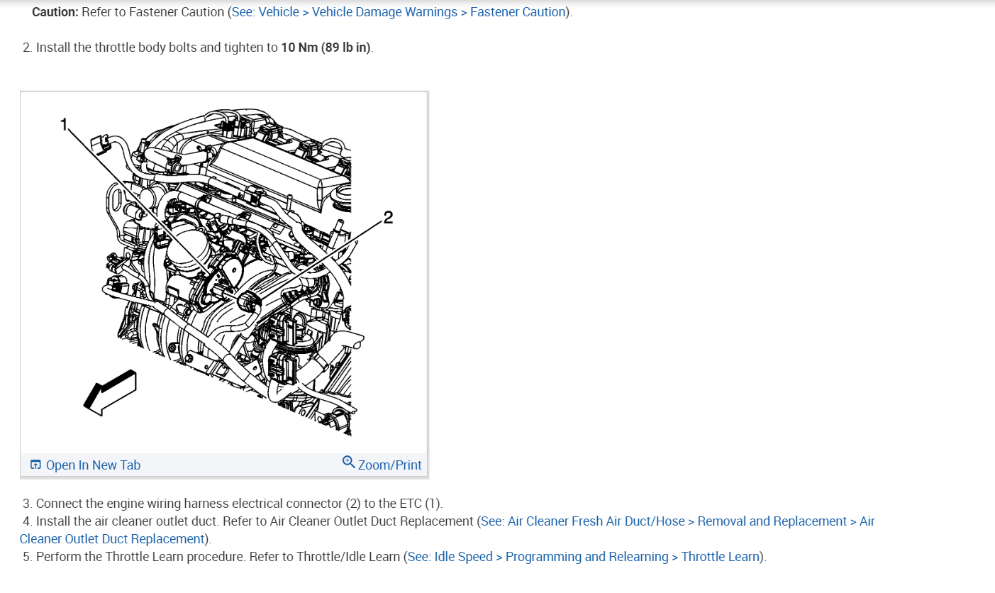

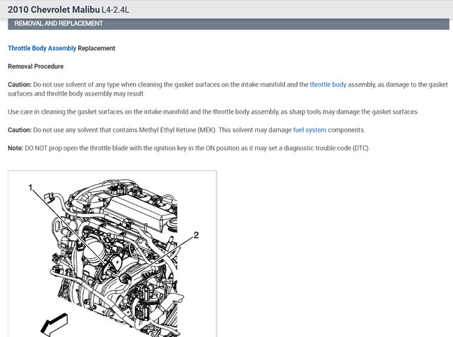

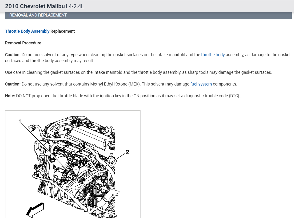

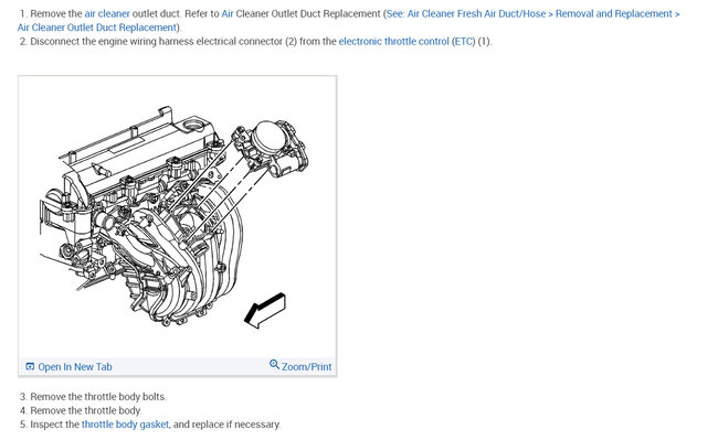

I see, thanks for the clarification, I would disconnect the battery overnight to reset the system here are the instructions on how to change out the throttle body in the images below. Also, you can try a hard reboot which is done by removing the negative side of the battery, with the cable loose from the negative side of the battery, hold it to the positive terminal for 1 minute this will discharge the memory capacitors in the BCM and PCM allowing the system to reboot.

Check out the images (below). Let us know what happens and please upload pictures or videos of the problem.
