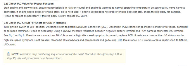

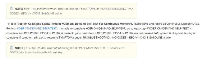

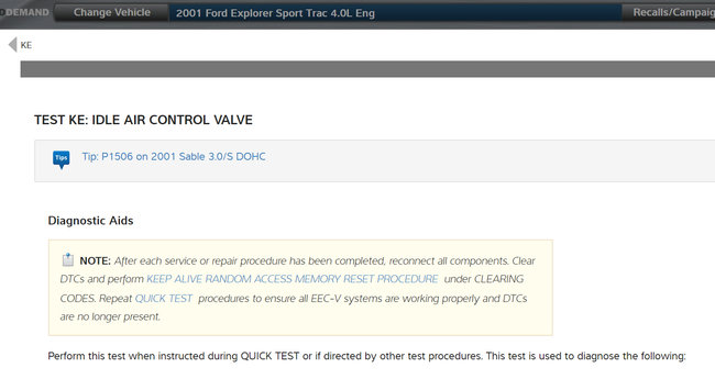

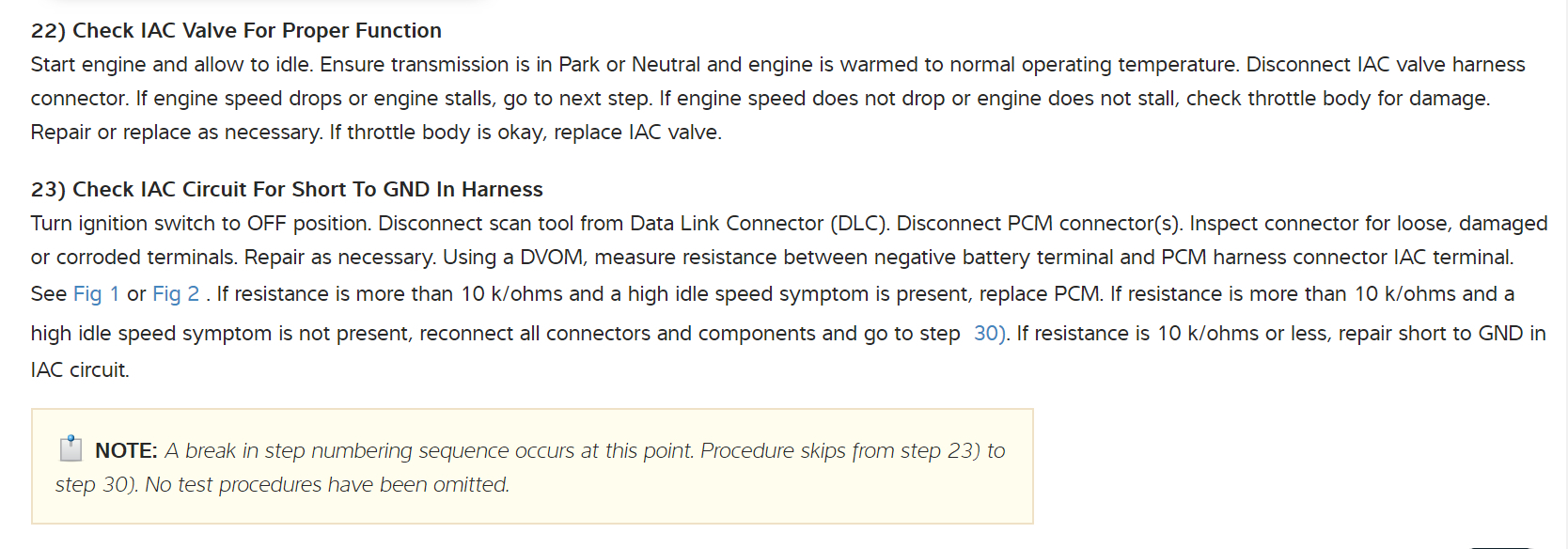

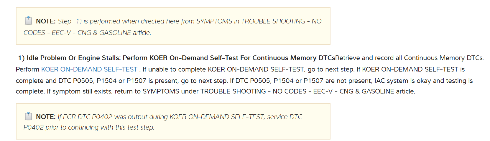

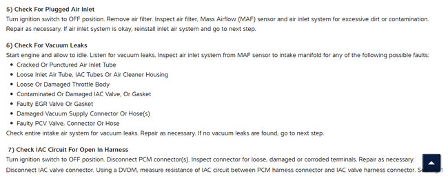

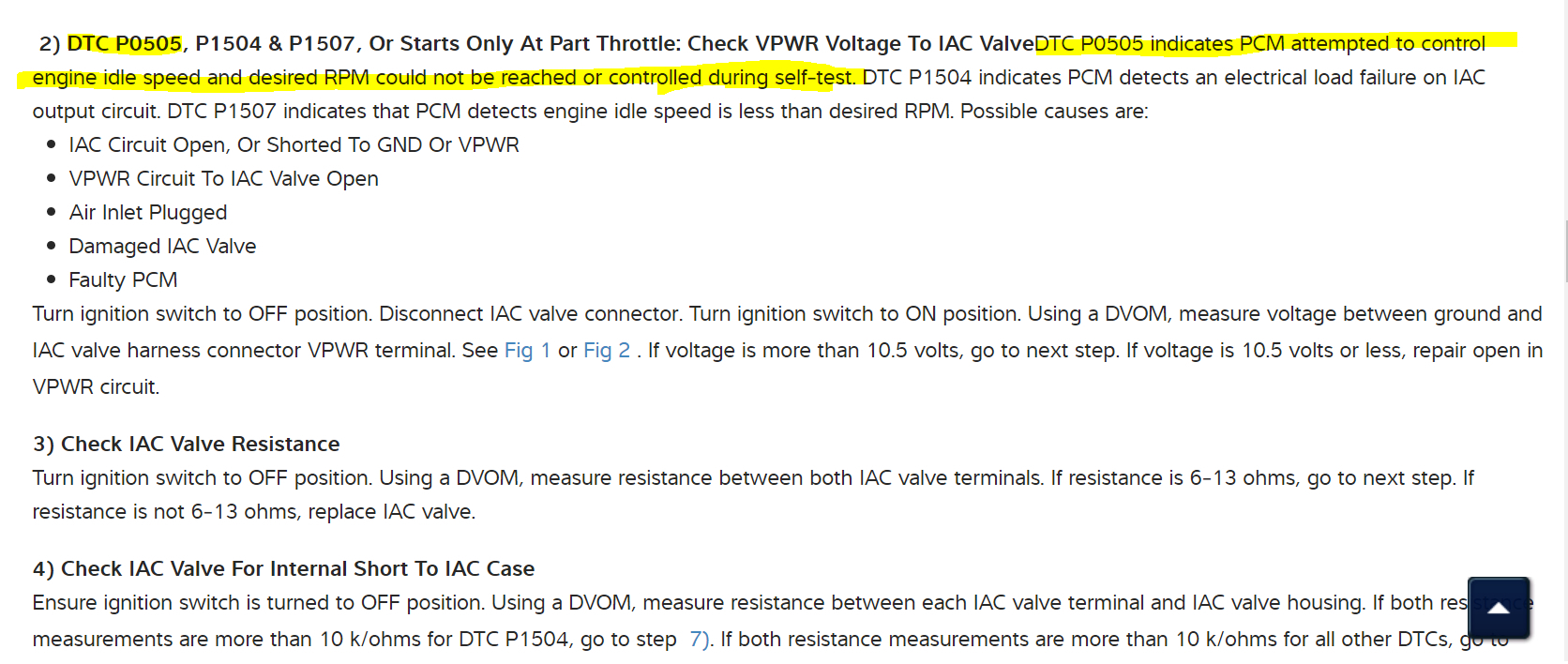

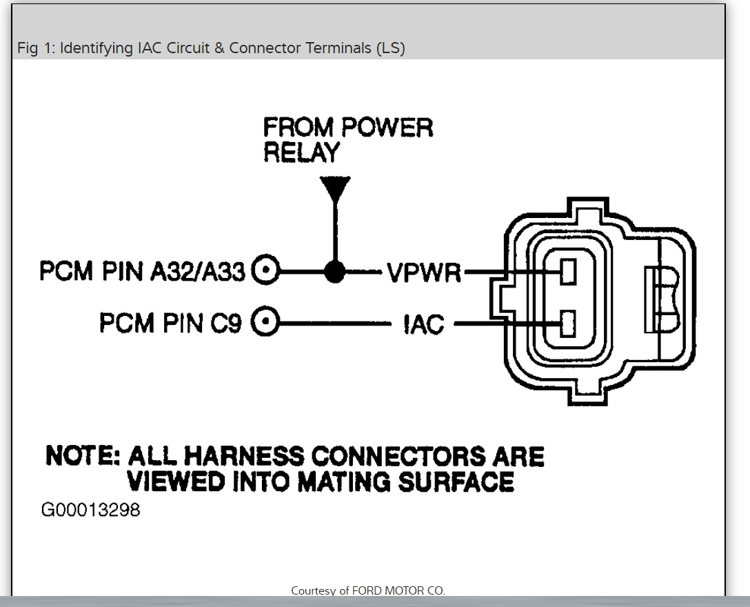

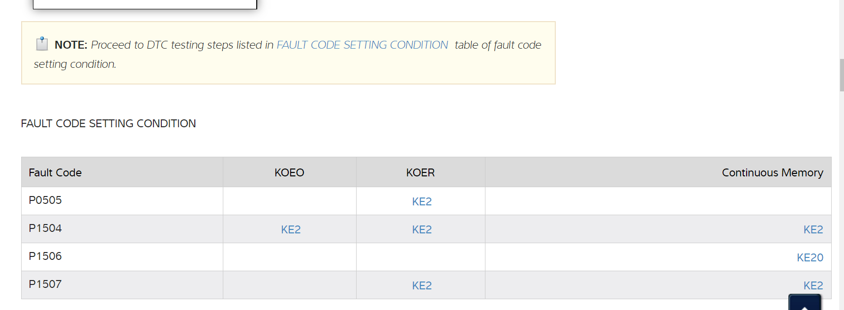

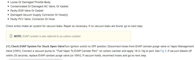

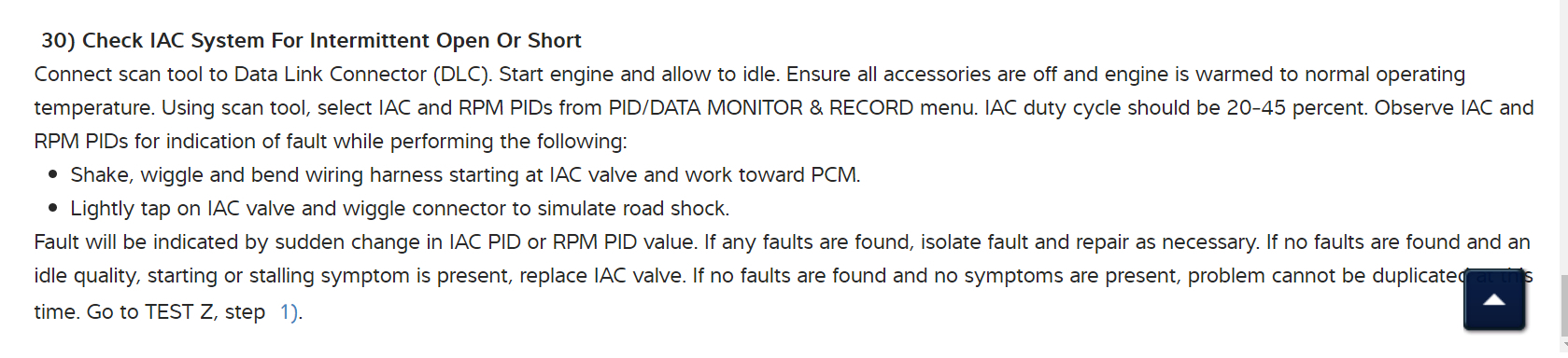

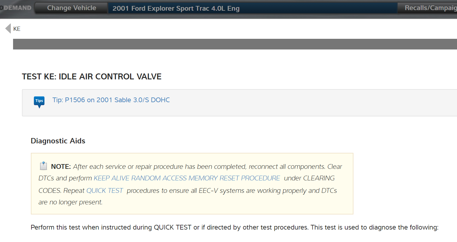

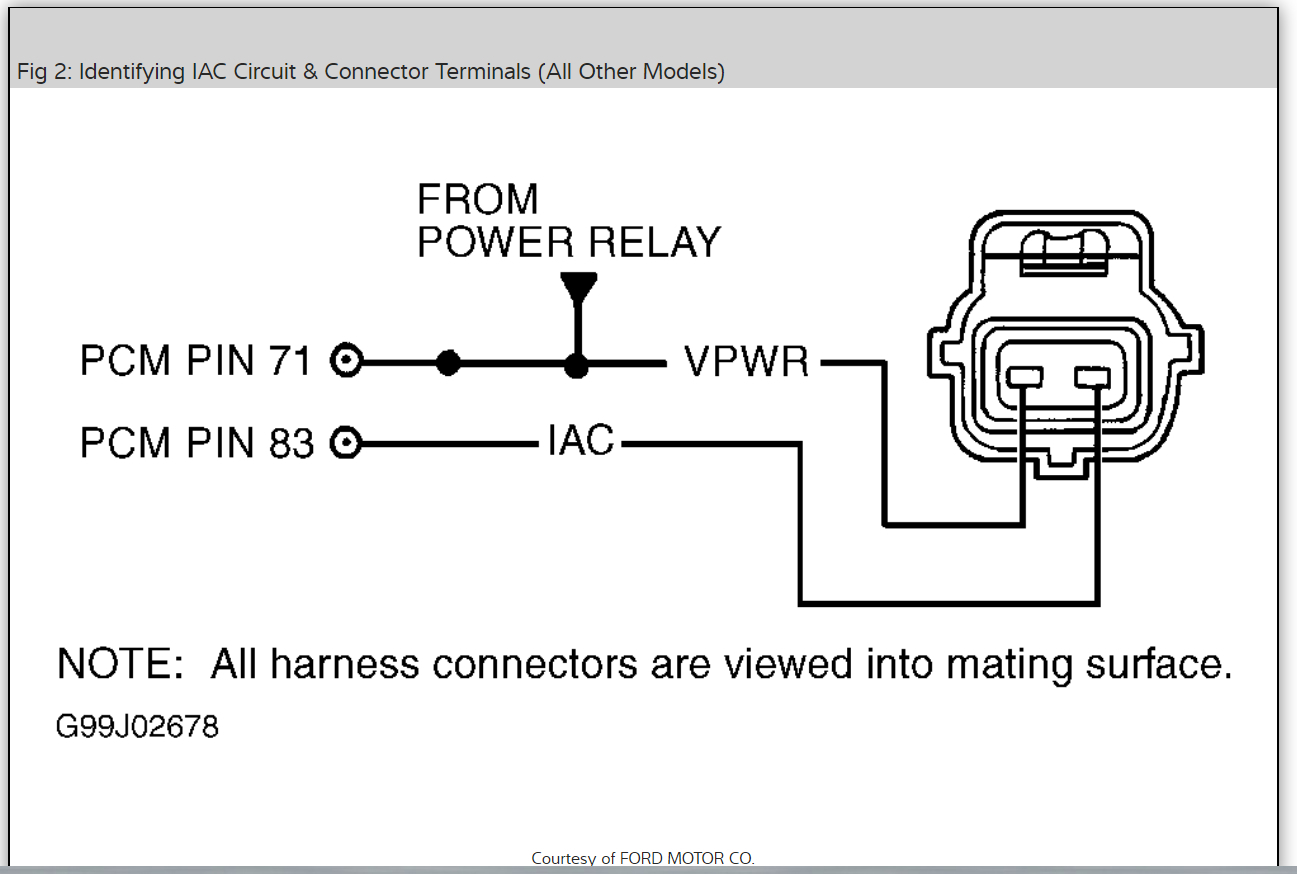

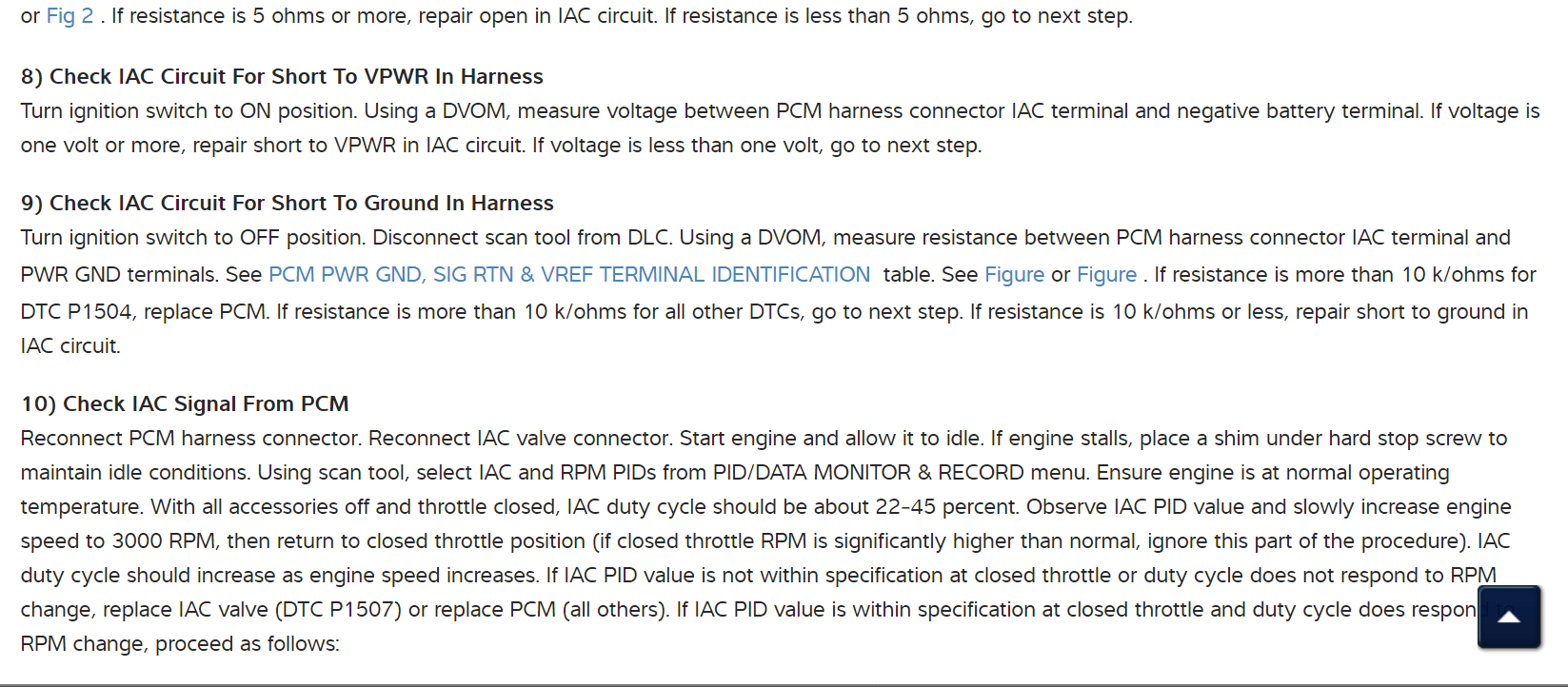

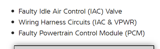

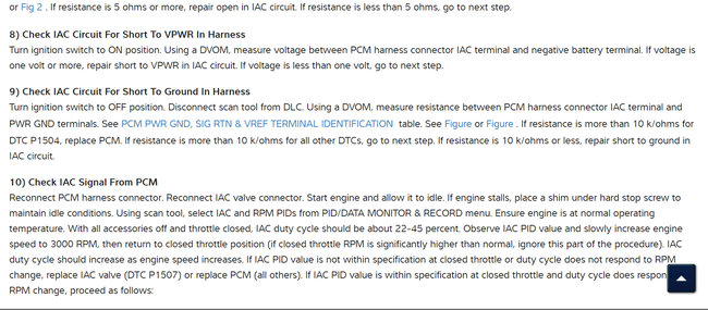

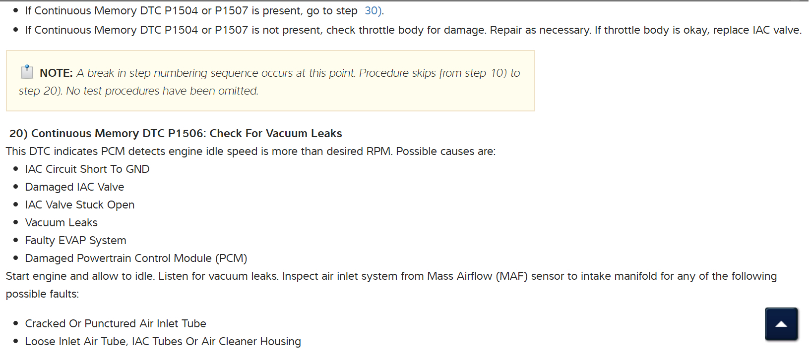

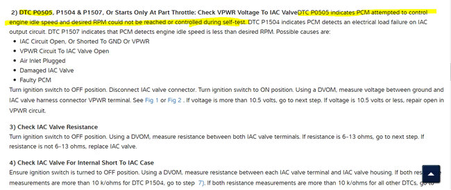

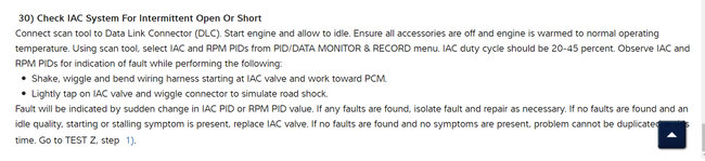

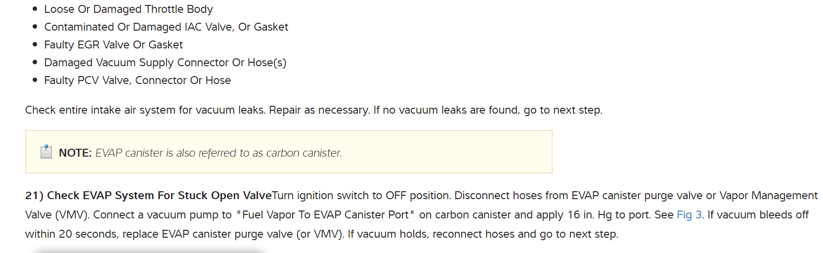

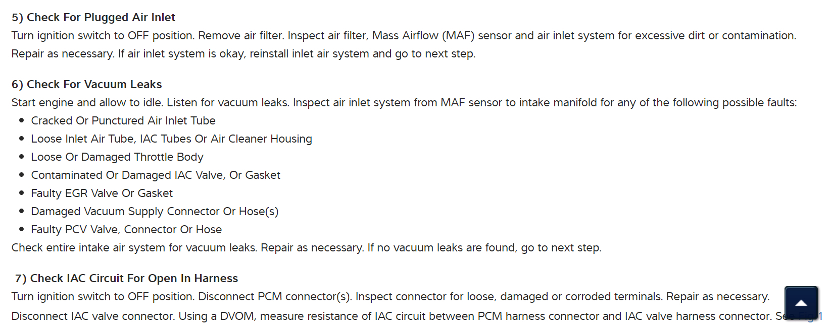

Okay enough of that, I have included for you in the diagrams below, a Diagnostic Troubleshooting Flowchart from the vehicle manufacturer on DTC 0505. You will need a multi-meter and possibly a vacuum pump to perform these tests. You can rent vacuum pumps at your local parts store free of charge. I have included a link below on how to use a multi-meter if needed.
Please go through the flowchart in the diagrams down below and get back to us with what you find out.
