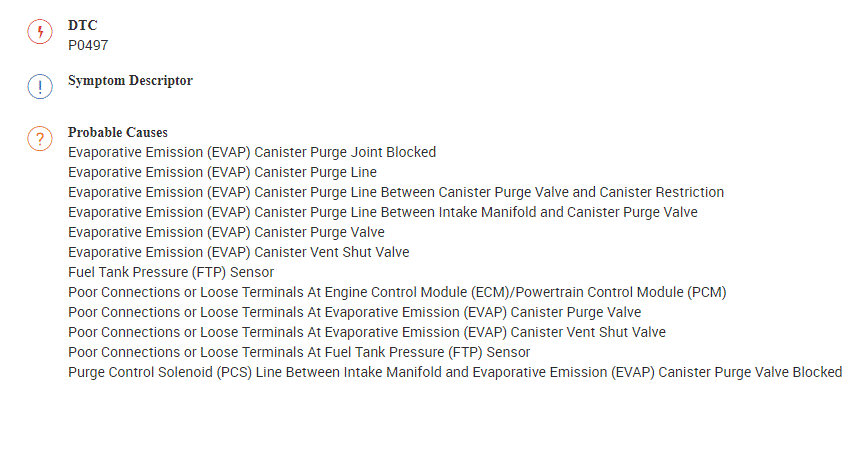

DTC P0497: EVAP System Low Purge Flow

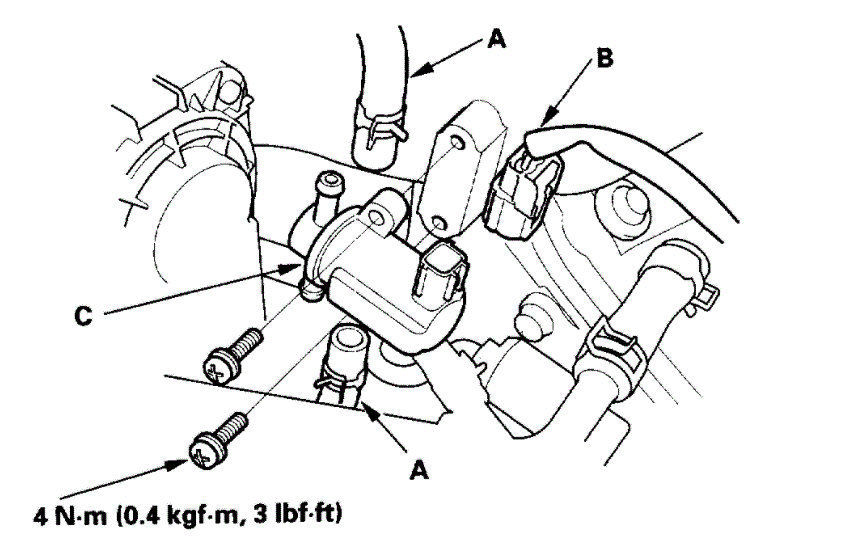

6. Disconnect the vacuum hose (A) from the EVAP canister purge valve joint (B) in the engine compartment, and connect a T-fitting (C) from the vacuum gauge and the vacuum pump/gauge, 0 - 30 in.Hg, to the vacuum hose (A) as shown.

19. Disconnect the vacuum hose (purge line) (A) from the EVAP canister purge valve (B), and connect a T-fitting (C) from the vacuum gauge and the vacuum pump/gauge, 0 - 30 in.Hg, to the hose as shown.
