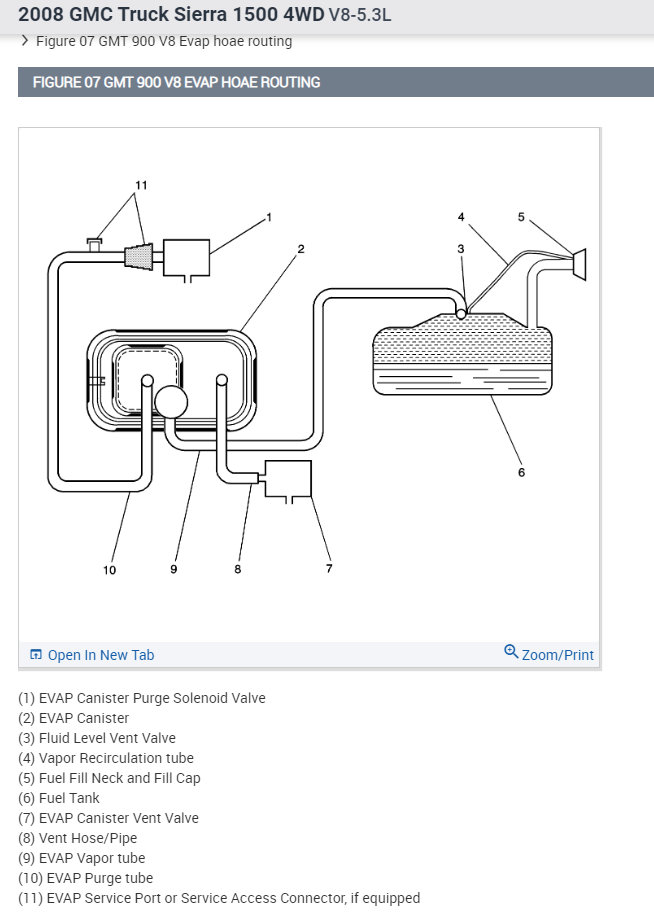

Last year I replaced the evaporative emission control solenoid, and the code was gone and now it's come back. Can you plese send me a diagram of the evaporative emissions system and procedure on diagnosing. thank you

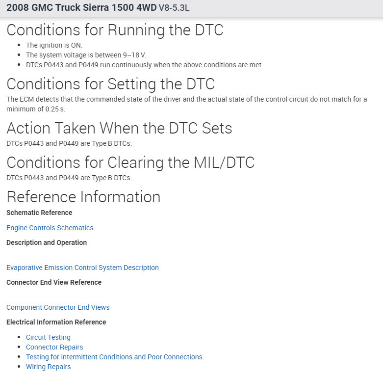

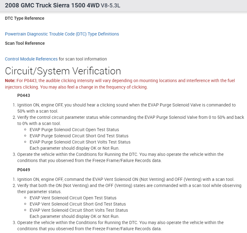

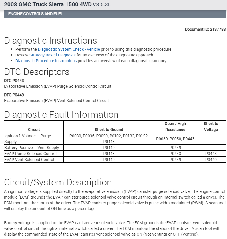

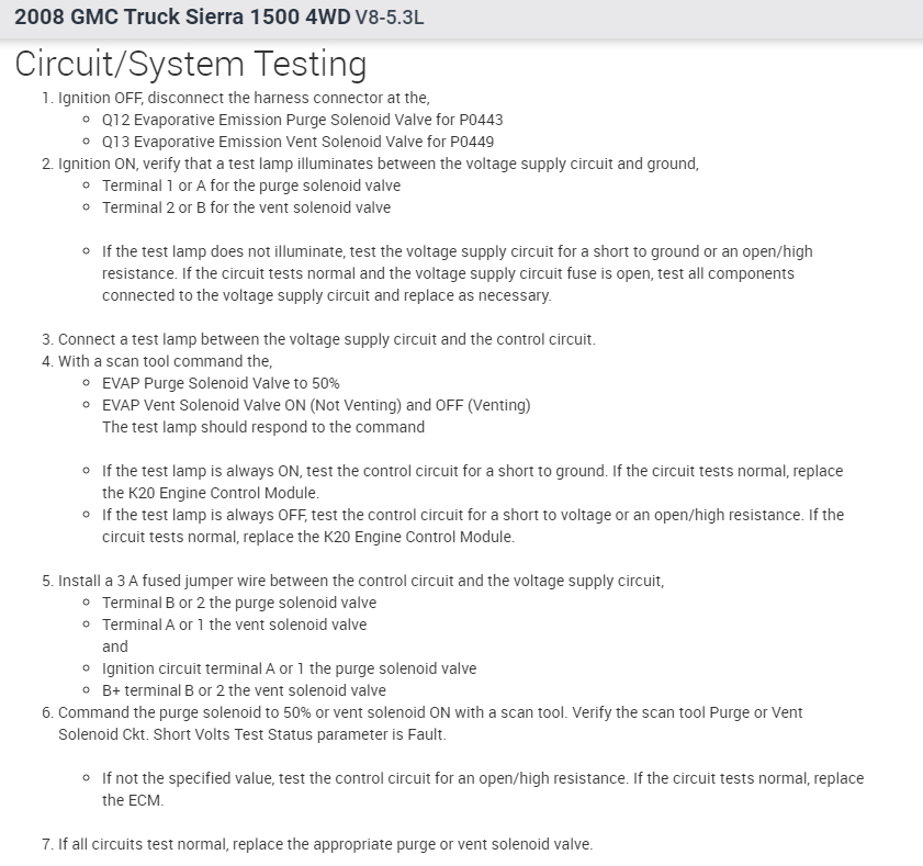

This could be due to an issue with the wiring as well as components.

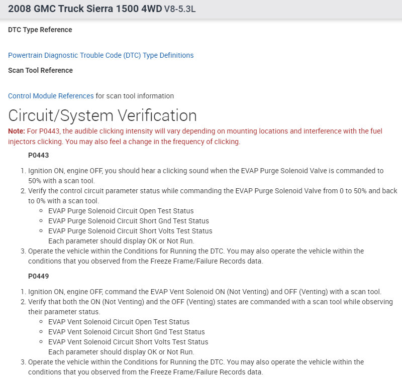

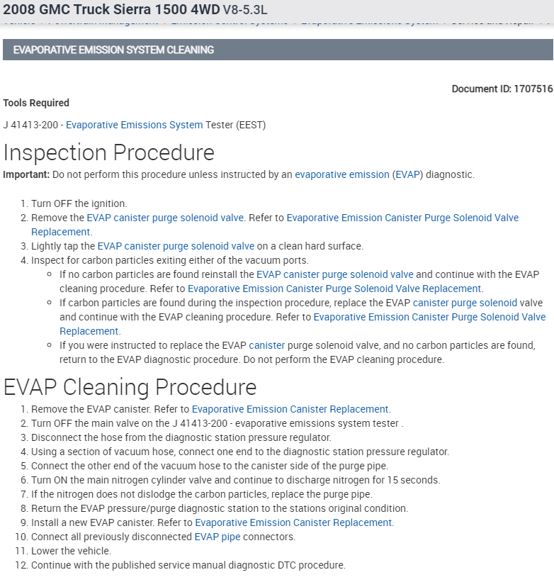

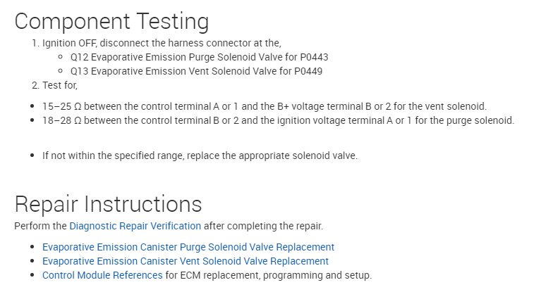

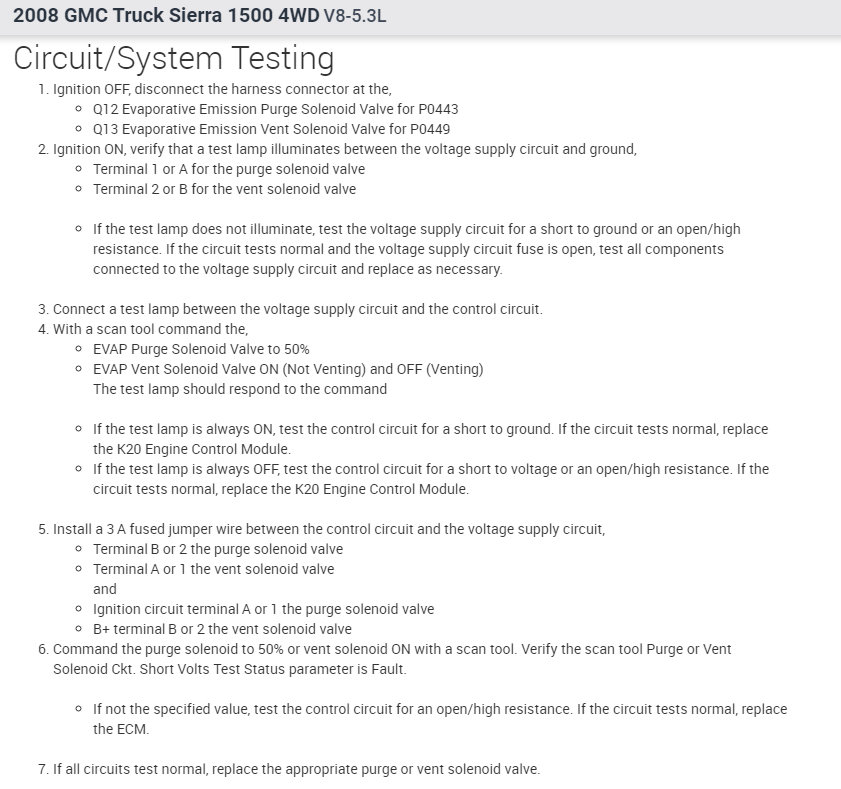

I have attached the diagnostics for the code P0449 below for your reference. Also included is the EVAP hose diagram.
Let me know what you find or if you have any questions.
Thank you.
