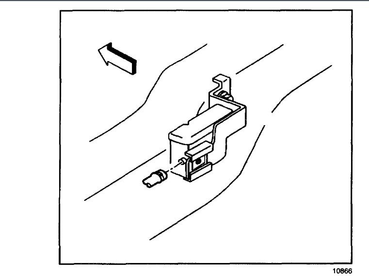

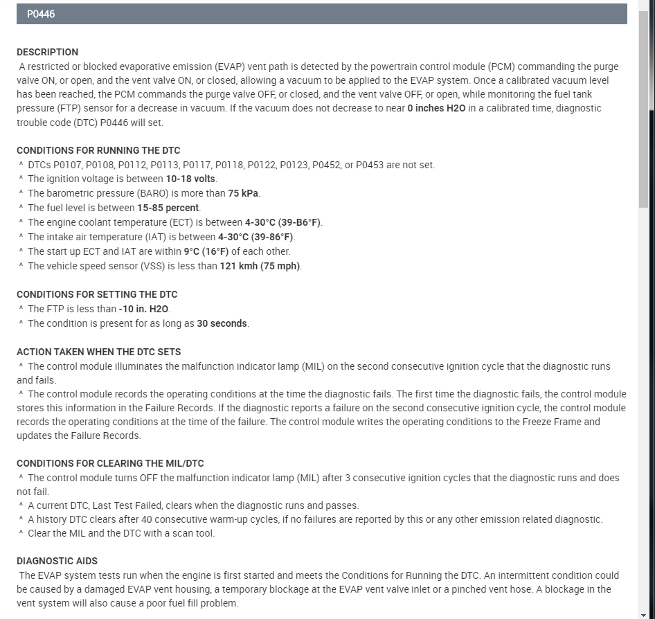

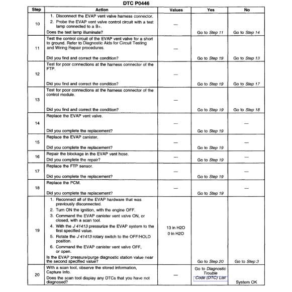

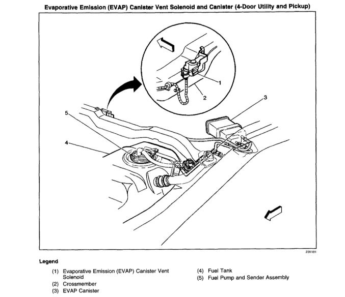

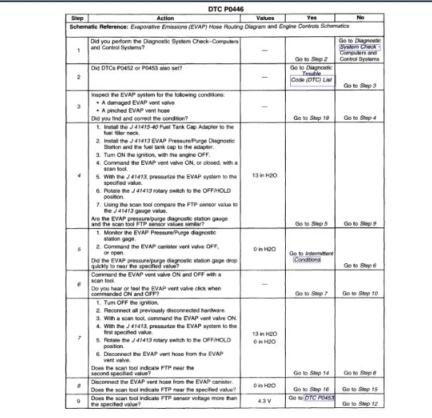

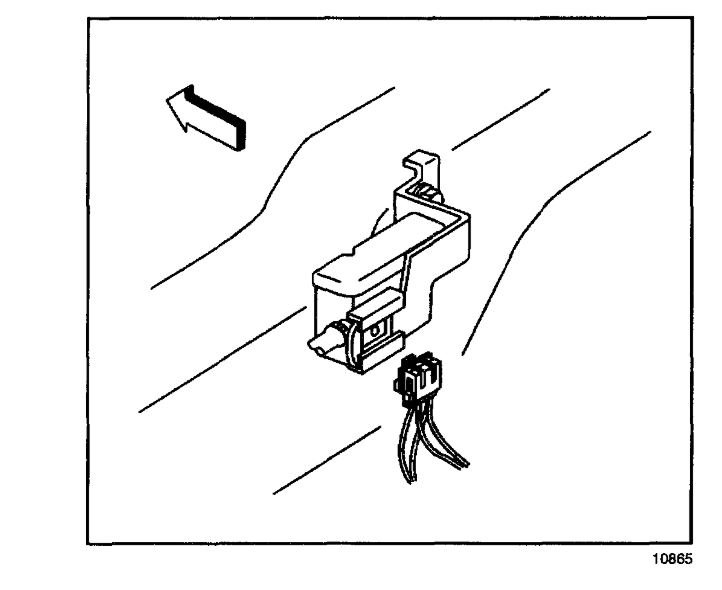

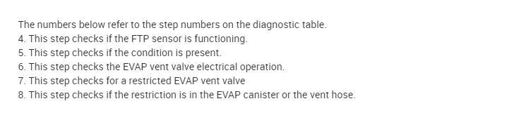

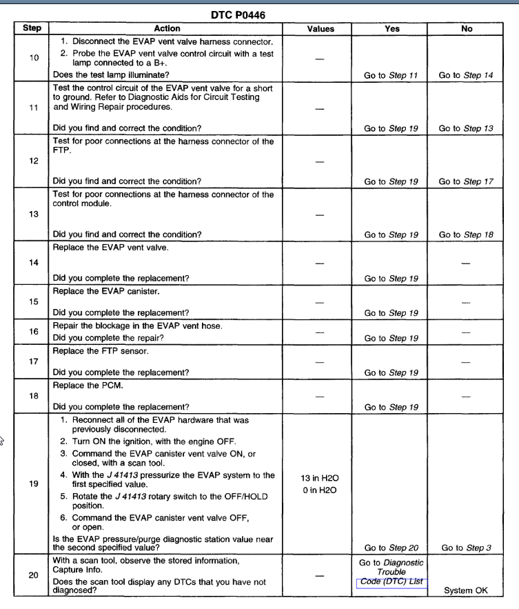

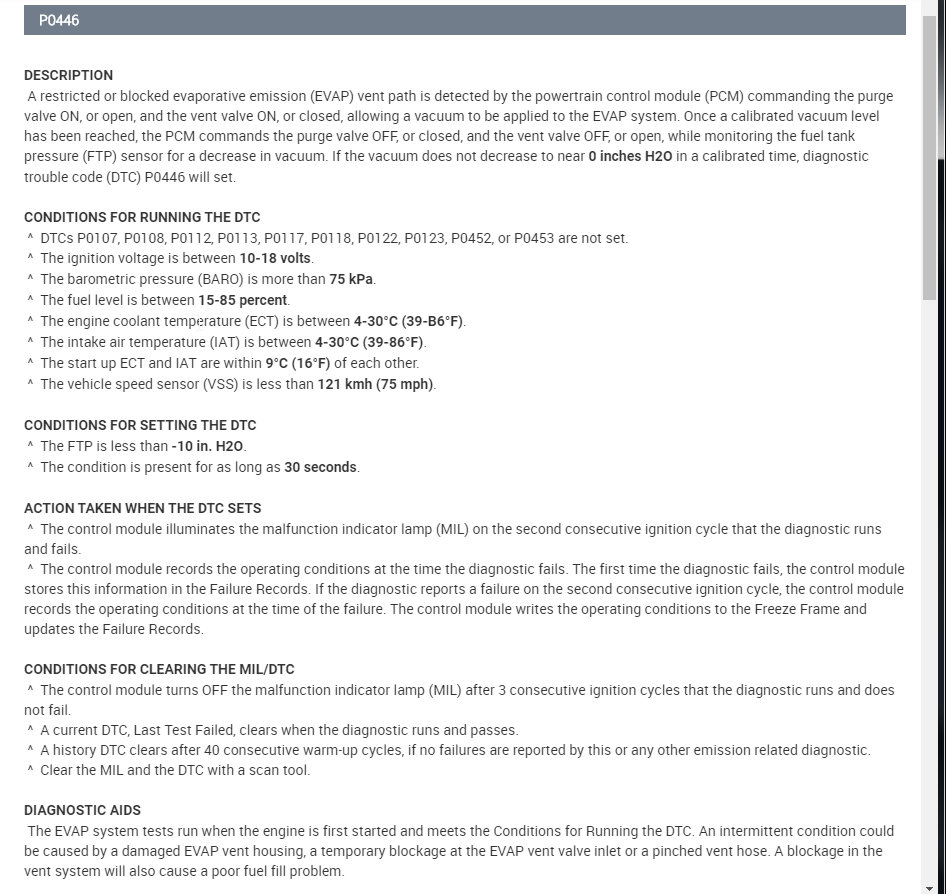

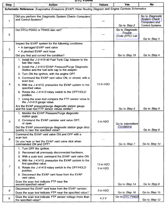

I attached the test for this code. You more than likely have an issue with the purge valve. If you do then you need to make sure the charcoal canister does not have fuel in it. If it does then the charcoal breaks down and get in the valve.
Run through this test and tell us what you find. Thanks
