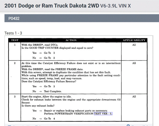

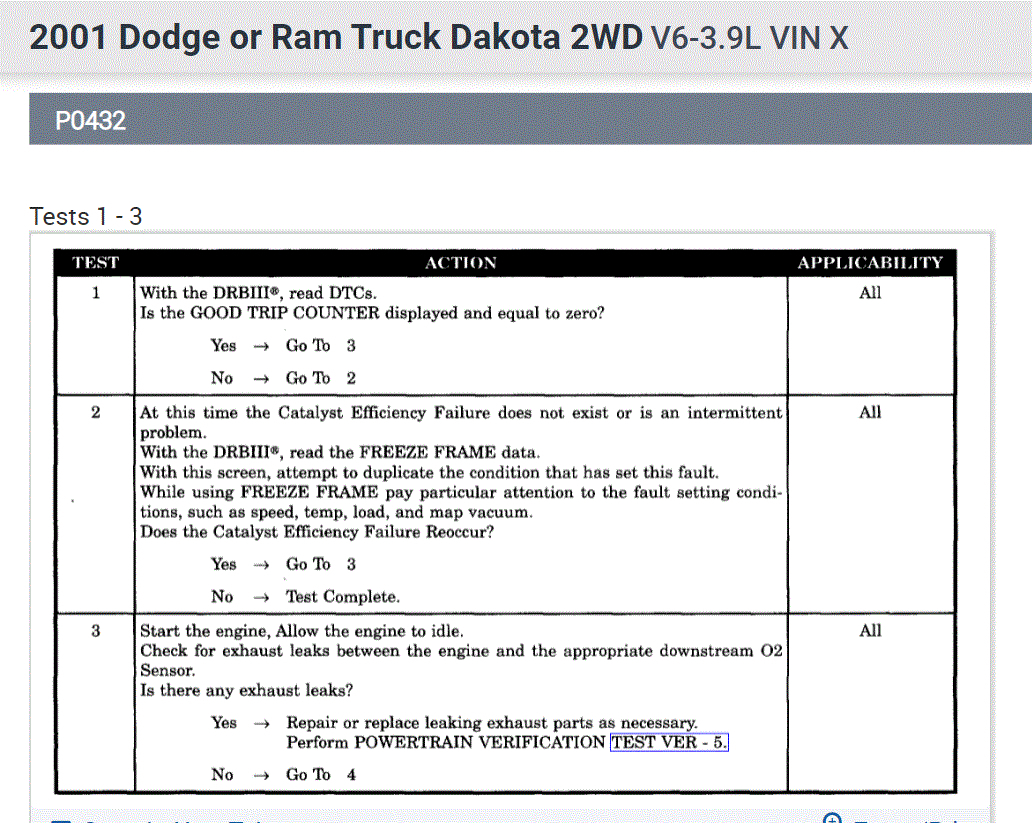

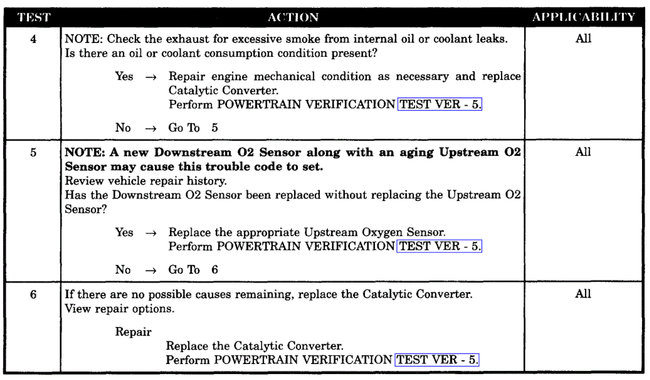

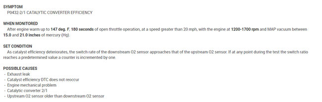

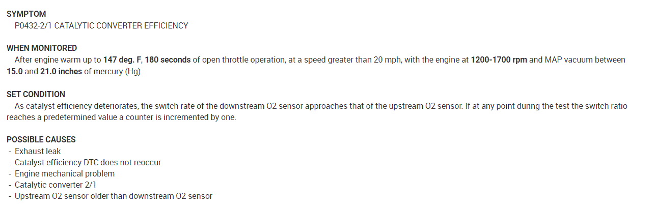

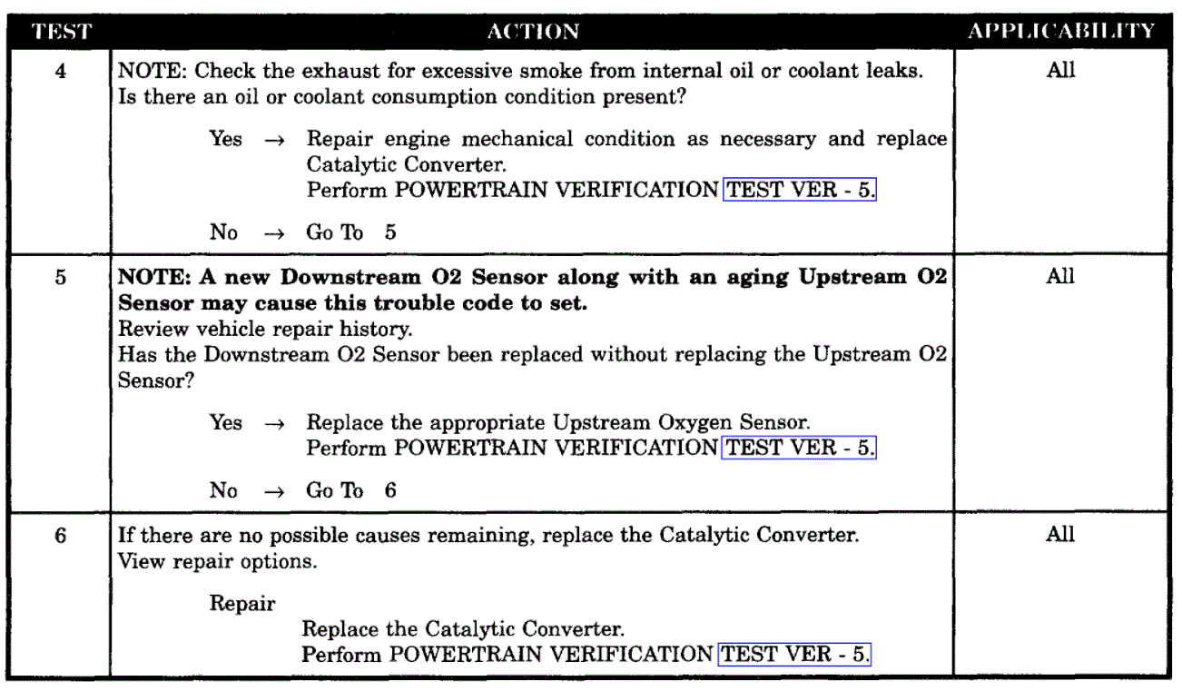

The code indicates the O2 sensor for bank 2 isn't working as it should. In most cases, this is an indication of a failed converter, but there are other things that can cause or lead to it.
I attached the diagnostics below related to the code. Take a look through them and let me know if you are comfortable doing them.
As far as the P2000, that isn't relevant for this vehicle. That is something that would be related to a diesel-powered vehicle. All engines produce NOx gases (nitric oxide).
On a gas engine, the catalytic converter takes care of the issue. A NOx "trap" does it on a diesel engine. It resembles a catalytic converter but is made differently inside.

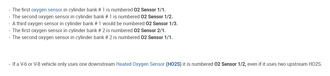

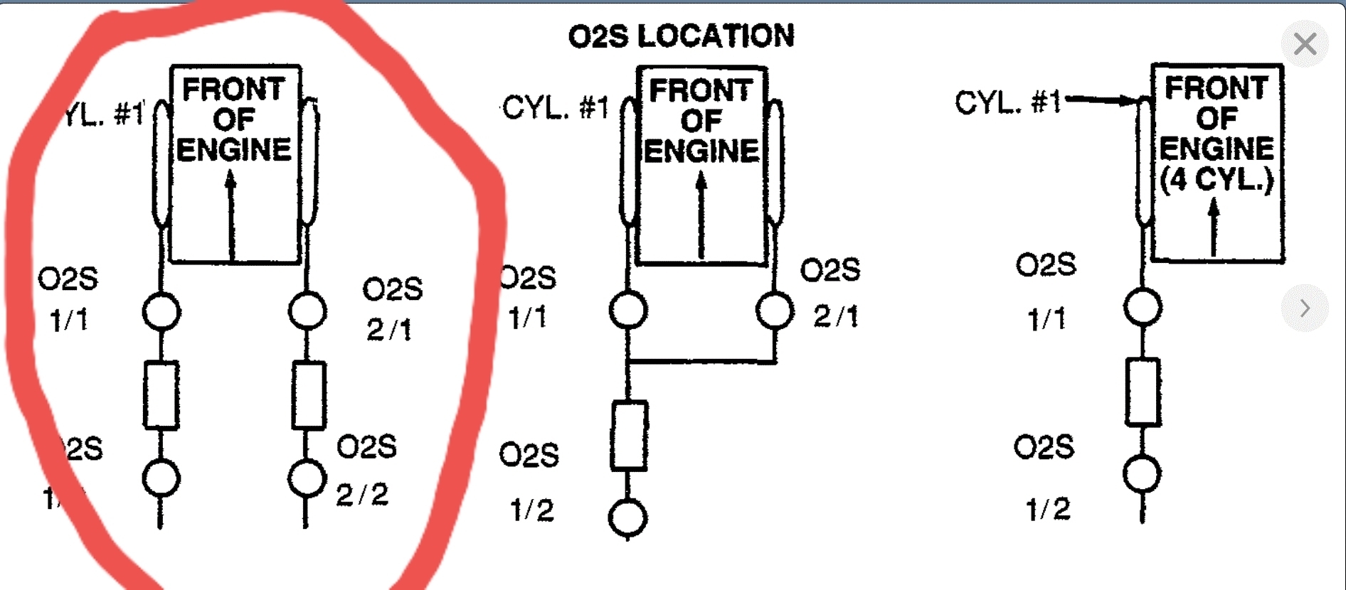

If you look at pic 4 below, I highlighted the sensor.
Oct 24, 2021 at 6:59 PM

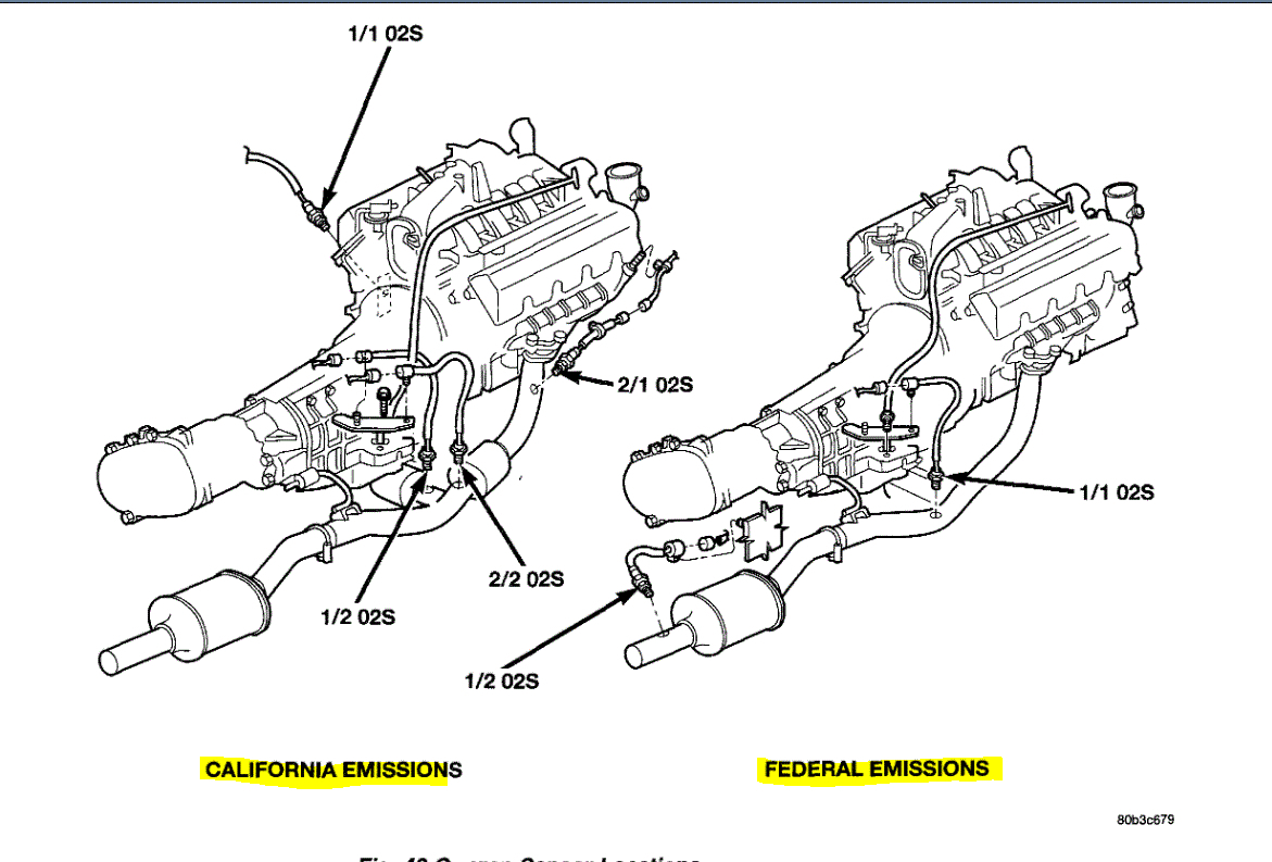

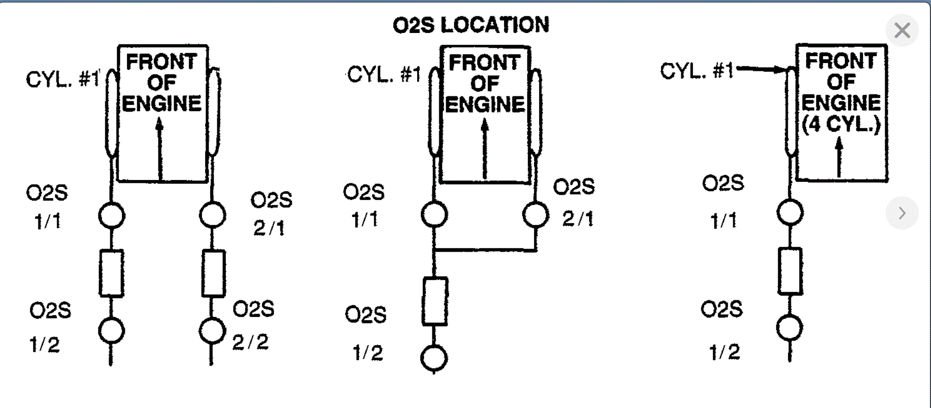

Bank 1 is on the driver's side of the vehicle and bank 2 is on the passenger side.
If you look at the pic below, the sensor locations are different based on how the vehicle was ordered. On the left are the locations for CA emission systems. The one on the right is related to basic Federal emissions systems.
Note that the pics indicate the location and which sensor is at each location.
Let me know if this helps you. Also, let me know if you have other questions.
See pic below.
Oct 25, 2021 at 6:41 PM

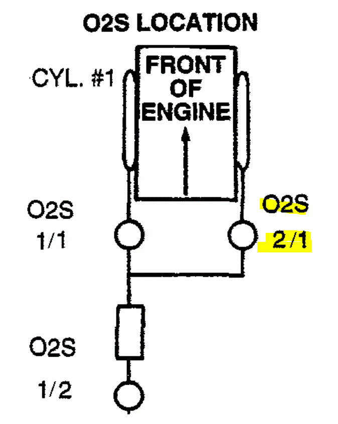

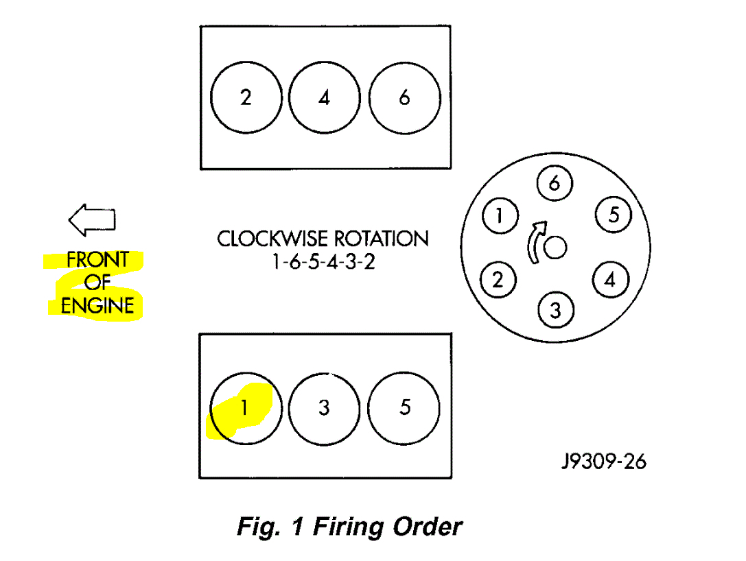

Interestingly, I found more info. Take a look below. The driver's side is bank one for sure. See pic 1.
Pics 2 and 3 show variations of sensor locations and identify the sensor.
See if anything matches your vehicle better.
Oct 25, 2021 at 8:55 PM

Thats interesting. Yes, I have as 1st pic shows with 4 .
But that statement on v6 v8
i dare to challenge.
Mine have as first pic -
2 upstream 2 downstream both before rear cat.

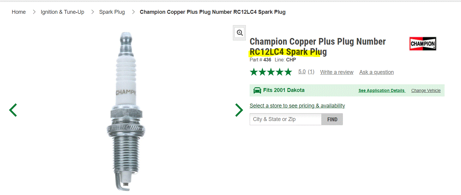

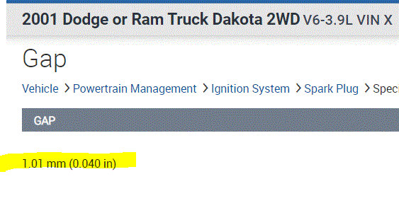

I attached the gap for the spark plugs below. The truck came with Champion brand plugs from the factory. I've never had much luck with them. As a result, I always request NGK plugs and never had an issue.
Pic 2 shows the OEM plug and part number. I got the pic online and had the part number here.
See pics below.
