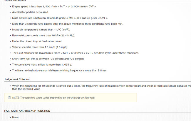

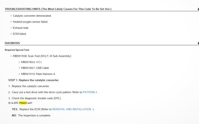

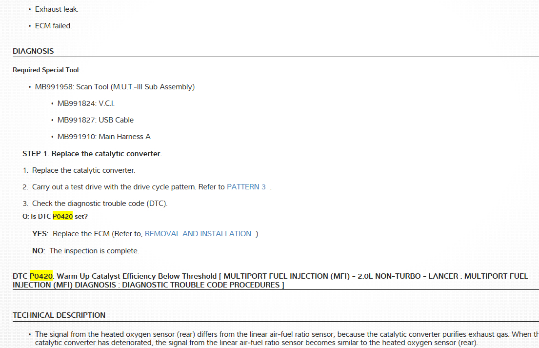

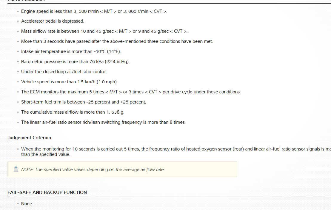

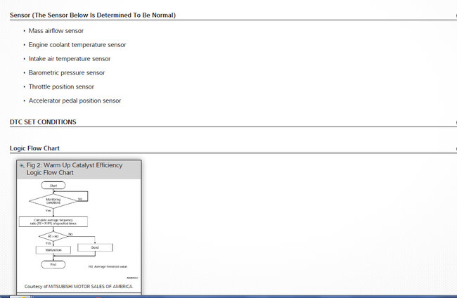

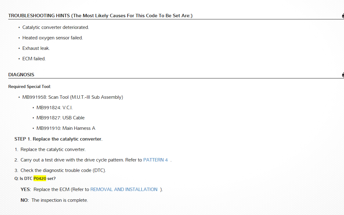

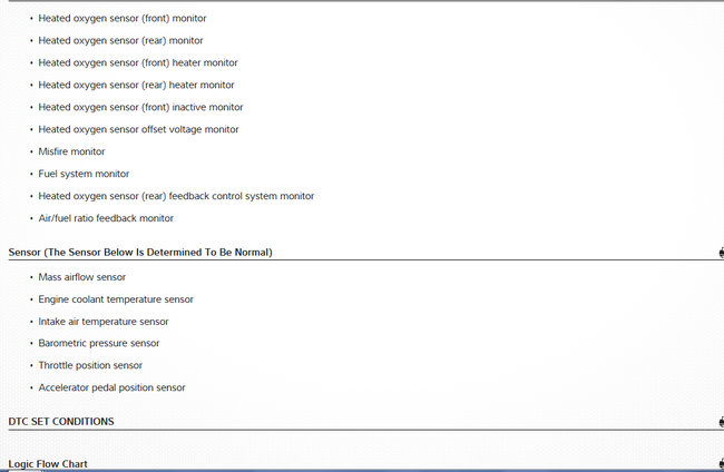

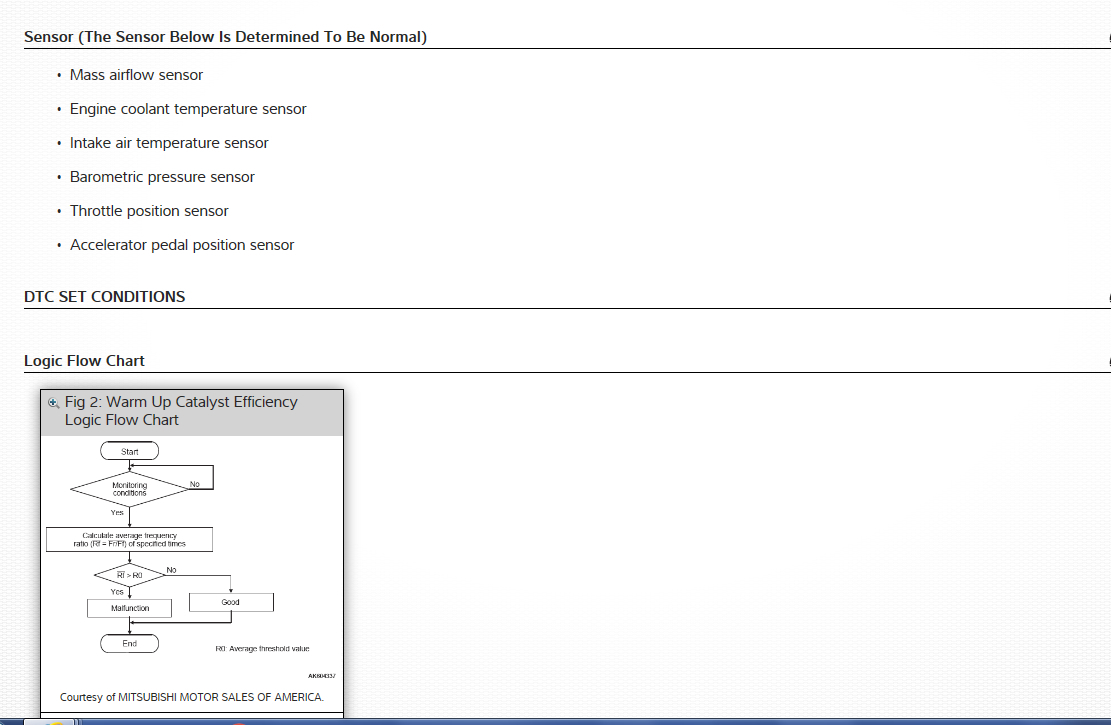

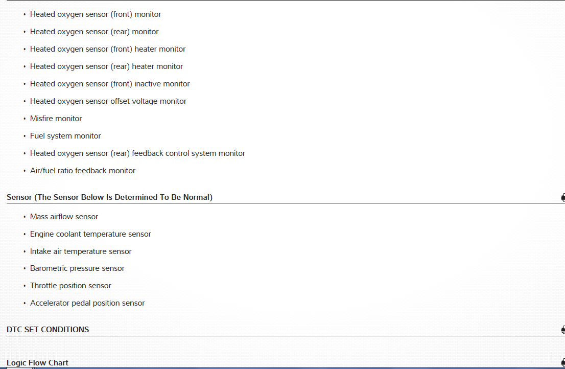

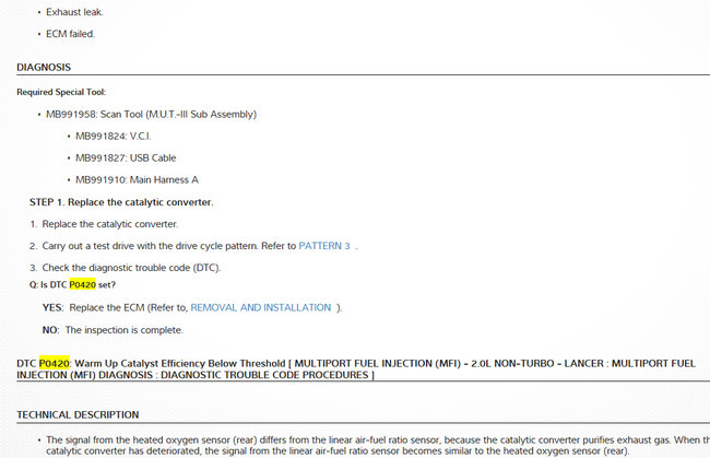

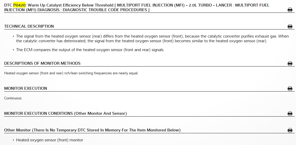

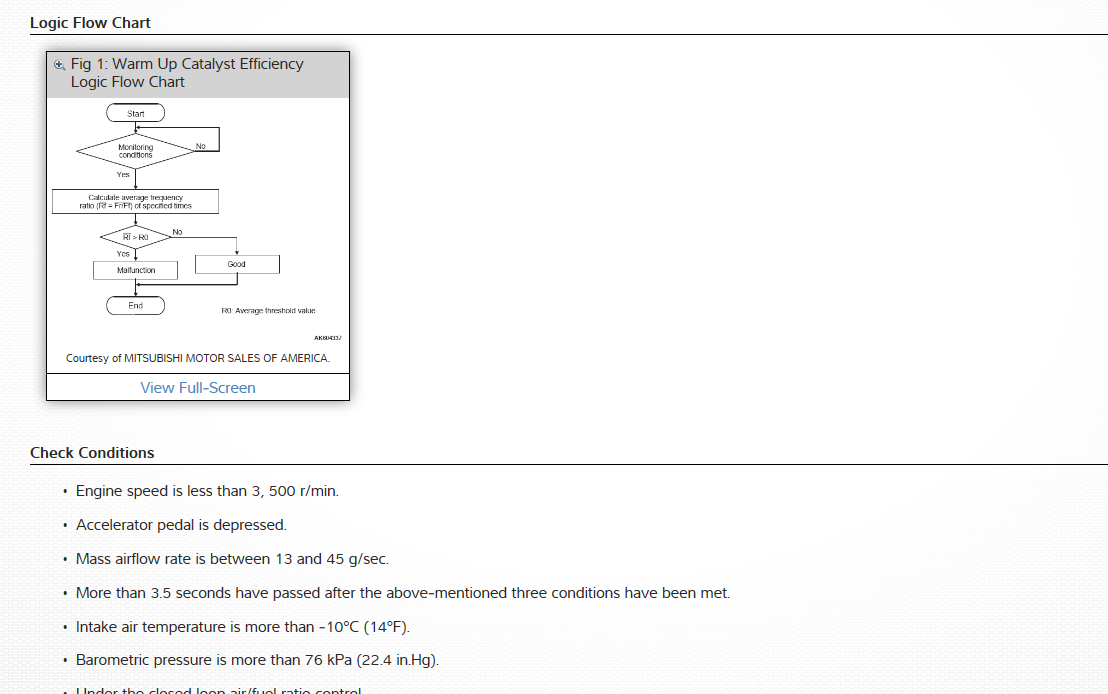

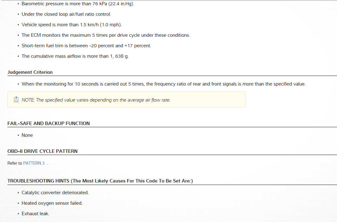

I looked up the code in our online guide. Attached are the notes from said code. Let me know if you need more information. One of the sensors probably needs replacement.

I've seen this code a lot and there are just 2 things that i've ever seen set it
Bad converter 95%
Exhaust leak ahead of the converter 5%
