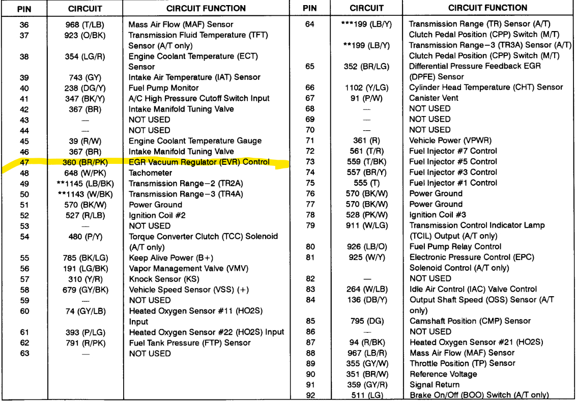

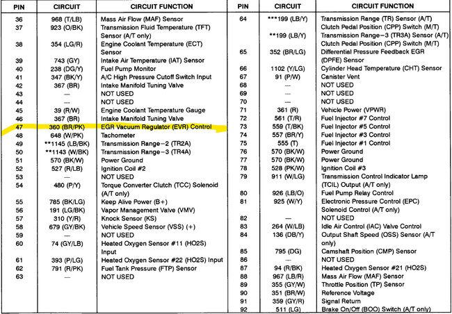

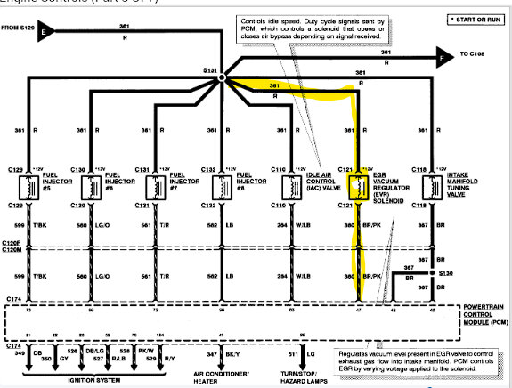

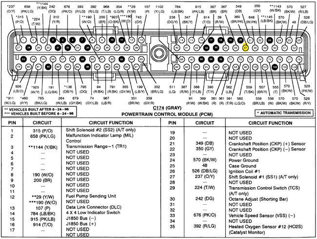

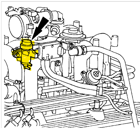

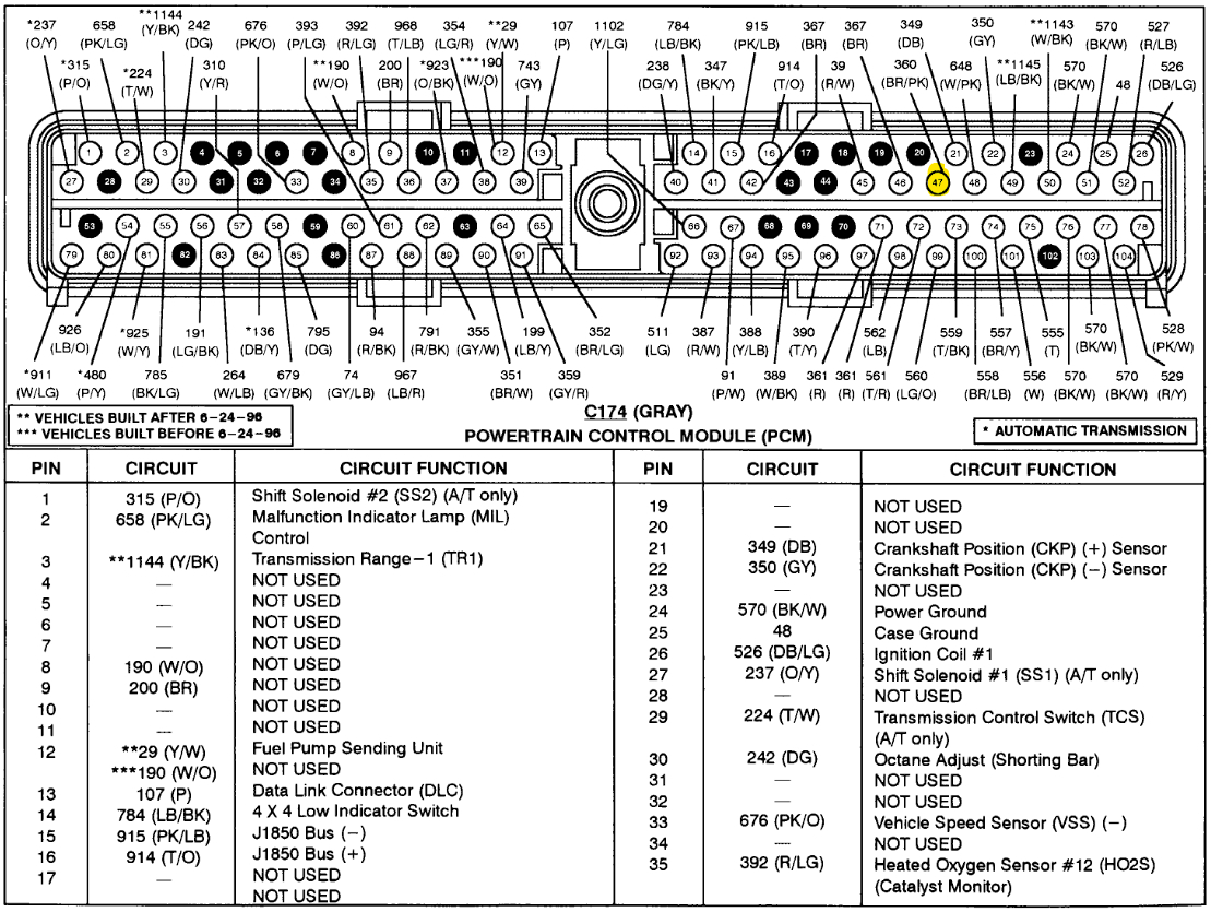

My truck has been giving me problems with this code. It’s an EGR valve. I changed out the part it says. I cleaned out the throttle body to make sure nothing is clogged, and the code still comes up. I deleted the code, and it came back. I changed the DPFE sensor, and it did nothing. I’m trying to get rid of my check engine light so I can smog my truck.
